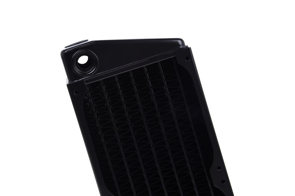

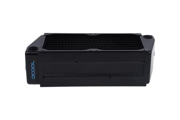

Perfect for workstations and servers
The 80 mm NexXxoS radiators are specially designed for server racks and workstations. Due to their low height of only 80 mm and the special M3 mounting holes on the top and bottom, they’re perfect for 1U server racks. Alternatively, the radiators can also be mounted in the classic way using the mounting locations of the fans. M3 screws are also required here.
No compromise on materials
Alphacool always uses copper in its NexXxoS radiators. Alphacool is the only manufacturer that uses pure copper for all water-bearing components. Starting with the end chambers, the water channels and the cooling fins, everything is made of pure copper. Only the connecting threads are made of brass, as pure copper would be too soft for the threads and would give way over time.
Outstanding cooling capacity
There are several approaches that Alphacool uses to increase the cooling capacity. Using copper ensures the best properties to dissipate the heat. Aluminium, which is often used in low-cost products, is not as good as copper in terms of heat capacity and thermal conductivity.
Compared to some other manufacturers, the copper fins are only thinly painted. This means that the cooling performance isn’t affected at all unlike a thick coating of paint which would act as a insulator. The fin spacing is 10 FPI for optimal performance. This means that the fins are close enough together to create a large surface, but also far enough apart not to obstruct the air flow. In addition, all fins are designed to provide controlled air turbulence. This means that the air flowing through the fins is more efficient and is directed exactly where it is needed.

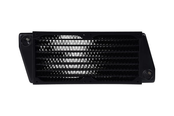

X-Flow instead of U-Flow
The water flow in classic PC radiators is U-shaped. This means that the water inlet and outlet are on the same side on the radiator. This has certain advantages in the normal PC, however, it is difficult to set up a reasonable cooling loop like this in an extremely flat server. Due to the X-Flow technology, the input and output are located on the opposite sides. This makes it very easy to create a loop in the server rack. For example, you could go out from one side, directly into a CPU, then into one or more graphics cards and the pump, then back to the radiator on the other side.

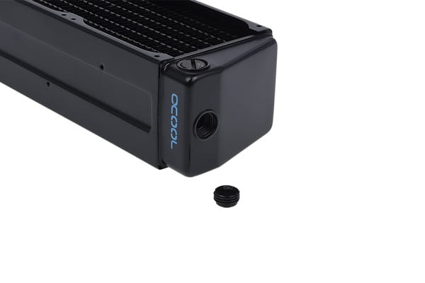

Versatile connection options
Each NexXxoS 80 mm X-Flow radiator has 3 ports on each end of the radiator. This means that almost any conceivable mounting position can be achieved. The connections are located on each side in the opposite position and then one at the head ends of the radiators.
Alphacool has developed special patented stop plugs that are flush with the radiator to avoid them fouling the case. Previous solutions always exceeded the length or width of the radiator because they were not countersunk.

Technical data radiator
L x W x H203.5 x 60 x 80 mm (±3 % tolerance in the range of the prechamber)
Quantity of cooling channels21
Material threadsbrass
Threads6x G 1/4 IN/OUT (max. 5 mm thread length)
Possible fan size80 mm
Possible fan assembly2x one-sided / 4x both-sided
Thread size fan mountingM3
Pressure tested0.8 bar
Fin density10 FPI
Weight674 g
