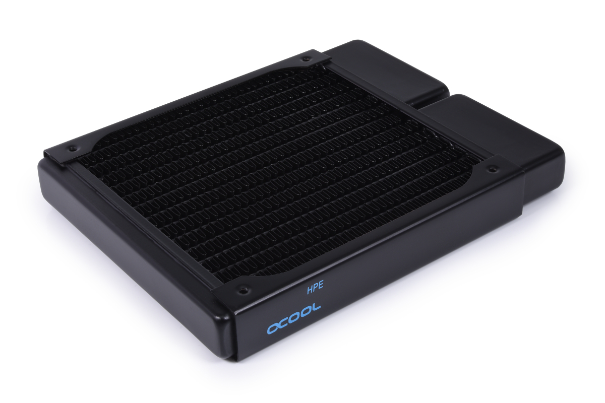

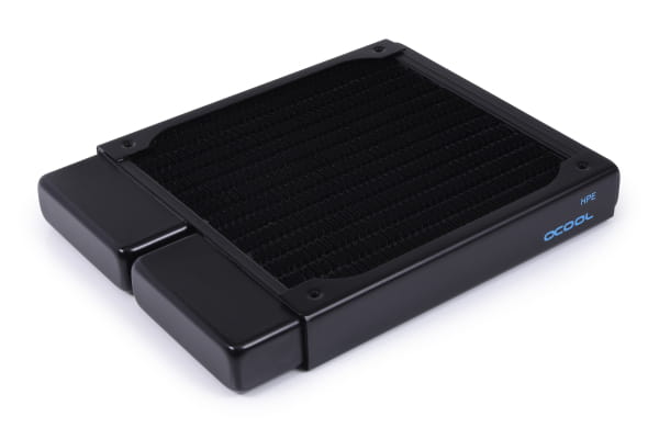

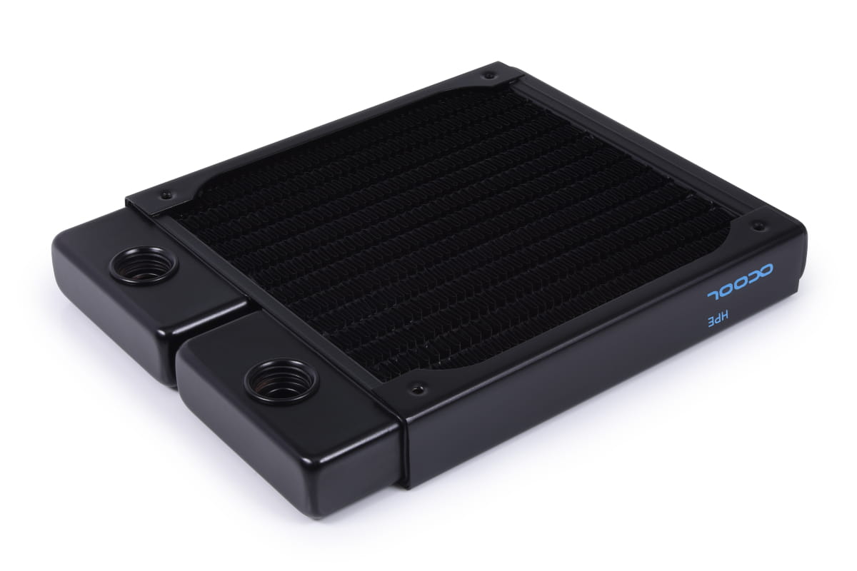

For more than a decade, Alphacool has dominated the market with the NexXxoS Full Copper radiator... more
For more than a decade, Alphacool has dominated the market with the NexXxoS Full Copper radiator series. Our extensive portfolio of radiator variants is unique in the world. Just like our manufacturing process, which allows us to produce all water-carrying parts and the cooling fins out of pure copper. As a result, the NexXxoS series offers the highest thermal conductivity of any radiator on the market. Thanks to their exceptional performance, the radiators can easily dissipate even extremely high waste heat and have become essential in many areas of the cooling industry.
The next step in evolution: NexXxoS HPE Full Copper Radiator!
The NexXxos Full Copper HPE Radiator uses the same materials as previous NexXxos models, but takes it a step further technically. Due to the condensed internal structure, the number of water channels and copper fins could be increased. Thus, a larger volume of water is in direct contact with the cooling fins and the heat transfer is enormously improved. The higher number of fin rows and their shortening also makes much more efficient use of the cooling surface. Comparison tests with the conventional NexXxos radiator have shown that a performance increase of 4.5K is possible when using the HPE radiator. At higher ambient temperatures and higher fan speeds, the performance gap with the normal NexXxoS radiators even increases progressively, reaching a possible performance increase of up to 6K.
Space-saving & flexible to use
The compact slim radiators can be mounted very flexibly in even the tightest cases thanks to their low overall height of only 20mm.
Connection options & mounting

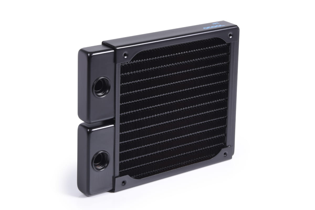

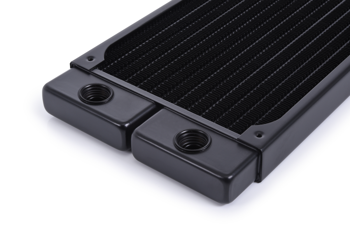

The NexXxoS HPE radiator has one IN and OUT connection with G1/4" threads in the pre-chamber area. All screws for mounting in the case and for mounting the fans are included with the radiator. Additional screws are not usually required.
Technical data radiator
L x W x H150 x 120 x 20 mm
Material threadsbrass
Threads2x G 1/4 IN/OUT (max. 5 mm thread length)
Possible fan size120 mm
Possible fan assembly1x one-sided / 2x both-sided
Thread size fan mountingM3
Pressure tested0.8 bar
Fin density19 FPI
Weight290 g
Warranty: 10 years
