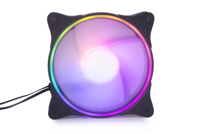

Fan
The Alphacool Rise Aurora fan offers a wide control range as well as superior Digital aRGB LED lighting. The individually controllable 5V aRGB LEDs paired with the fan's special design create unique effects. The fan can be controlled from 0 to 2500 rpm via the 4-pin PWM connector. Additionally, it offers a Zero control, which allows the fan to be regulated down to 0 RPM and then starts at approximately 350 RPM. At 800 rpm, the fan is nearly silent, but still offers good airflow (118.9 m³/h) paired with high static pressure (3.17mm/H₂O).

Technical data fans
L x W x H120 x 120 x 25 mm
Speed0-2500 rpm (±10 %)
BearingSleeve Bearing
Connection4-Pin PWM
Cable length40 cm
Voltage12 V DC
Current consumption0.65 A (0.72 max)
Static pressure3.17 mmH₂O
Max. air flow118.9 m³/h
Noisemax. 31.5 dB(A)
Number of digital aRGB LEDs20
