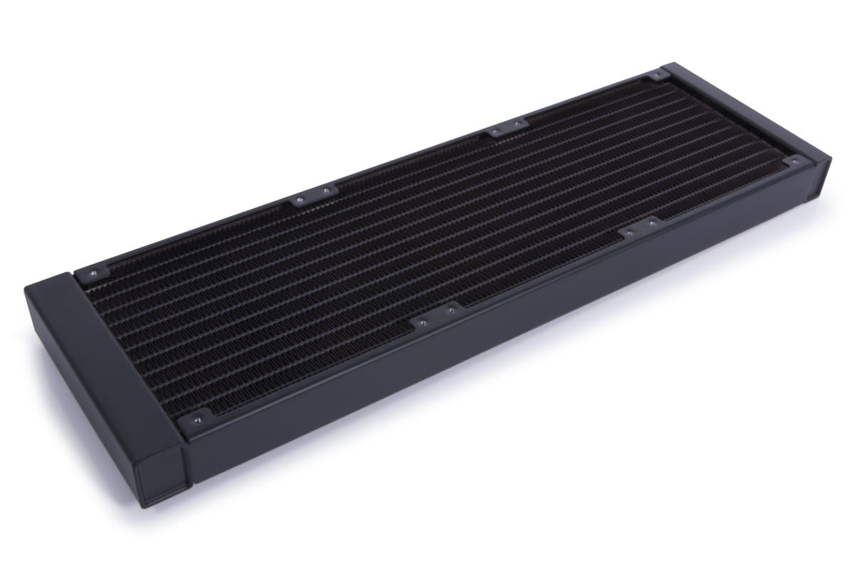

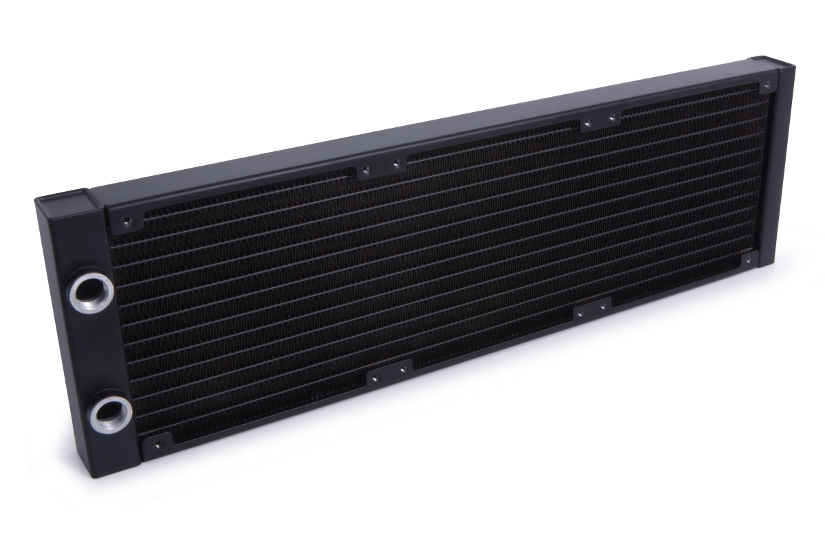

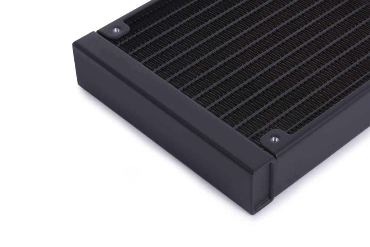

The all-aluminium ES T27 and T38 radiators from Alphacool's ENTERPRISE SOLUTIONS series were... more
The all-aluminium ES T27 and T38 radiators from Alphacool's ENTERPRISE SOLUTIONS series were specially developed for use in the industrial range. Due to the low construction height of 27mm or 38mm, they find space in the smallest of spaces and enable the water cooling of technical equipment in the automotive industry, in mechanical engineering or in the production of films and videos.
High Performance
Compared to Alphacool's full copper models, all ES T27 and T38 aluminium radiators have additional cooling channels. This technical design allows a significant increase in cooling capacity without restricting the water flow within the radiator. The radiators have a high fin density and are particularly suitable for use with fans with high air pressure and air throughput. This achieves a significant increase in the performance of the water-cooled components.
Fitting and mounting options

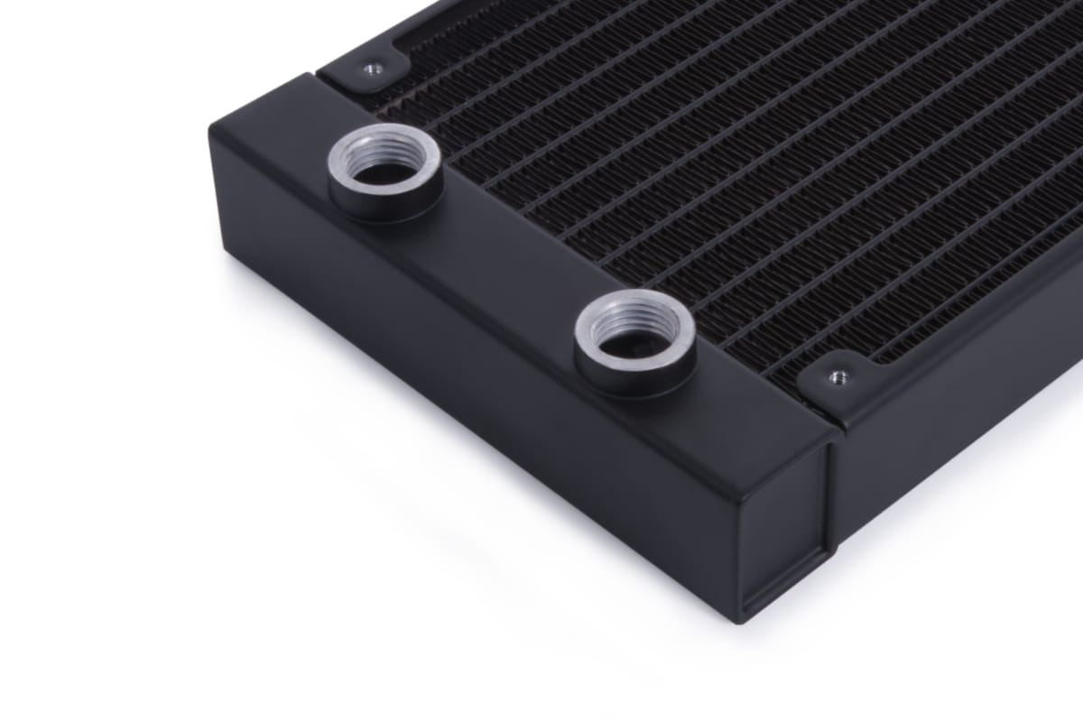

The radiator offers an inlet and outlet (IN/OUT) with G1/4" thread. Screws for case mounting (M3x5) and for fan mounting (M3x30) are included with the radiator. Additional screws are not required for single-sided fan mounting.
Important note

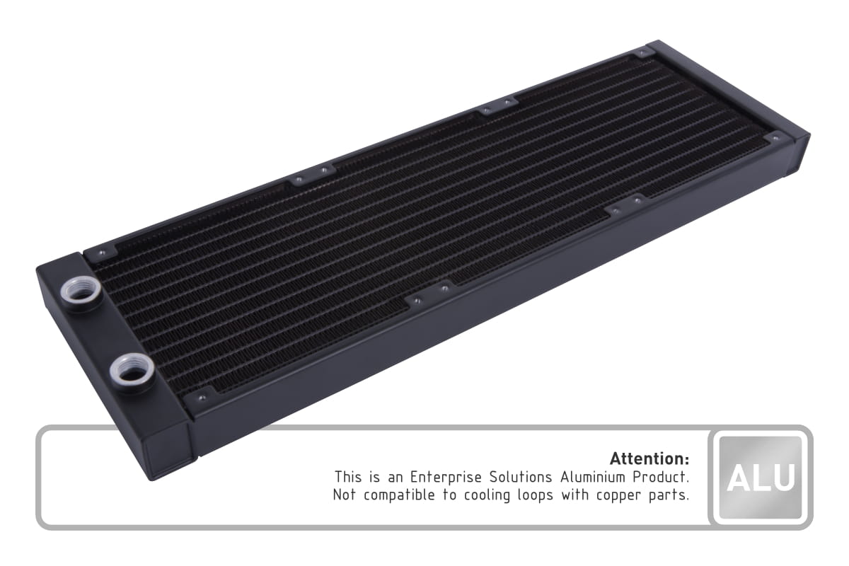

This is an Enterprise Solutions Aluminium product. The ES aluminium radiators must not be used together with copper water cooling products (radiators, fitting, etc.). Using aluminium & copper components together will cause severe damage to the liquid cooling loop.
L x W x H394 x 120 x 27 mm
Material cooling fins, channels & prechamberAluminium
Material outer housing & threadsAluminium
Fins per Inch19
Threads2x G1/4“
Thread size fan mountingM3
Fan size120 mm
Fan slots3 one-sided / 6 double-sided
Max working temperature90 °C
Pressure tested0,8 bar
Weight434 g
ColorBlack
