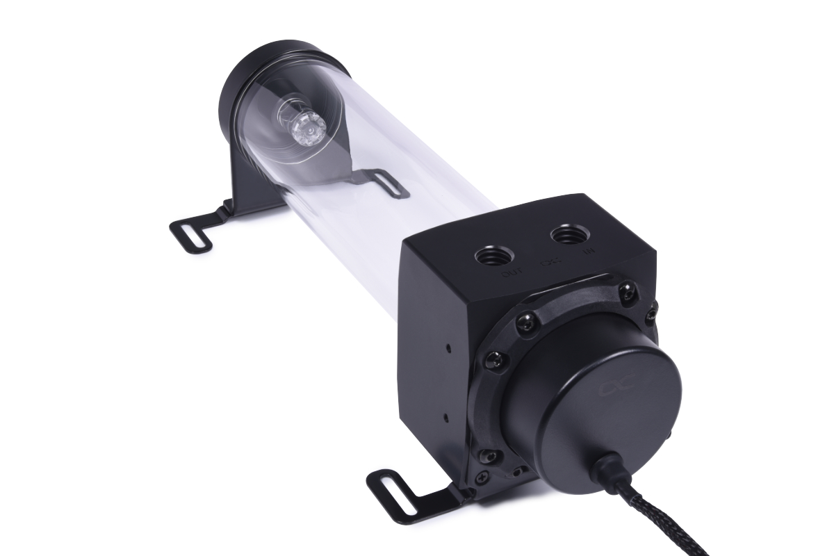

The Alphacool Core reservoir has an integrated pump top for powerful D5 pumps and comes with a VPP Apex pump. The tube of the reservoir is made of acrylic, the D5/VPP pump top and the lid of acetal. The combination of these two materials gives the expansion tank a discreet appearance. The wow effect is provided by 12 digitally addressable RGB LEDs in the pump top and the Lighttower water effect inside the acrylic tube.
What's new?
Compared to the previous Eisbecher models, the acrylic tube of the Core reservoir has an external thread. This provides more stability and safety when connecting the lid and pump top to the tube. Also new is the integrated digital aRGB lighting. 12 digitally addressable RGB LEDs in the pump top are included in the scope of delivery of the Core reservoir and no longer have to be purchased separately.

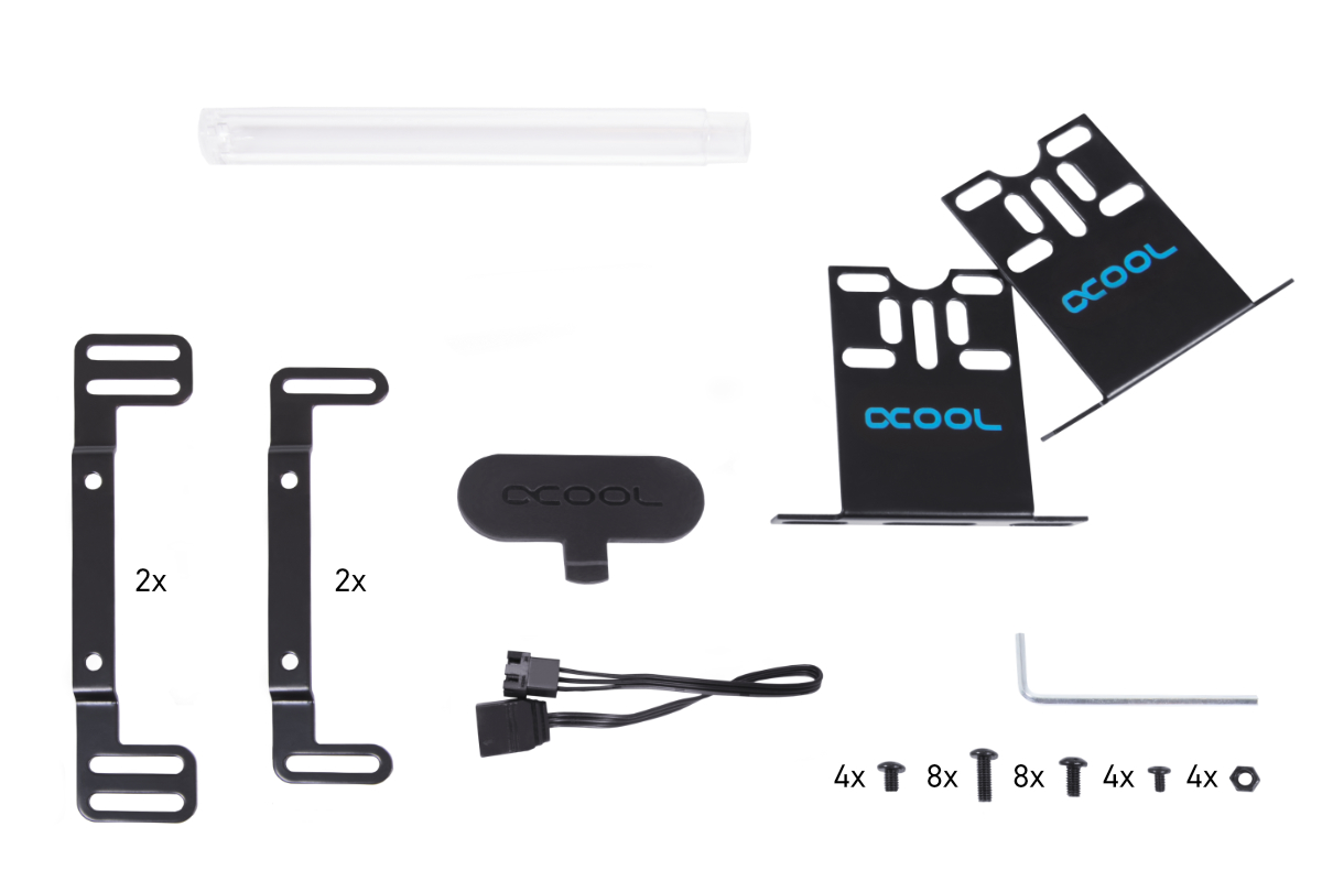

Extensive mounting options
Mounting option 1:
Stands are included in the scope of delivery, which, among other things, allow the expansion tank to be mounted on the bottom of the enclosure.

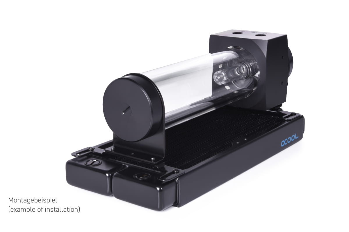

Mounting option 2:
Included in the scope of delivery are 120mm/140mm mounting frames, which can be used to mount the Core expansion tank as desired on free fan spaces, radiators or on the fans on radiators.

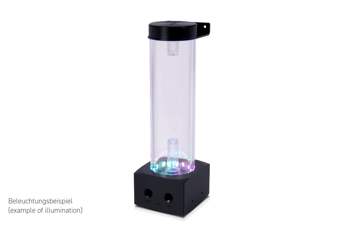

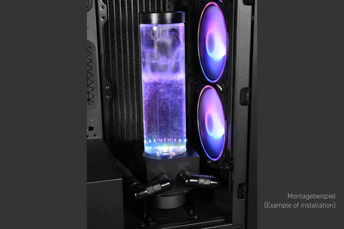

Digitally addressable RGB lighting
12 digitally addressable RGB LEDs illuminate the aycryl tube of the reservoir. They are mounted in a ring at the lower end of the tube in the transition to the pump top and provide brilliant illumination of the entire expansion tank. In combination with the Lighttower water effect, a very special ambience is achieved. The digital aRGB LED lighting is connected via a JST 3-pin connector and can be controlled with a digital RGB controller (e.g. Alphacool Aurora Eiscontrol, Art.15360) or a digital RGB capable mainboard.
A special water effect is created in the core reservoir via the riser tubes. If you do not fill the reservoir beyond the top edge of the riser tube, you get a kind of fountain effect. In this case, the water is pushed out the sides of the riser tube and splashed against the glass tube. Depending on the flow of the circuit, the effect is stronger or weaker. The effect can be placed at the lower or upper inlet using the riser tubes included in the delivery.
Pump compatibility
The Alphacool Core expansion tank has an integrated pump top and is compatible with all original D5 pumps as well as all Alphacool VPP pumps. The pump retaining ring, a pump O-ring and all screws are included in the scope of delivery.

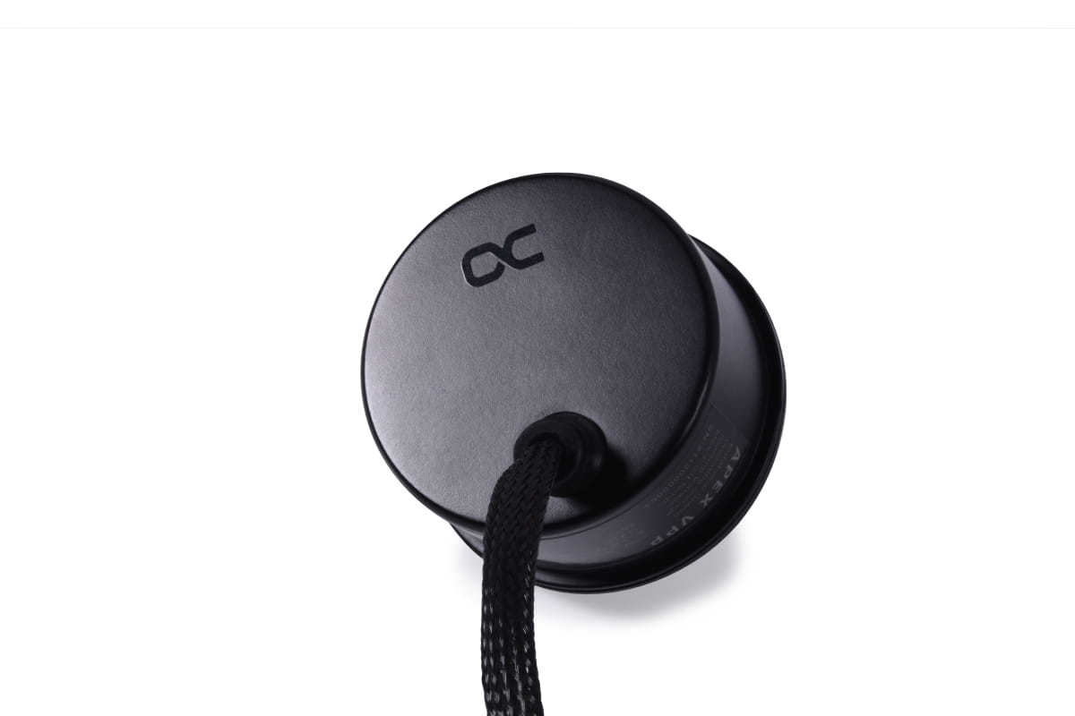

Pump
The VPP Apex pump does without a spherical bearing and uses a ceramic shaft. The motor's coils have been moved from the inside to the outside. These changes have the effect that the pump is fundamentally more stable and smoother running, and any vibrations that arise have been significantly
reduced. Another positive side effect is that power consumption has been almost halved as a result. Compared to Alphacool's Eispumpe, the power is not supplied via a 4-pin Molex connector. Instead, the Apex VPP pump is connected to the power supply using a SATA connector. The Apex VPP pump has a 4-pin fan connector that connects to the motherboard or to an external controller. This allows you to control the speed range of the pump via PWM and read out the RPM signal.

Technical data VPP Apex
Dimensions (L x W x H)65 x 65 x 41 mm
Material pumpsynthetic material
Material pump coveraluminium
Material axleceramics
Connections4-Pin PWM | SATA
Rotational speed2500-4500 rpm
Cable lenghts4-Pin PWM - 48 cm | SATA - 48 cm
Operating voltage8-13 V DC / 14 W IP32
Starting voltage12 V DC
Maximum pumping head4.25 m
Max flow340 L/h
Max working temperature60 °C
Net weight276 g
colorblack
