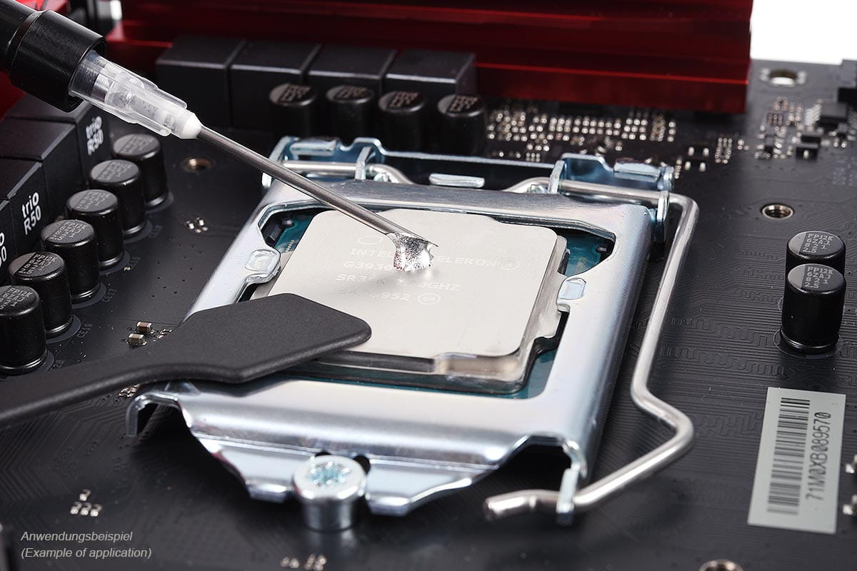

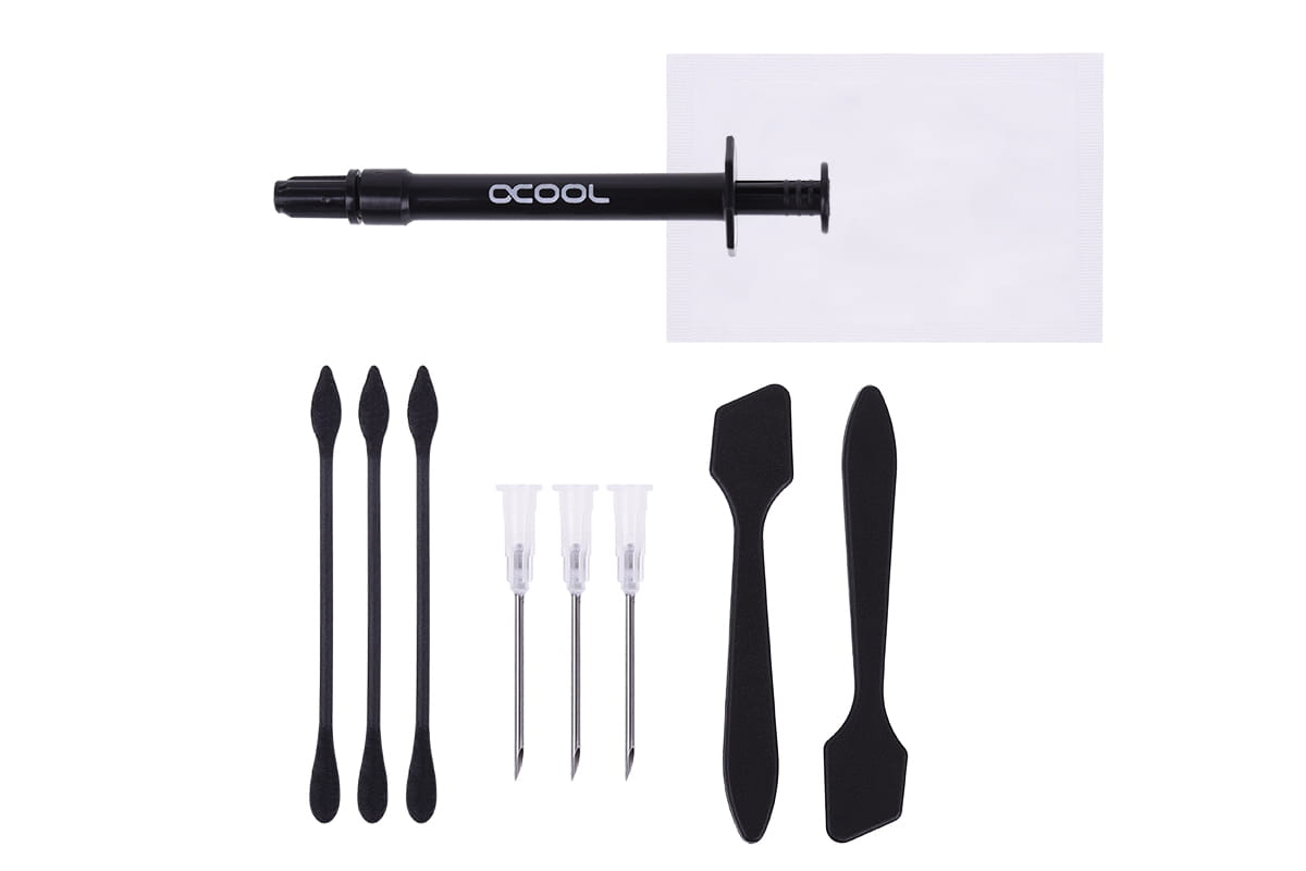

Applying the Alphacool Eisfrost Xtreme liquid metal thermal compound is much easier than you might think. First, you should thoroughly pre-clean the heatspreader of the CPU or GPU. This is best done with a piece of kitchen roll or toilet paper. Then you can carry out the basic cleaning with the enclosed cleaning cloth. You should avoid touching the heatspreader with your fingers after basic cleaning. The small amount of grease residue on the skin can make it difficult to apply.

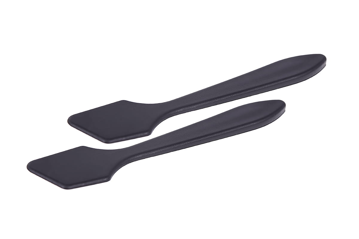

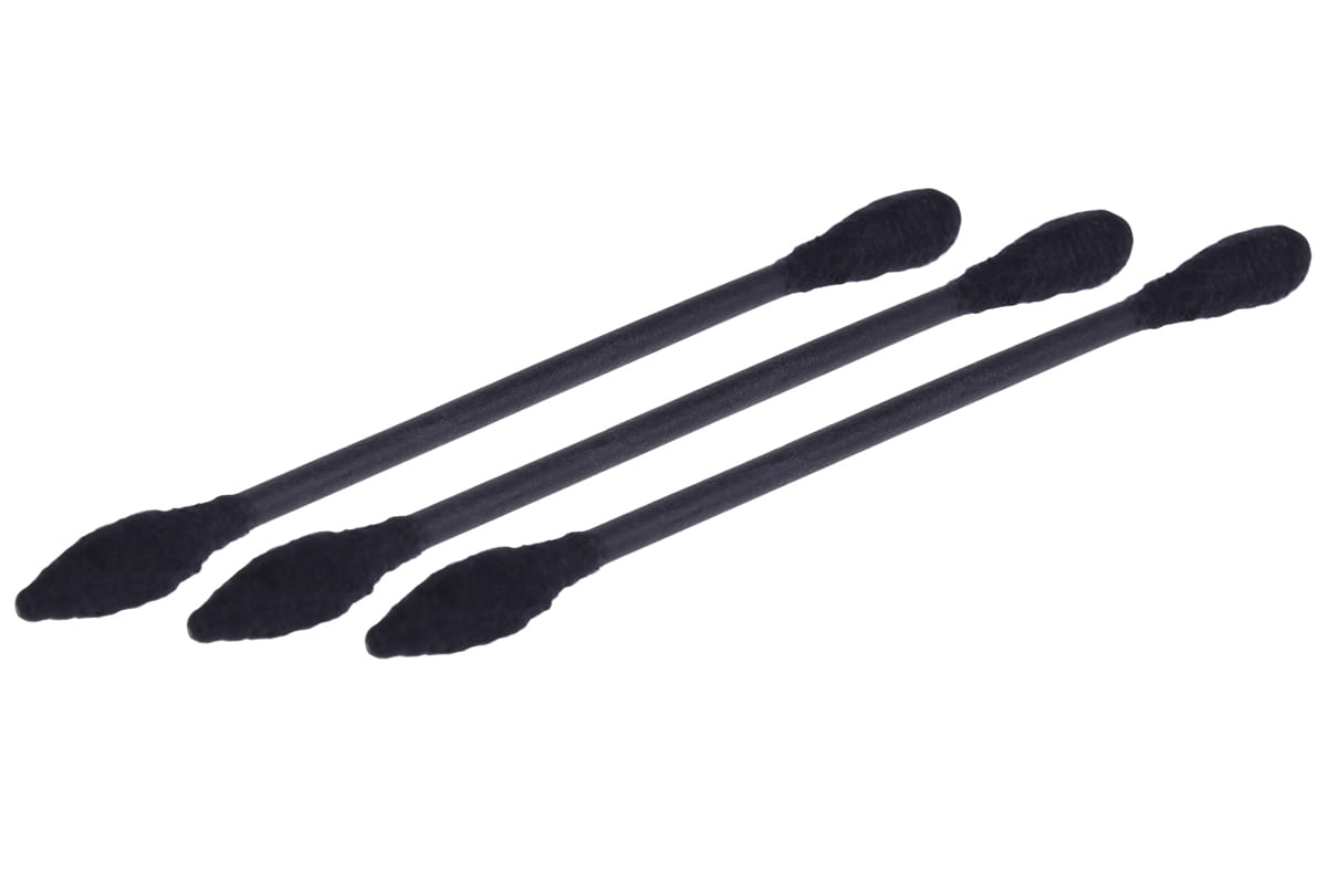

You can now apply a small drop of liquid metal to the center of the heat spreader. This should be smaller than a pea. The package contains two special cotton swabs for applying and spreading the liquid metal. This allows the Eisfrost Xtreme heat-conducting paste to be spread very well. However, you should take your time, as the high viscosity of liquid metal means that it can only be spread slowly.
