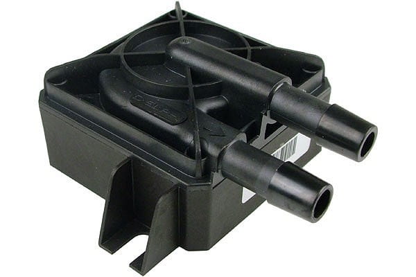

This pump is the world's first pump to be used in mass-produced water-cooled workstations and is... more
This pump is the world's first pump to be used in mass-produced water-cooled workstations and is ideal for water cooling processors and electronic components. Due to its size and performance, it can also be used in a wide range of applications.

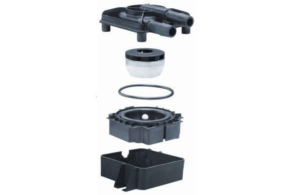

This DC pump is an electronically commutated spherical motor pump, with running times of well over 50,000 hours at 12 volts. The only moving part on a spherical motor pump is a spherically shaped rotor/impeller unit, which rests on an ultra-hard, wear-resistant ceramic bearing ball.
There is no conventional shaft with shaft bearings and shaft seals. The spherical bearing of the rotor/impeller unit on the ceramic bearing ball offers a number of advantages: The development of bearing play - and thus an increase in noise - is fundamentally impossible. The pump therefore remains quiet over the entire running time. The bearing is self-adjusting. It is lubricated directly by the pumped medium (wet rotor pump). Maintenance is therefore not required. Since the rotor is always held magnetically in the intended position, small dirt particles are not a problem. Blocking the pump is normally not possible. It is possible to start up safely even after a long period of downtime. The permanent magnetic rotor/impeller unit is driven by a magnetic field generated by the surrounding stator.
This is built completely around the rotor. The entire pump is therefore only slightly higher than the stator itself. It therefore fits easily into all commercially available PC, barebone and mini-PC housings. Separate magnetic shielding is normally not necessary. The spherical motor principle enables economical operation with comparatively high performance. The DDC direct current pump can be easily controlled over a wide performance range by varying the voltage. All parts that come into contact with the media are completely corrosion-resistant.

L x W x H 91x88x40mm
material Stainless steel 1.4571, PPS-GF40, EPDM O-rings, aluminum oxide, hard carbon
Connections 2x 10/8mm hose connection (no nozzle required)
Speed max. 3900 rpm
Max. current consumption 13.08 W
Tension 12V DC
Power connection 4-pin Molex
PWM control | Tachometer signal n/a | yes (3-pin Molex)
Max. operating temperature room 10°C - 50°C
Max. operating temperature water 10°C - 60°C
Max. discharge head 3.24m
Max flow 480L/h
Max. pump pressure 0.3bars
Weight 213g
Color black
Revision DDC4.1F-HT1CWX-01 BP36
