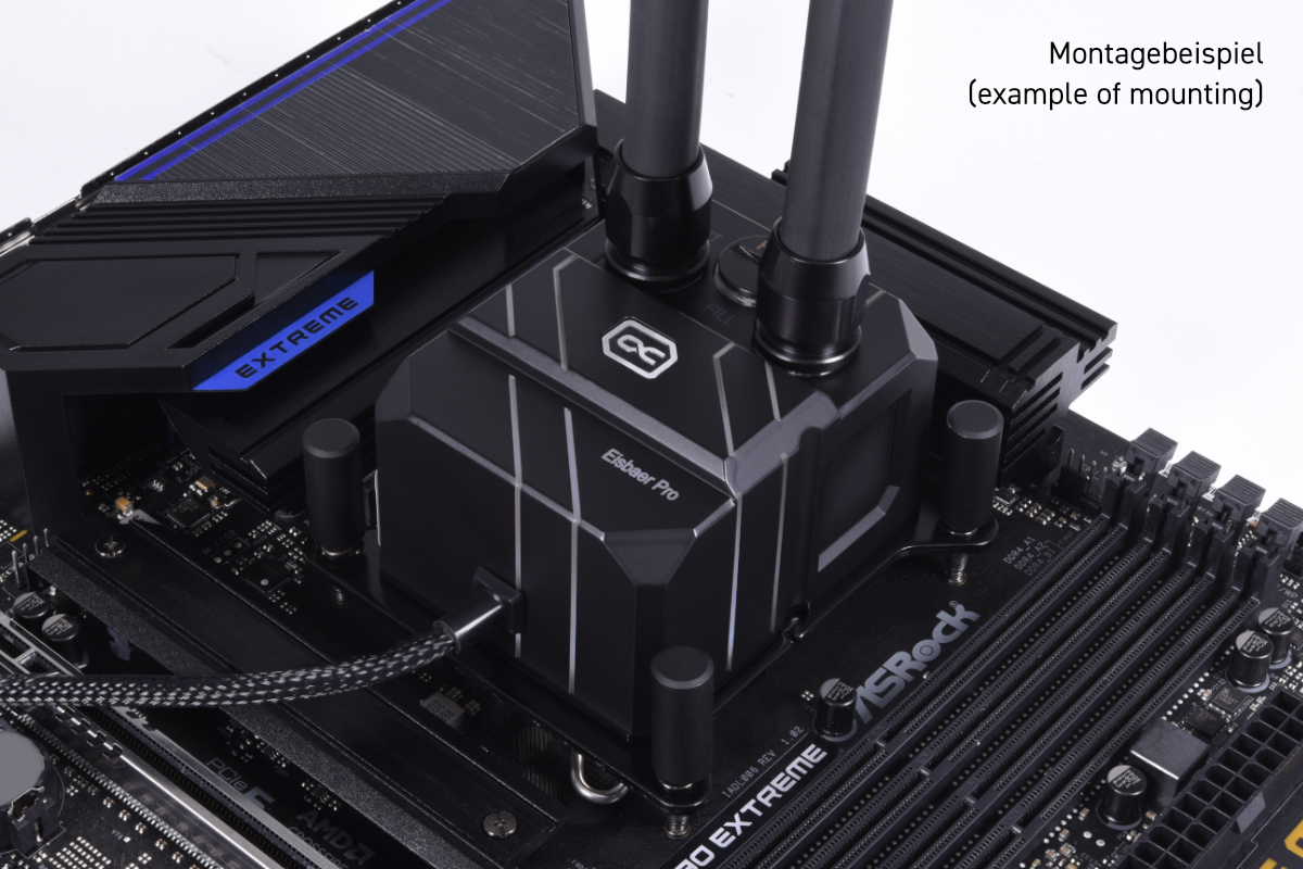

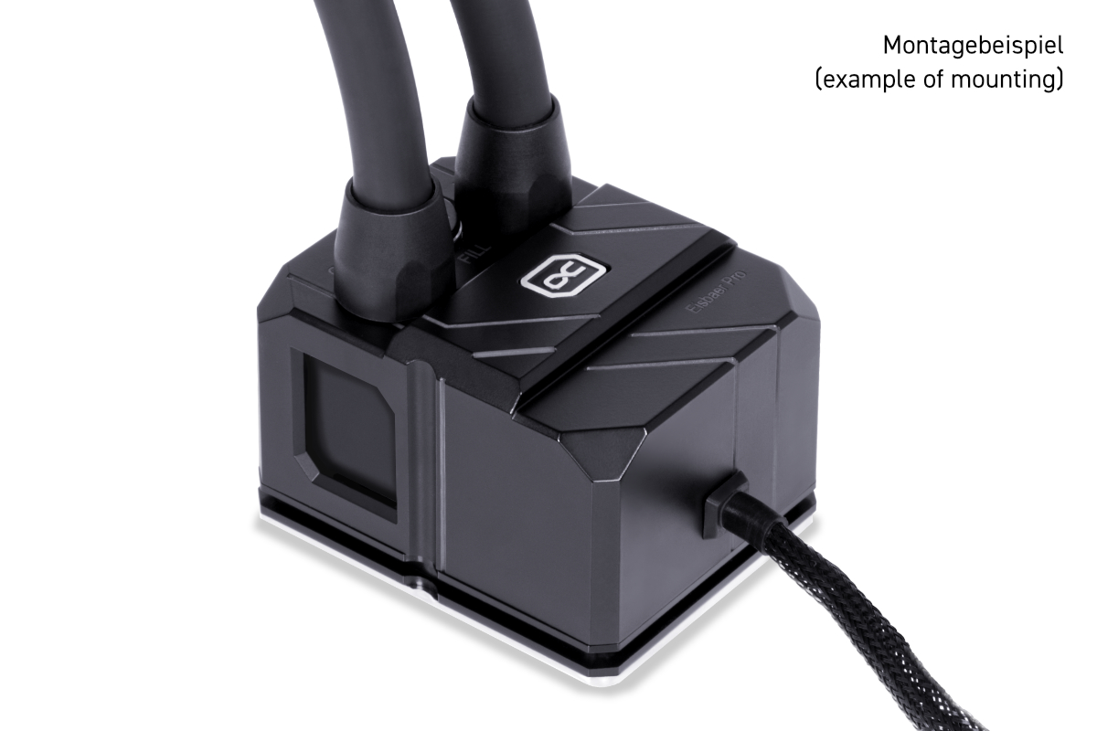

The Alphacool Eisbaer Pro ES (Solo) offers a much larger cooling surface than the normal... more
The Alphacool Eisbaer Pro ES (Solo) offers a much larger cooling surface than the normal Eisbaer. It was specially developed for extremely large CPU DIEs and fully covers processors such as the AMD Threadripper but also the AMD Ryzen CPUs. The Eisbaer Pro has also been designed for the Intel Socket 3647 to ensure the best possible cooling performance of the entire CPU. The Eisbaer Pro is a true multi-talent. Expandable, fully compatible with DIY water cooling components and it is the optimal solution for the most powerful processors on the market.

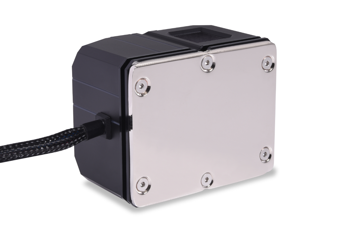

Large cooling surface

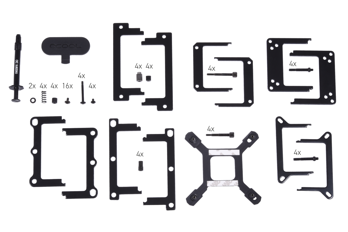

The cold plate bottom covers the entire surface of the respective processors. The area of the cooling fins exceeds all known processor cores with an area of around 55 x 42mm. This ensures that all hotspots of a CPU are directly covered and thus optimally cooled. With the included AM4 bracket, cooling an AMD Ryzen processor is also child's play. The cooling fins are 0.4mm thick and also have an optimal distance of 0.4mm between them. In total there are 58 cooling fins on the bottom of the cooler. The bottom of the cooler is only 3mm thick, which allows the heat to reach the water and be dissipated as quickly as possible.

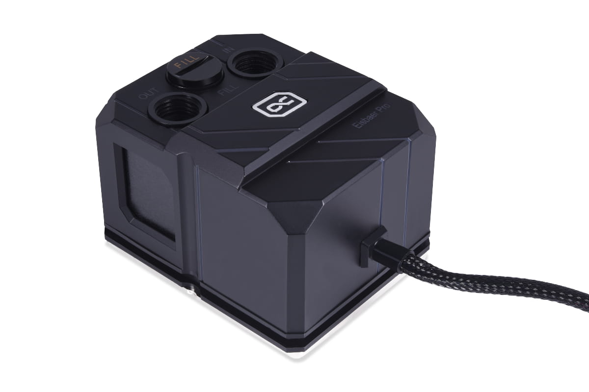

Pump
The Eisbaer Pro ES (Solo) cooler uses the very compact and small DC-LT 2 pump. It offers enough power to integrate other components such as a GPU water cooler or radiator into the water circuit.

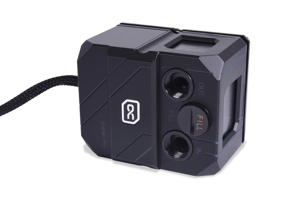

Usable fittings
Connections that are too large mean that the fill port can no longer be used. We recommend the following:
- up to and including 13/10 without restriction
- 16/10 only in angled version
- Connections larger than 16/10 should not be used
With the Alphacool LGA 4677 Mounting Bracket (article no.: 13764), this cooler is also compatible with the Intel socket LGA 4677.
Intel: LGA 1700 / LGA 1851 / LGA 2011 / LGA 2011-3 / LGA 3647 / LGA 4189 / LGA 4677 (optional) / LGA 4710 (optional)
Technical data cooler with pump
L x W x H64 x 79 x 54,3mm
Material cooler bottomnickel plated copper
Material cooler topacrylic
Threads2x G1/4“ (+ 1x Fillport G1/4“)
Pump typeDC-LT2
Pump speed2600 rpm (+/- 10%)
Head of delivery1 m
Maximum flow72 L/h
Voltage6-13,5V DC
Power consumption3,2W
Pressure tested0,8 Bar
