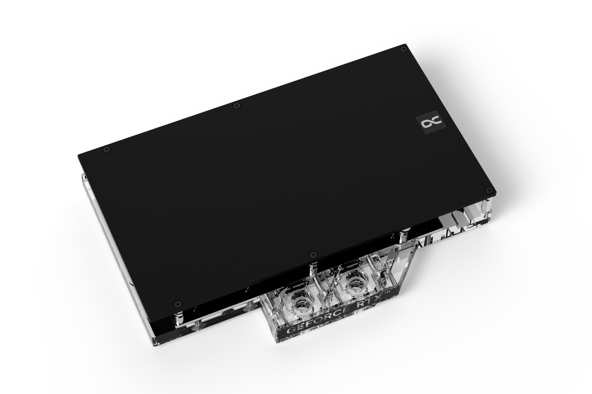

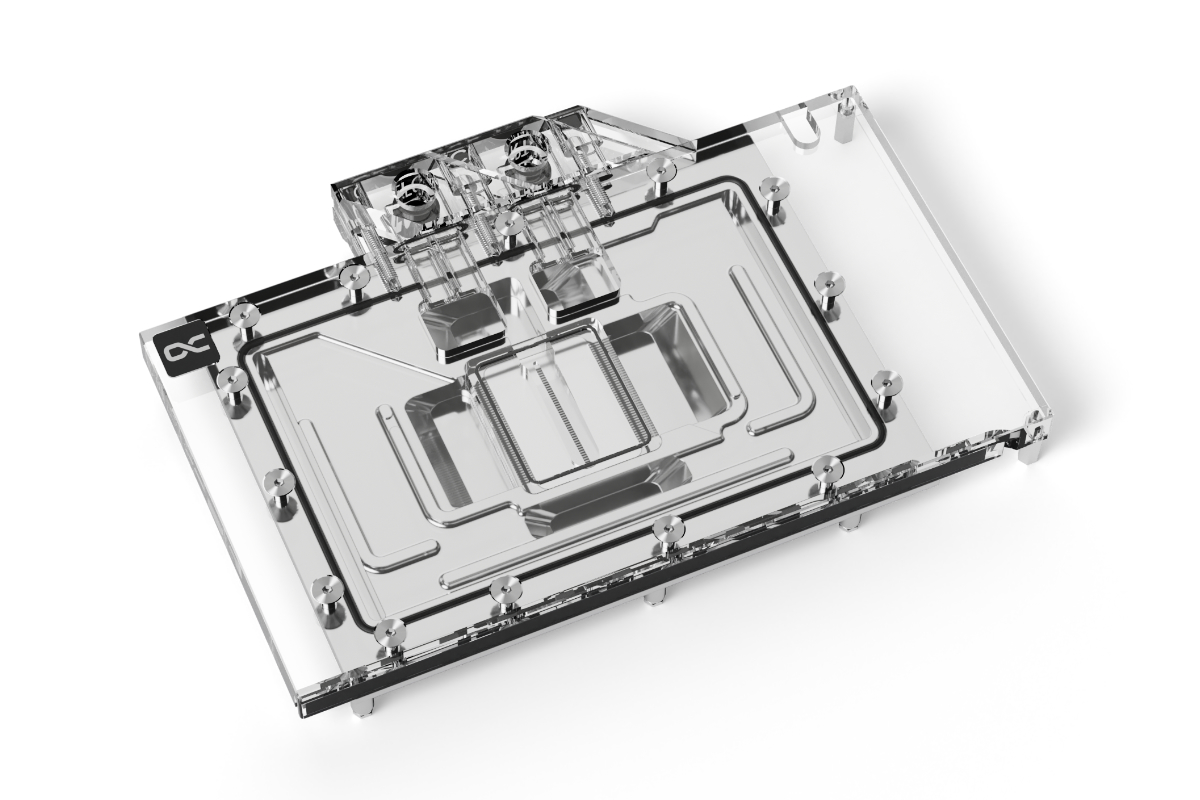

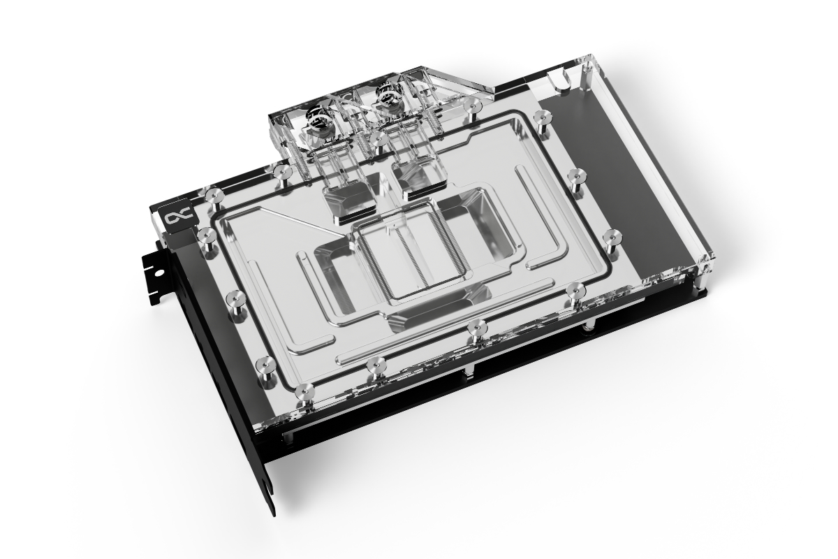

The next generation - the Alphacool Eisblock Aurora water cooler for Geforce RTX 40XX graphics... more

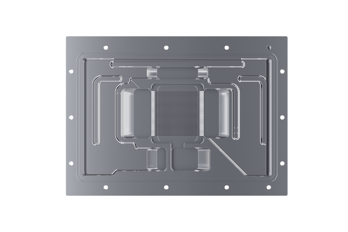

The next generation - the Alphacool Eisblock Aurora water cooler for Geforce RTX 40XX graphics cards. In order to dissipate the enormous heat of this graphics card generation in the best possible way, numerous optimizations have been made to the water cooler compared to the previous model. The fin structure was adapted and enables a very good water flow while increasing the cooling surface. The modified jet plate with improved inflow engine ensures an optimal distribution of the water on the cooling fins.
Technical Highlights
The fin structure of this Eisblock cooler generation was developed together with Nvidia board partners. The fin thickness is 0.4 mm, the distance between the cooling fins is 0.4 mm. This ensures a very good water flow while increasing the cooling surface. The jet plate has a revised inlay that spreads the water pressure better over the fins thus optimizing the heat absorption. The adjusted water inflow gives the water a better angle of inflow.
Chrome-plated copper
Design

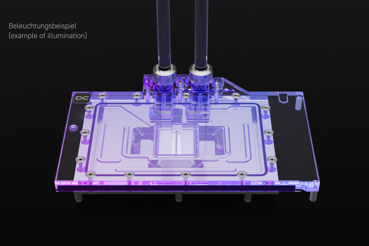

The Aurora design of the Geforce RTX 40XX Eisblock generation is visually calmer and simpler. Only one O-ring runs around the entire cooler. The design around the cooling fins and jetplate makes for a cleaner look. The illumination of the digitally addressable RGB LEDs is even better distributed throughout the cooler as a result of the chrome plating. The terminal's design is in line with the classic Aurora design.
Thermal paste & thermal pads
- Gainward GeForce RTX 4080 Phantom GS, 16GB GDDR6X (3499)
- Gainward GeForce RTX 4080 Phantom, 16GB GDDR6X (3505)
- Palit GeForce RTX 4080 GameRock OC, 16GB GDDR6X (NED4080S19T2-1030G)
- Palit GeForce RTX 4080 GameRock OmniBlack, 16GB GDDR6X (NED4080019T2-1030Q)
- Palit GeForce RTX 4080 GameRock, 16GB GDDR6X (NED4080019T2-1030G)
Technical data cooler
L x W x H215,50 x 145,90 x 34,17mm
Material cooler topacrylic
Pressure tested0,8 bar
Max working temperature60°C
Threads4 x G1/4"
Thickness cooling fins0,4mm
Distance cooling fins0,4mm
Illuminationdigital aRGB LEDs
Power digital aRGB LEDs5V
Number of digital aRGB LEDs12

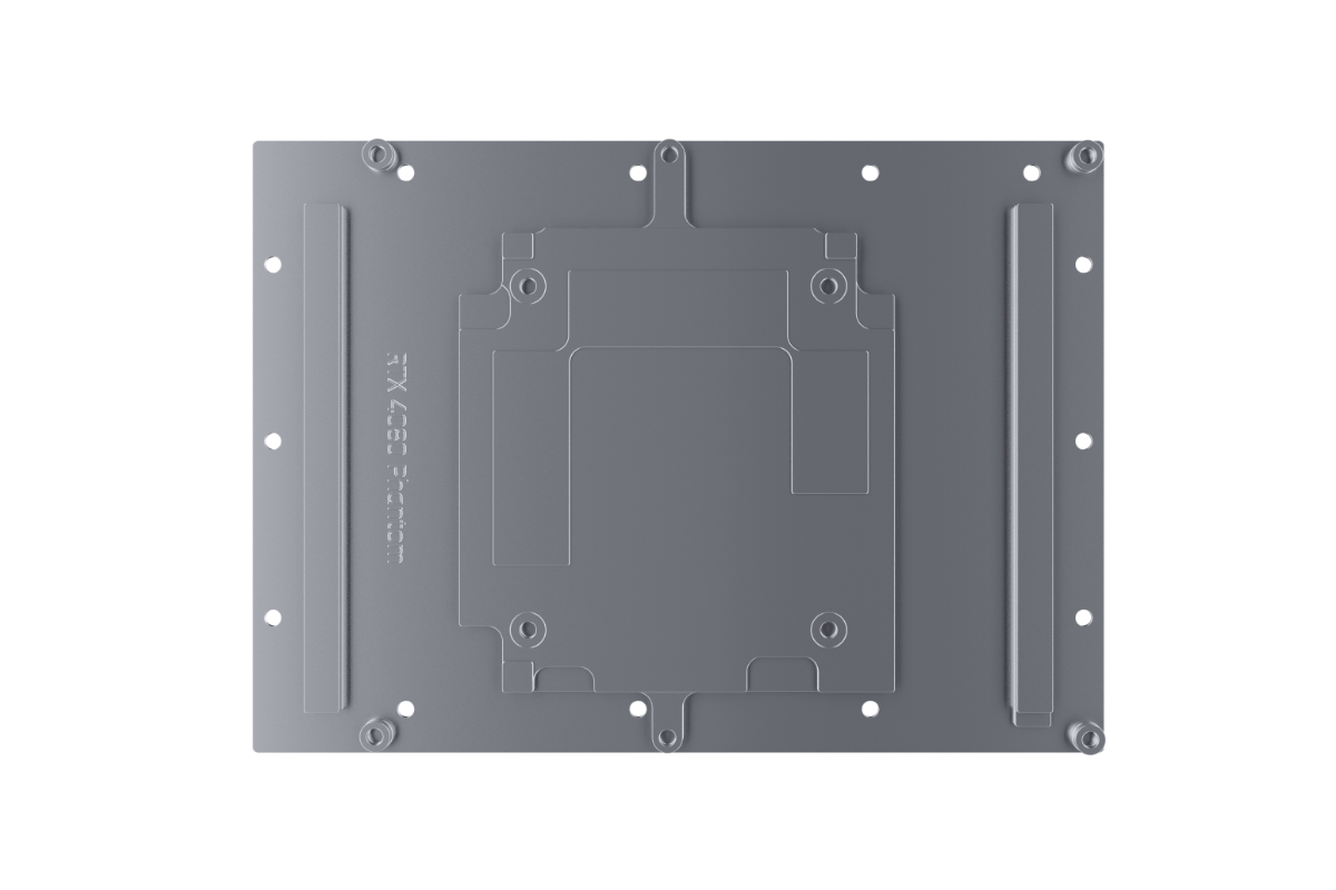

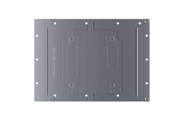

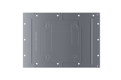

Technical data backplate
L x W x H215,50 x 121,40 x 6mm
Materialaluminium
