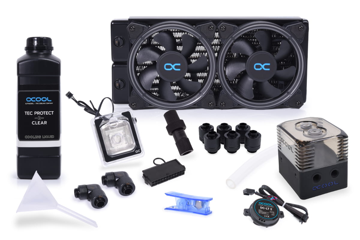

With the Core Wind water cooling kit, Alphacool provides all the components needed to get... more
With the Core Wind water cooling kit, Alphacool provides all the components needed to get started in the world of water cooling. The set is aimed not only at beginners, but also at enthusiasts. The selected components are optimally matched and come from Alphacool's DIY program. The choice of materials is still uncompromisingly based on copper or brass for all metals in order to guarantee performance-oriented CPU cooling. Due to the included quick-release fastener, additional components like radiators or GPU coolers can be integrated afterwards without having to drain or rebuild the water loop.

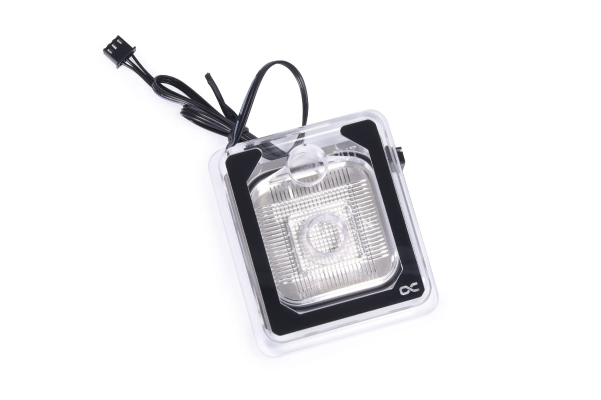

Eisblock Aurora XP³ Light CPU-Cooler
With the Eisblock Aurora XP³ Light you get a very compact CPU water cooler for all common mainstream sockets from AMD and Intel. The nickel-plated copper cooler base has an area of 56 x 56mm with cross-slot structure and 0.4 x 0.4mm thick pins through which the water can flow. Due to the extremely large cooling surface, the water can effectively absorb and dissipate heat from the cooler base. The Aurora design in conjunction with the 9 addressable digital aRGB LEDs offers many options for outstanding CPU water cooler illumination.

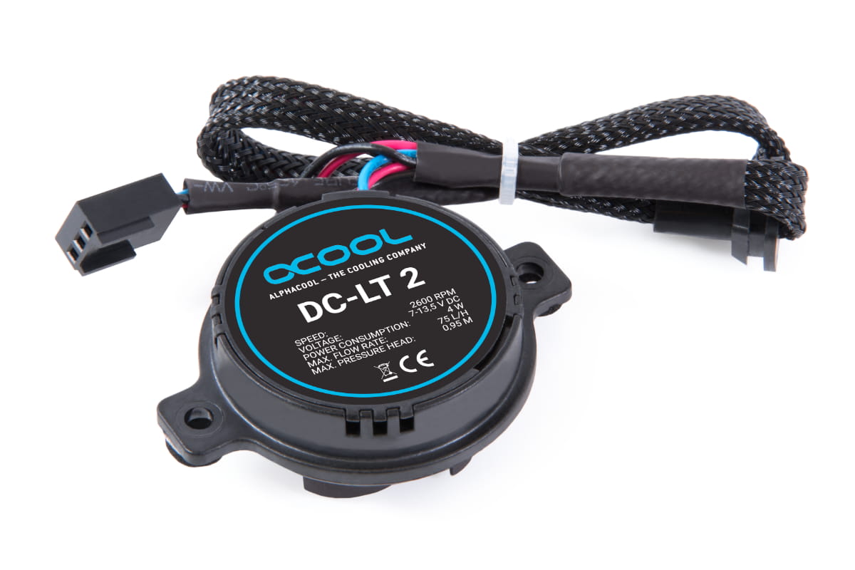

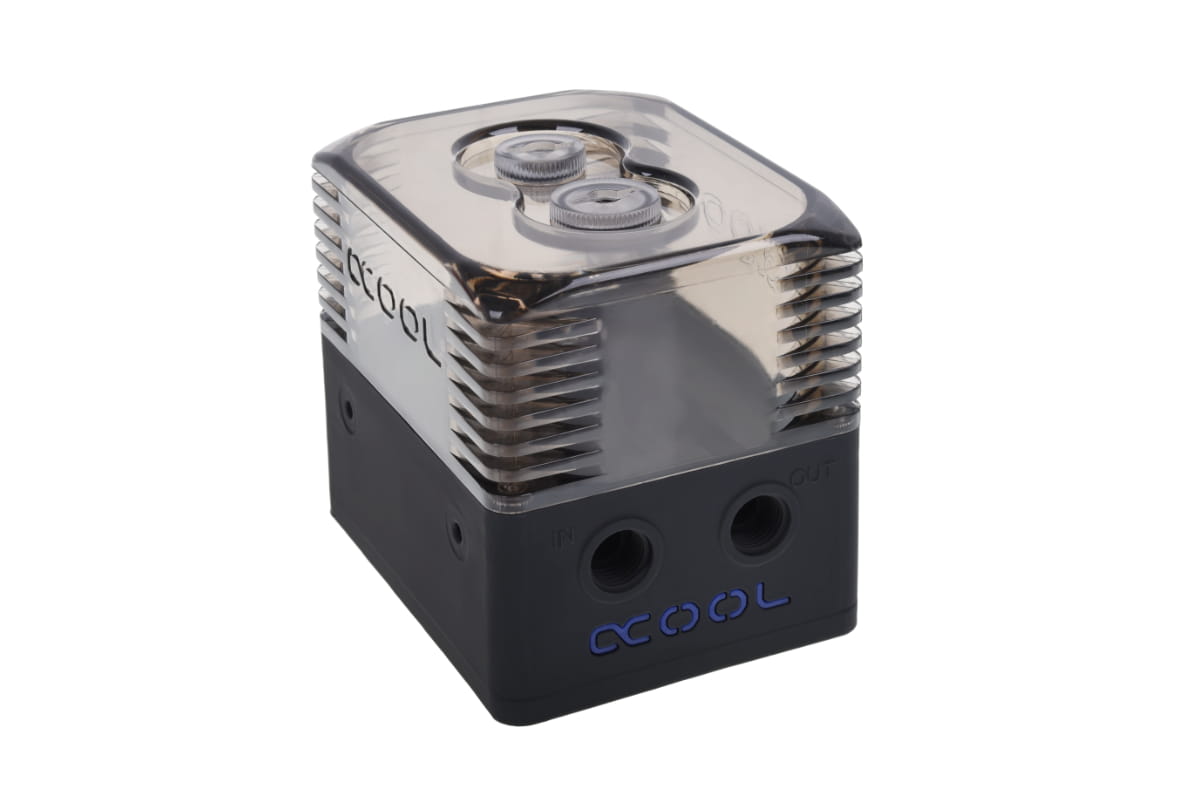

Eisstation DC-LT Reservoir & DC-LT 2 Pump
The Eisstation reservoir is extremely compact and flexible in use due to a variety of mounting options. Three G1/4" connections allow uncomplicated integration into the water loop. The additional G3/8" connection facilitates the filling of the reservoir. The DC-LT 2 pump is installed in the bottom of the Eisstation and is not visible from the outside. Due to its design, the pump is extremely quiet without having to sacrifice performance.

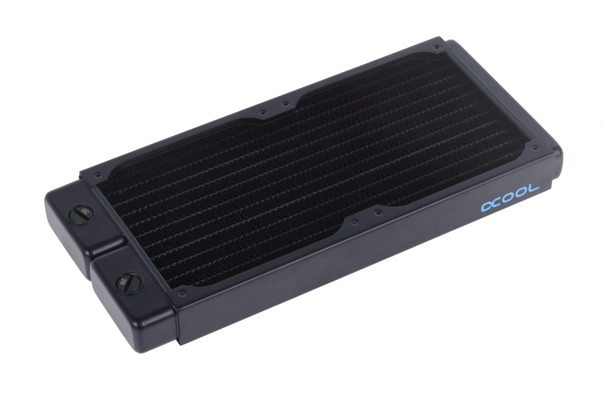

NexXxoS ST30 Full Copper 240mm Radiator V.2
All water-bearing parts and the cooling fins are made of pure copper. Thus, the NexXxoS ST30 achieves the highest thermal conductivity value of all radiators on the market and can easily dissipate extremely high waste heat. The radiator has two IN or OUT connections with G1/4" threads in the pre-chamber area. On the opposite side is a fill or vent port, which can be used to fill and drain the water loop.

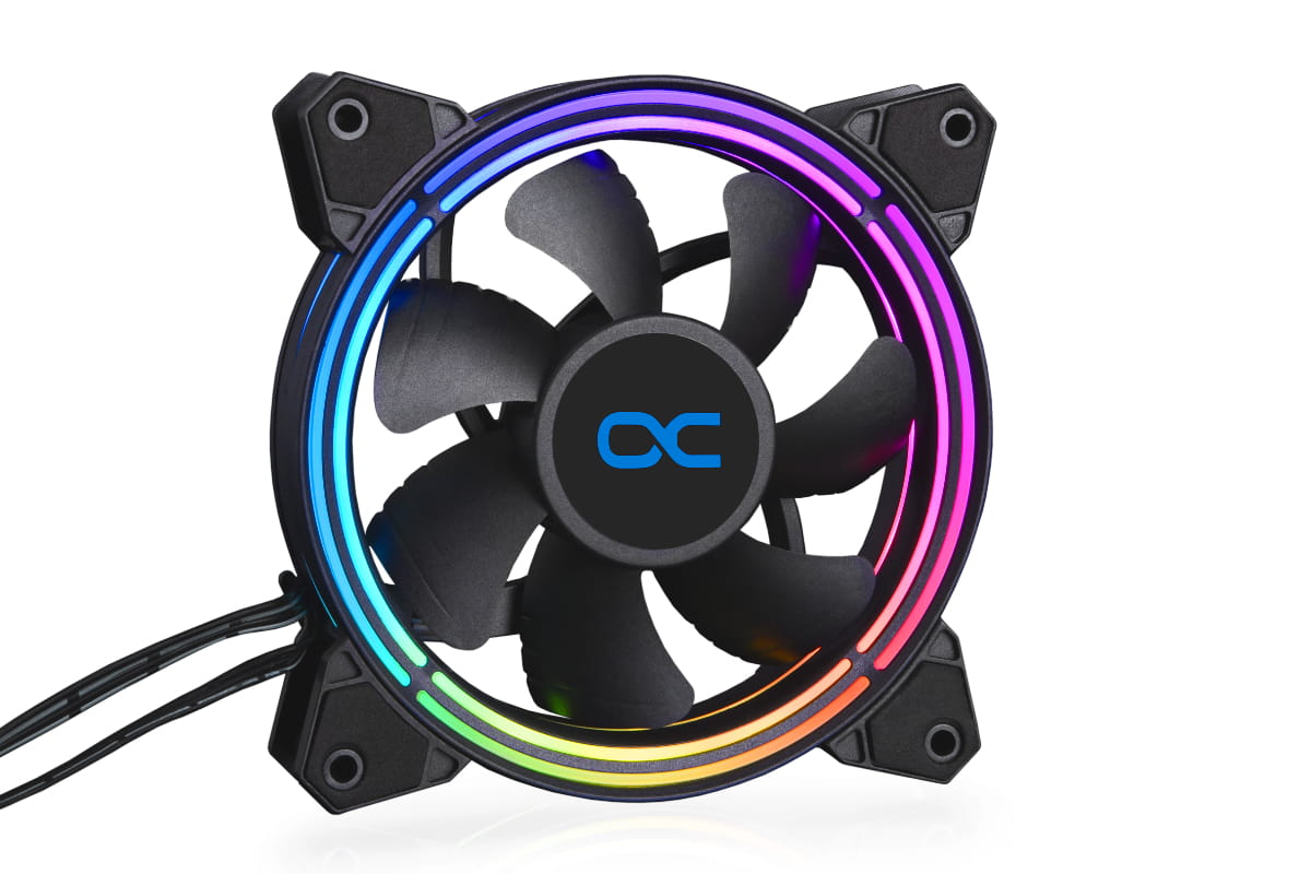

Eiszyklon Aurora LUX PRO Digital RGB Fan (120x120x25mm)
The Eiszyklon Aurora LUX Pro fan offers a wide range of control as well as superior digital aRGB LED lighting. The individually controllable 5V aRGB LEDs coupled with the special design of the fan frame create unique lighting effects. The fan can be controlled from 800 to 2000 rpm via the 4-pin PWM connector. At 800 rpm, the fan is nearly silent, but still provides good airflow paired with high static pressure.

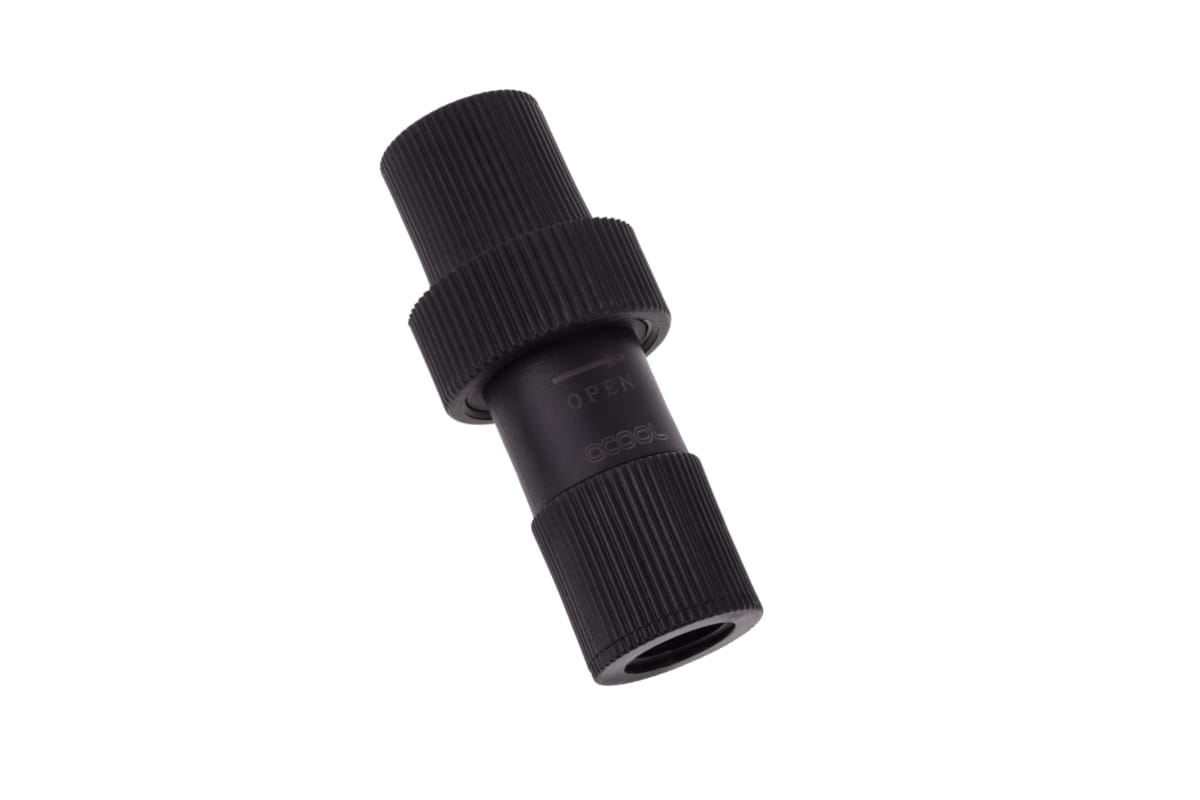

AlphaTube HF 13/10mm tubing & HF G1/4" quick connect coupling
The clear 13/10mm hose made of PVC offers comfortable handling when routing and connecting water cooling components. It has good routing and kinking characteristics and allows uncomplicated bridging of tight bend radii. The HF quick-connect coupling included in the scope of delivery allows easy integration of further components at a later date without having to drain or rebuild the water loop.

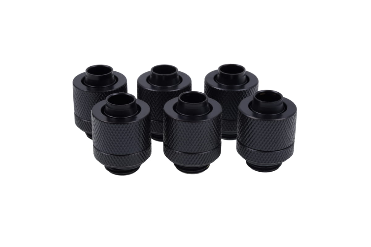

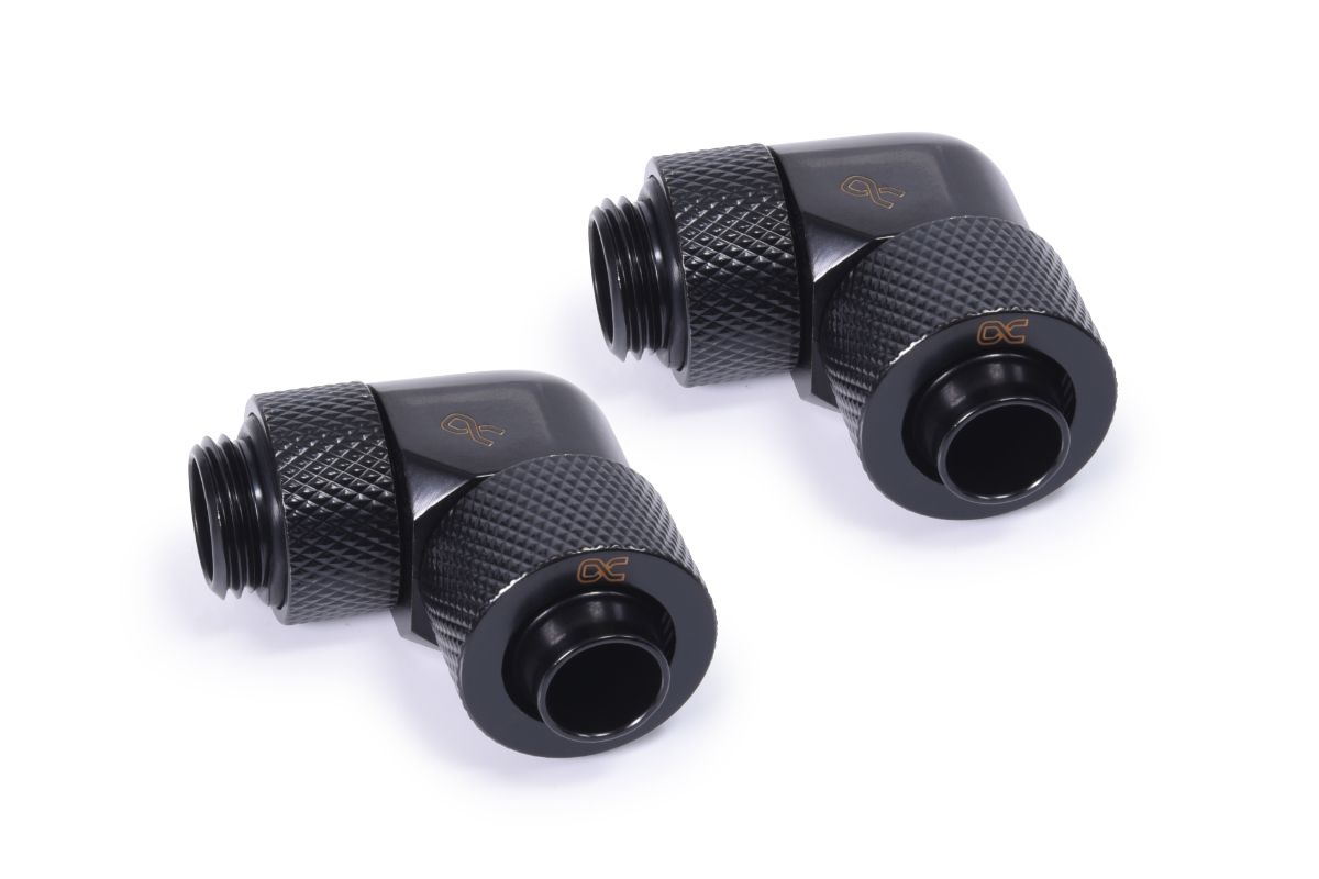

Eiszapfen 13/10mm G1/4" Connections
All the requirements for a connection are met here: Highflow, shape, machining and coloring. Special manufacturing processes firmly bond the coating to the substrate. This increases the longevity of the color and prevents the coating from flaking off.
Thermal Paste & Coolant
The included thermal paste is Alphacool's Subzero with a thermal conductivity of 16 W/mk. The electrically non-conductive Thermal Grease is particularly well suited for high contact pressures, but can still be processed perfectly due to its viscosity of 850,000 TF. Tec Protect 2 Clear in the 1 liter bottle is used as the coolant. Tec Protect 2 Clear is a ready-to-use mixture that already contains all the necessary additives and can be used straight from the bottle.
aRGB Controller, Cables, Tools & Accessories

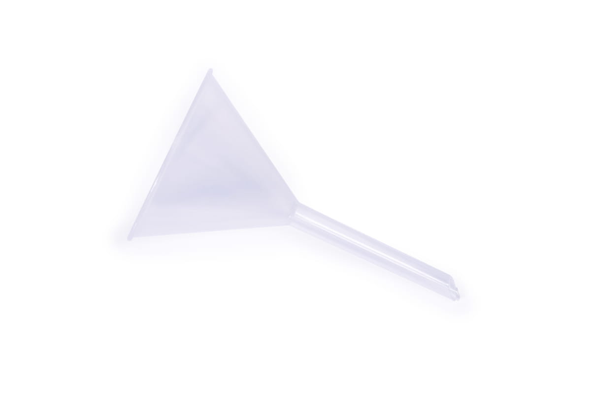

All cables (aRGB, PWM) and controllers needed to use & control the pump, fan and aRGB lighting are included. The accessory package also includes important tools like hose cutter, filling bottle and an ATX 24-pin jumper. Thus, the construction of the custom loop can be started "out-of-the-box" immediately.

Technical data CPU cooler
Dimensions (L x W x H)73 x 63 x 21 mm
Material coolernickel-plated copper
Material housingacrylic
Threads2 x G 1/4
Illumination3-Pin 5 V, 9 digital aRGB LEDs
Max working temperature60 °C
Pressure tested0.8 bar
Technical data reservoir
Dimensions (L x W x H)102 x 82 x 85 mm
Capacity250 ml
Material housingnylon, PMMA
Threads3x G 1/4 IT | 1x 3/8" IT
Illumination4x 5 mm LED
Technical data pump
Dimensions (L x W x H)52 x 41 x 18 mm
Materialsynthetic material, ceramics
Threads3-Pin JST
Speed2600 rpm
Operating voltage6-13.5 V
Power consumption3.2 W
Maximum pumping head1 m
Maximum flow rate72 L/h
Technical data radiator
Dimensions (L x W x H)271.5 x 124 x 30 mm (±3 %)
Material threadsbrass
Threads4x G 1/4 IN/OUT & 1x Fill-/Drainport G 1/4
Possible fan size120 mm
Possible fan assembly2x one-sided / 4x both-sided
Fin density15
Technical data fan
Dimensions (L x W x H)120 x 120 x 25 mm
Speed800-2000 rpm (±10 %)
Threads4-Pin PWM
Voltage12 V DC
Current consumption4.8 W
Static pressure2.0 mmH₂O
Max. air flow104.49 m³/h
Speedometer signalyes
Illumination3-Pin 5 V, 16 digital aRGB LEDs

Technical data 13/10mm G1/4" fittings
Materialbrass
Threads1x G 1/4 OT | 1x tube connection 13/10 mm
Technical data quick release coupling
Dimensions (L x D)60.3 x 26.1 mm
Threads2x G 1/4 IT
