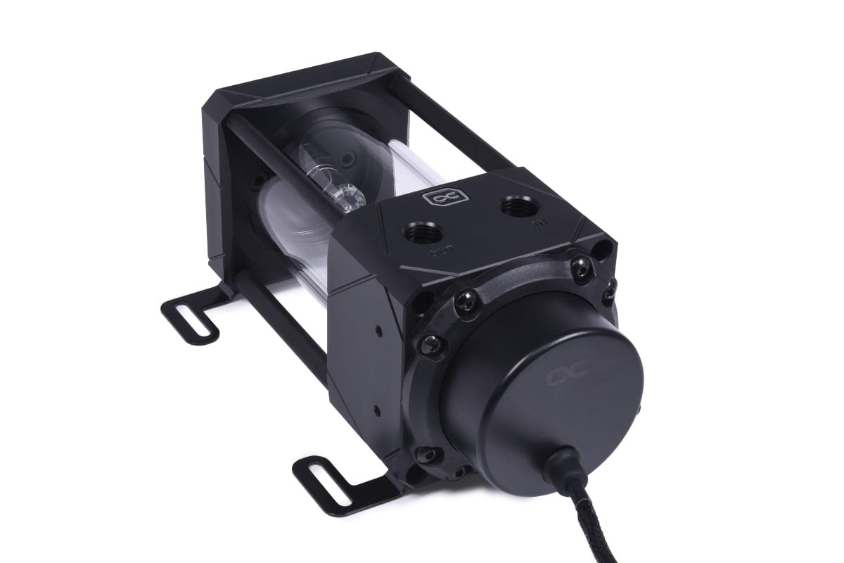

The Alphacool Eisbecher Aurora reservoir has an integrated pump top for powerful D5 pumps and... more

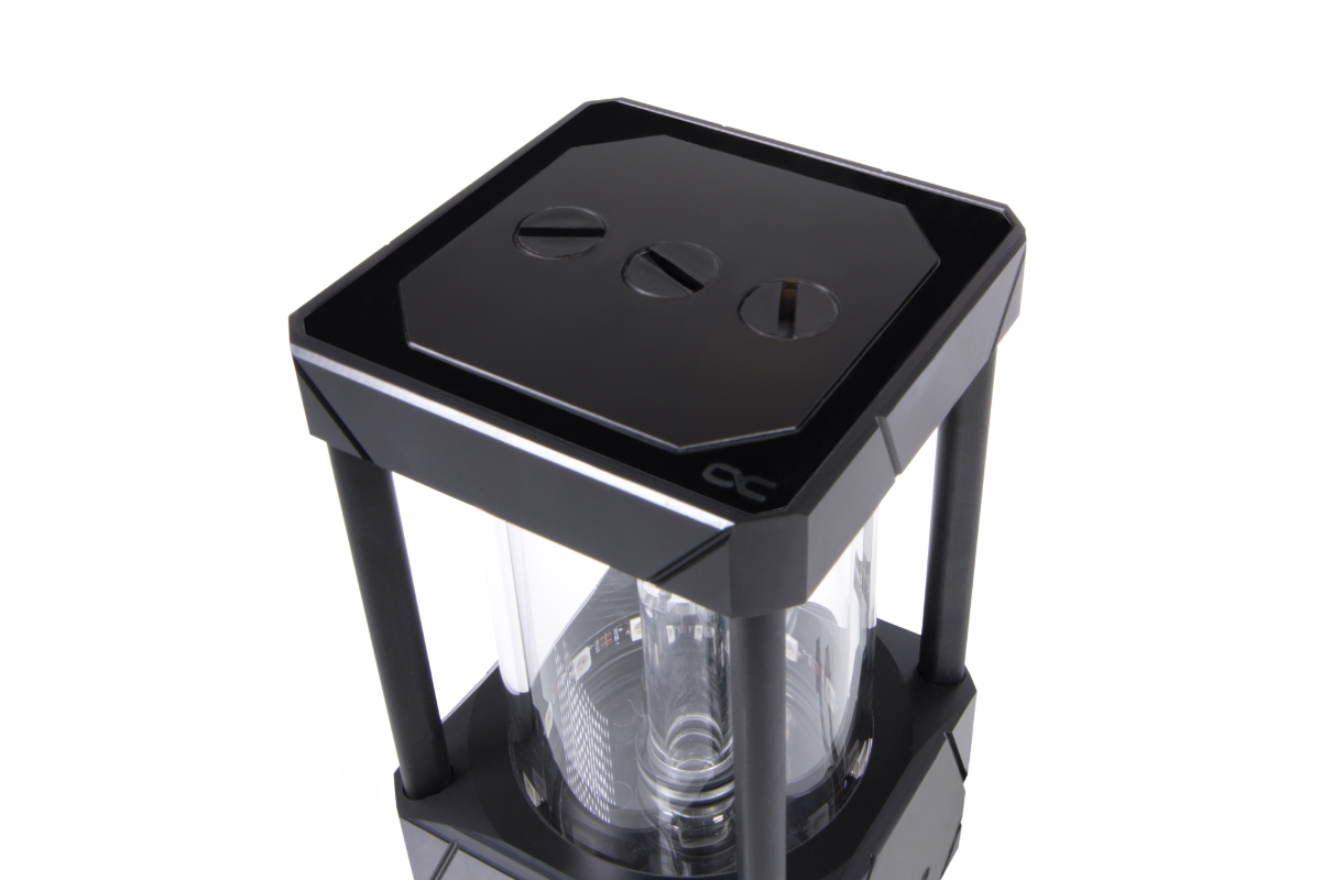

The Alphacool Eisbecher Aurora reservoir has an integrated pump top for powerful D5 pumps and comes with a VPP Apex pump. The tube of the reservoir is made of glass, the D5/VPP pump top and the lid of acetal. The combination of these two materials gives the expansion tank a magnificent appearance. The wow effect is provided by 12 digitally addressable RGB LEDs in the pump top and the Lighttower water effect inside the glass tube.

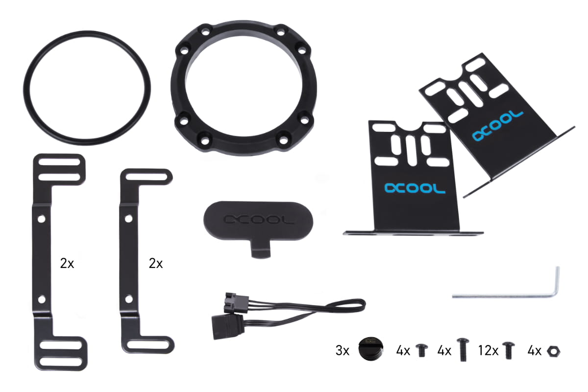

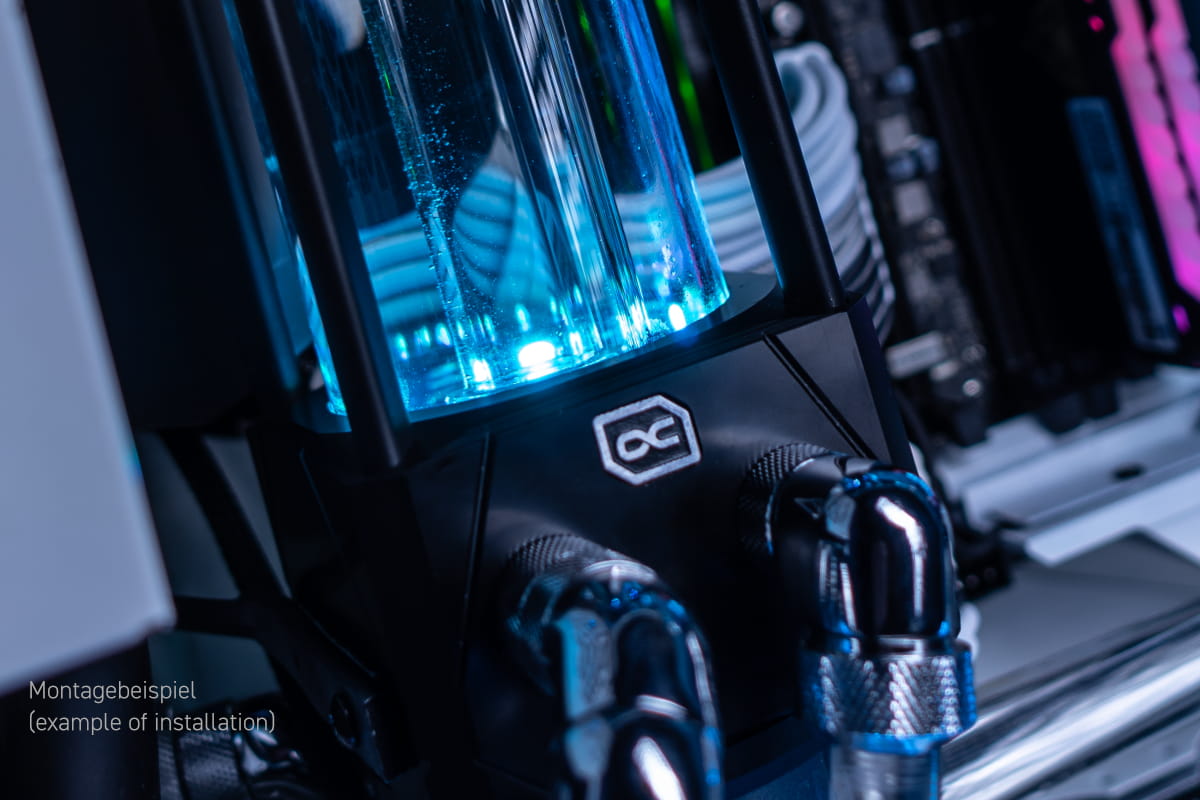

Extensive mounting options
Mounting option 1:
Stands are included in the scope of delivery, which, among other things, allow the expansion tank to be mounted on the bottom of the enclosure.
Mounting option 2:

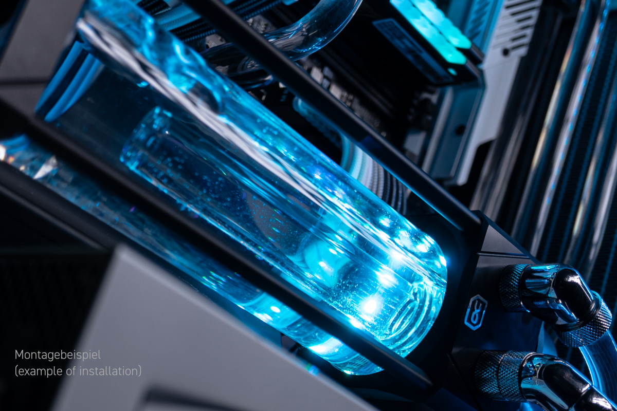

Included in the scope of delivery are 120mm/140mm mounting frames, which can be used to mount the Eisbecher Aurora expansion tank as desired on free fan spaces, radiators or on the fans on radiators.

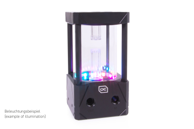

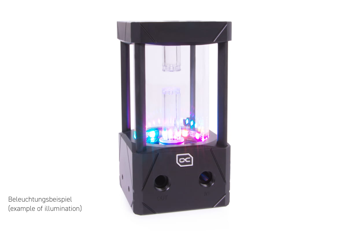

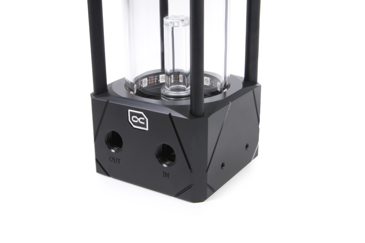

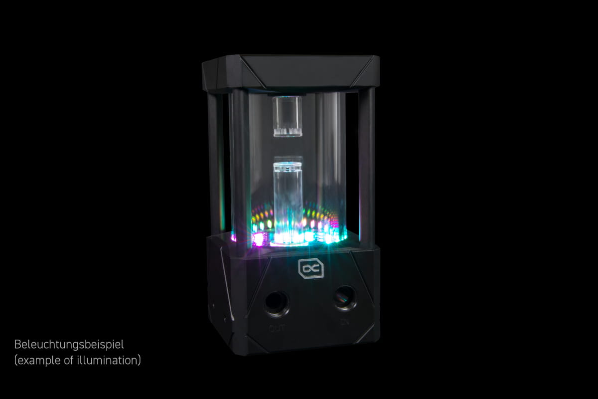

Digitally addressable RGB lighting
12 digitally addressable RGB LEDs illuminate the glass tube of the reservoir. They are mounted in a ring at the lower end of the tube in the transition to the pump top and provide brilliant illumination of the entire expansion tank. In combination with the Lighttower water effect, a very special ambience is achieved. The digital aRGB LED lighting is connected via a JST 3-pin connector and can be controlled with a digital RGB controller (e.g. Alphacool Aurora Eiscontrol, Art.15360) or a digital RGB capable mainboard.
A special water effect is created in the Eisbecher reservoir via the riser tubes. If you do not fill the reservoir beyond the top edge of the riser tube, you get a kind of fountain effect. In this case, the water is pushed out the sides of the riser tube and splashed against the glass tube. Depending on the flow of the circuit, the effect is stronger or weaker.
Pump

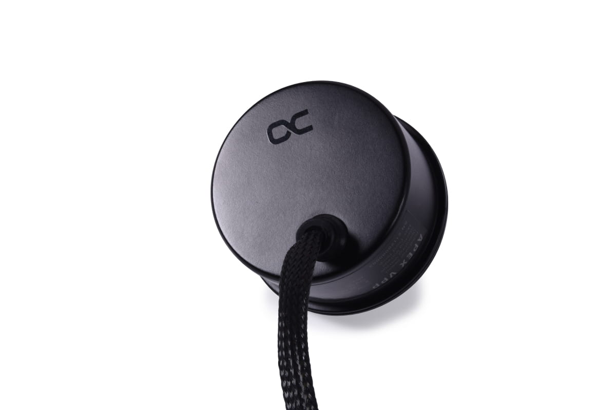

The VPP Apex pump does without a spherical bearing and uses a ceramic shaft. The motor's coils have been moved from the inside to the outside. These changes have the effect that the pump is fundamentally more stable and smoother running, and any vibrations that arise have been significantly
reduced. Another positive side effect is that power consumption has been almost halved as a result. Compared to Alphacool's Eispumpe, the power is not supplied via a 4-pin Molex connector. Instead, the Apex VPP pump is connected to the power supply using a SATA connector. The Apex VPP pump has a 4-pin fan connector that connects to the motherboard or to an external controller. This allows you to control the speed range of the pump via PWM and read out the RPM signal.
L x W x H142 x 77 x 77 mm
Pump compatibilityD5
Capacity180 ml
Material Pump top & coveracetal
Material tubeglass
Material framing baraluminium
Connection1x G 1/4 inner thread IN / 4x G 1/4 inner thread OUT
Pressure tested0.8 bar
Quantity of digital aRGB LEDs12
Power digital aRGB LEDs5 V
Power connector digital aRGB LEDs3-Pin JST + 3-Pin 5 V
Weight567 g
Technical data VPP Apex
Dimensions (L x W x H)65 x 65 x 41 mm
Material pumpsynthetic material
Material pump coveraluminium
Material axleceramics
Connections4-Pin PWM | SATA
Rotational speed2500-4500 rpm
Cable lenghts4-Pin PWM - 48 cm | SATA - 48 cm
Operating voltage8-13 V DC / 14 W IP32
Starting voltage12 V DC
Maximum pumping head4.25 m
Max flow340 L/h
Max working temperature60 °C
Net weight276 g
