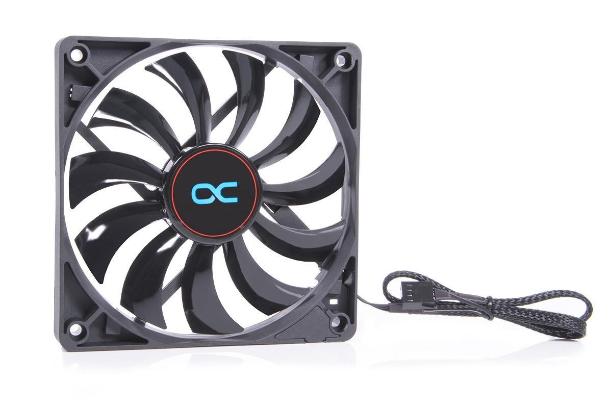

The Alphacool 120 mm SL-15 fan is a special slim fan for use on radiators. With a frame height... more

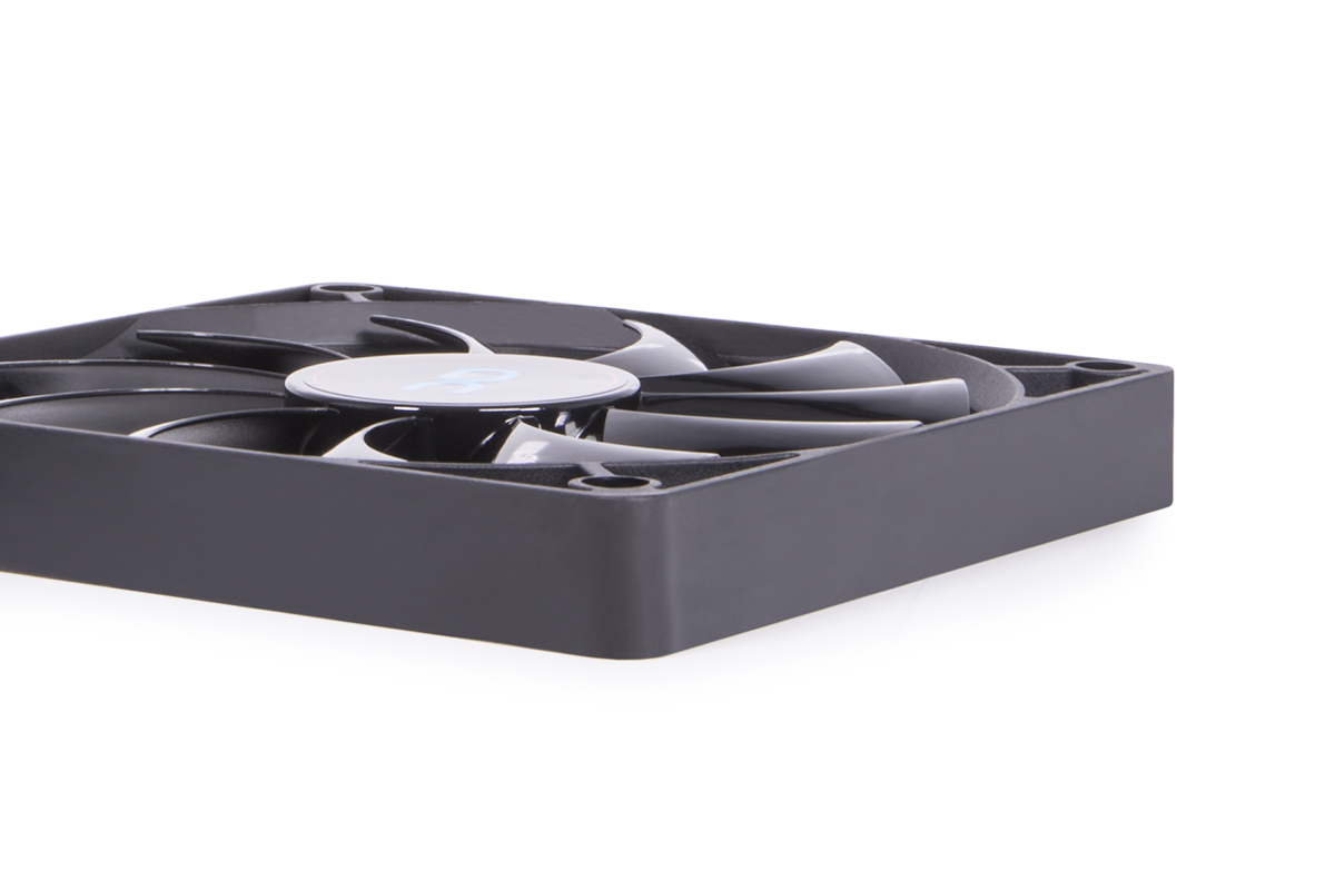

The Alphacool 120 mm SL-15 fan is a special slim fan for use on radiators. With a frame height of just 15 mm, it is particularly suitable for use in ultra-compact cases, also known as SFF cases.
Compact and powerful
With a frame height of just 15mm, the Alphacool 120mm SL-15 fan fits into almost any mini case. Despite the flat design, the 11 curved fan blades generate a high air pressure of 1.2mm H2O, a value that is not achieved by many normal 120mm fans. The classic fan frame also ensures that no air can escape to the side. This is especially important when used on a radiator. The volume flow can also compete with many normal 120mm fans with 25mm thick frames. At over 70m³/h, the SL-15 fan achieves an enormously high air throughput compared to similar fans. This makes it ideal as a case fan.
High control range
The fan is controlled via a 4-pin connection using PWM. With a speed range of 600 to 1800 rpm, the fan can always be ideally regulated. If the computer is only under light load, the fan can be run very slowly and thus almost inaudibly, while at full load you can get the performance you need. The 11 fan blades push a lot of air through the cooler or into or out of the case at any speed.
The Alphacool 120 mm SL-15 fan is part of Alphacool's new Core product line and offers high quality and performance with all the important features, without any other gimmicks.

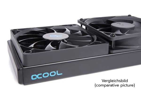

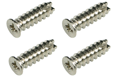

Note: To mount the fan on an Alphacool radiator you need M3x15 screws. The fan screws are countersunk in the fan frame.

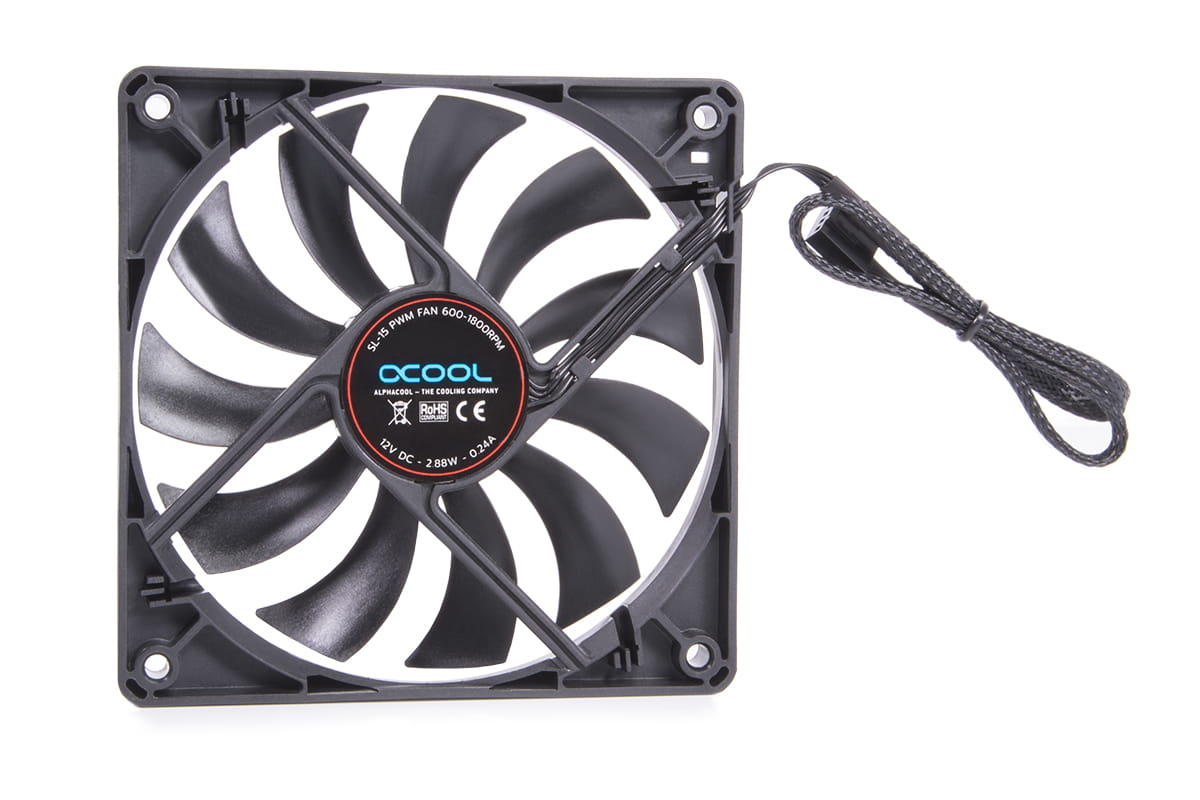

Technical data:
L x W x H: 120 x 120 x 15 mm
Speed: 600 - 1800rpm
Bearing: Double ball bearing
Connector: 4-pin PWM
Cable length: 35 cm
Operating voltage: 10.2 - 13.8V
Starting voltage Min.: 7V
Current consumption: 0.24A (2.88W)
Static pressure: 1.2 H2O
Air flow: 71.36 m³/h
Volume Max.: 32 dB(A)
MTBF: 50,000 hours
