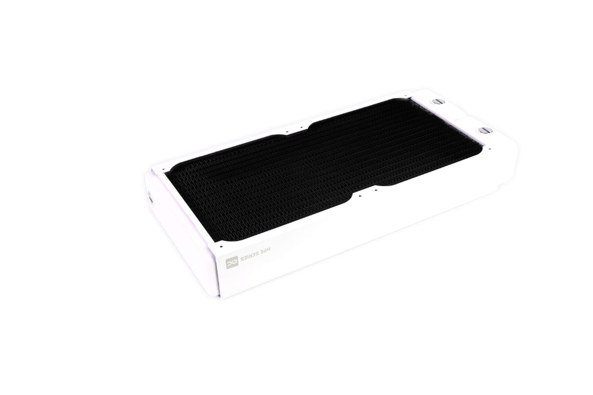

For more than a decade, Alphacool has dominated the market with its Full Copper radiator series.... more
For more than a decade, Alphacool has dominated the market with its Full Copper radiator series. Our extensive portfolio of radiator variants is unique worldwide, just like our manufacturing process, which enables us to craft all water-bearing parts and cooling fins from pure copper. Thanks to their exceptional performance, these radiators can effortlessly dissipate even extremely high waste heat, making them indispensable in many sectors of the cooling industry.
The next step in evolution: HPE Full Copper Radiator!
The Full Copper HPE Radiator uses the same materials as the previous NexXxoS models but takes a technical step forward. With a denser internal structure, the number of water channels and copper fins has been increased. This design ensures a larger water volume is in direct contact with the cooling fins, significantly enhancing heat transfer. The increased number of fin rows and their shortening also results in a much more efficient utilization of the cooling surface. Comparison tests with the conventional NexXxoS radiator have demonstrated that the HPE radiator can achieve a performance improvement of 4.5K. At higher ambient temperatures and fan speeds, the performance gap between the HPE and standard NexXxoS radiators increases progressively, with possible performance gains of up to 6K.
Connection options & mounting

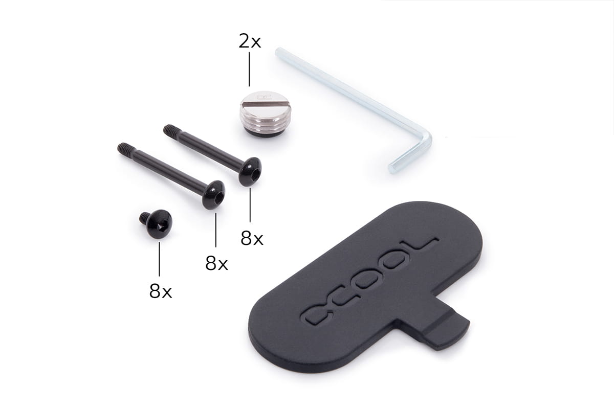

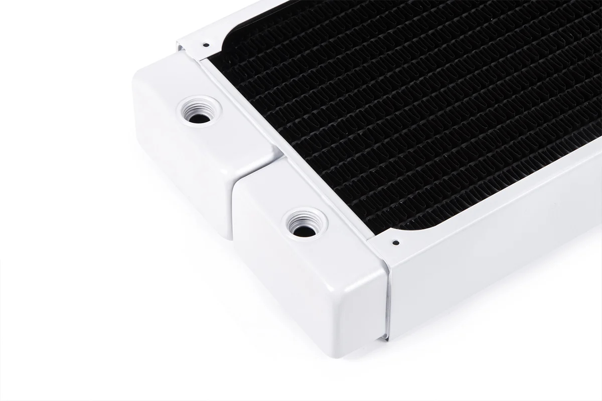

The HPE radiator features two IN or OUT connections with G1/4" threads in the pre-chamber area. On the opposite side, there is a fill or drain port for filling and draining the water circuit. The radiator comes with all necessary screws for case and fan installation. Additional screws are typically not required.
Safety first
The HPE radiator is equipped with special protective plates beneath all mounting holes to prevent screws from being inserted too deeply. This ensures the cooling fins and water channels underneath are protected from damage.

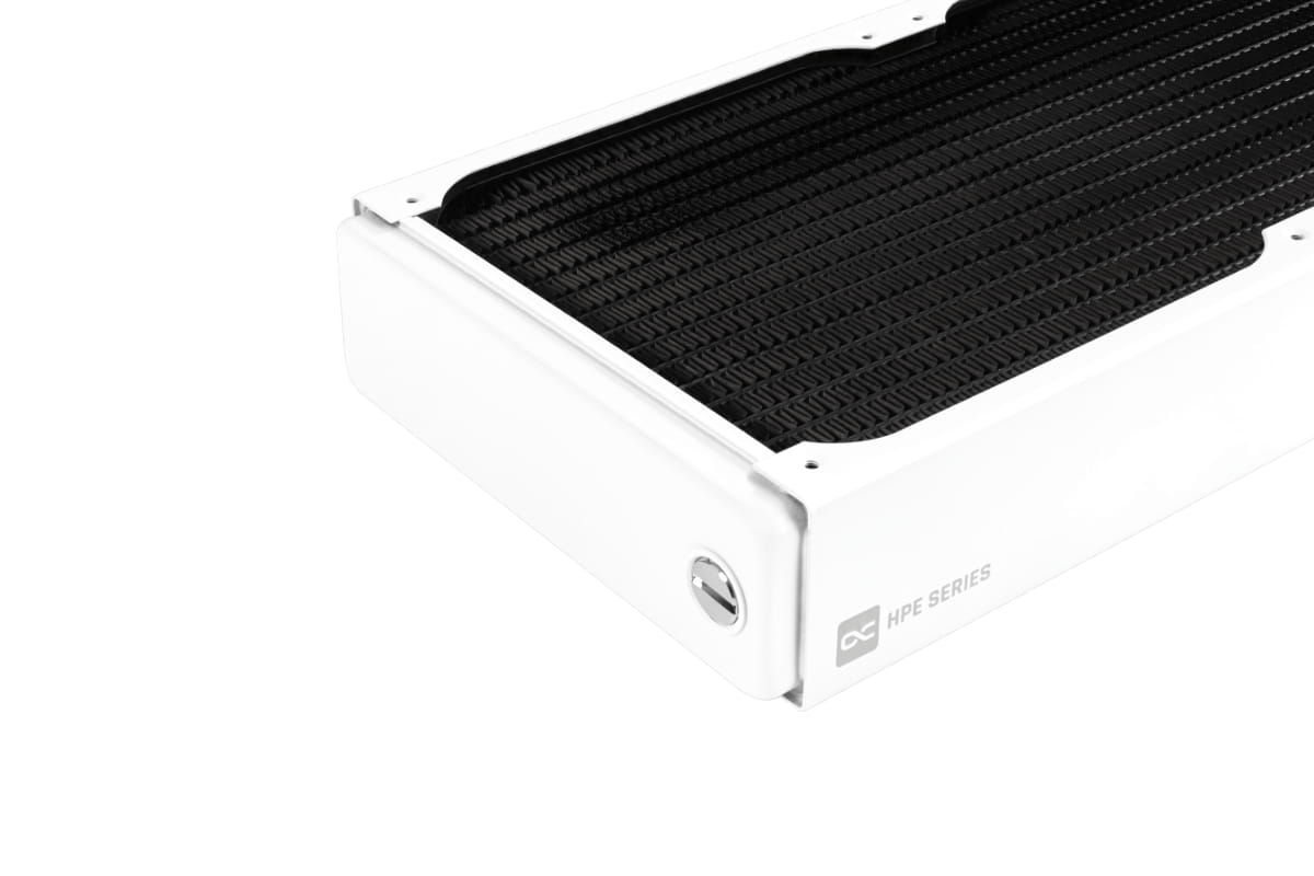

Patented screw plugs
All HPE radiators use Alphacool's patented screw plugs. Protruding screw plugs often prevent the radiator from being installed flush. Alphacool's screw plugs are fully recessed into the radiator, flush with its surface, allowing for easy and seamless installation in the case.
Dimensions (L x W x H)314.5 x 144 x 45mm (+/- 3%)
Quantity of cooling channels28
Material threadsbrass
Threads4x G1/4" IN/OUT & 1x Fill-/Drainport G1/4" (max. 5mm thread length)
Possible fan size140mm
Possible fan assembly2x one-sided / 4x both-sided
Thread size fan mountingM3
Pressure tested0.8 Bar
Fin density16 FPI
Weight1130g
Colorwhite
