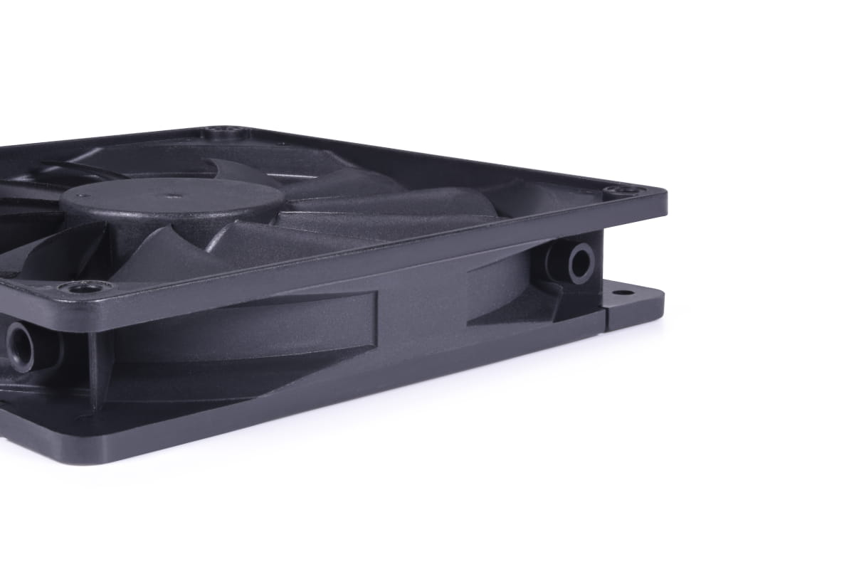

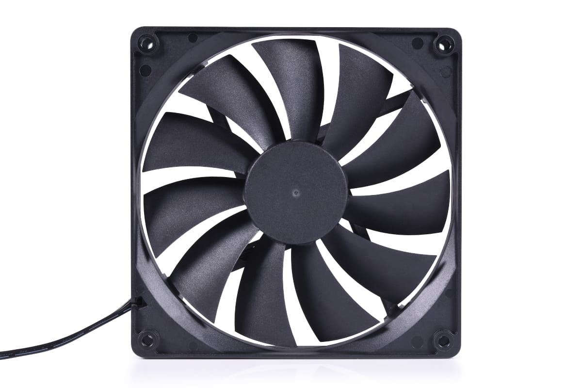

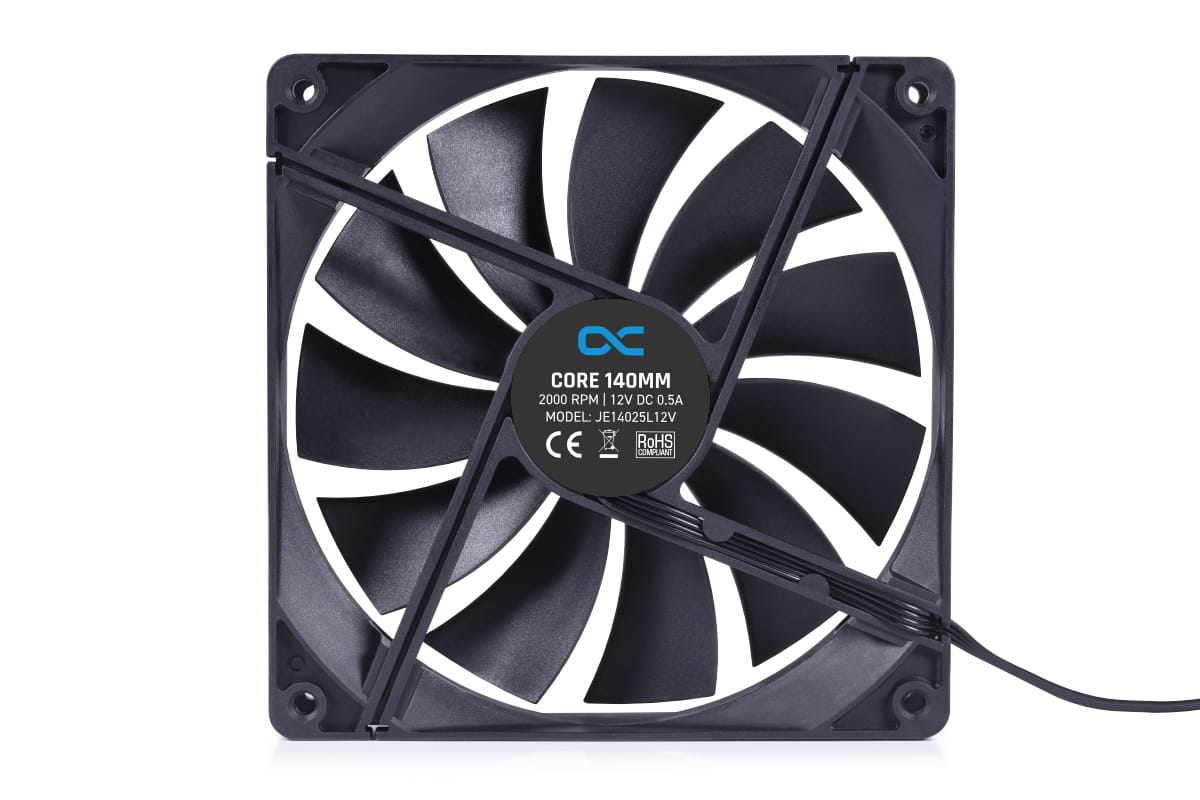

Alphacool's Core 140mm is a quiet and efficient fan with a wide control range up to 2000 rpm. The PWM controllable fan is not only suitable as a fan on CPU coolers or radiators. Due to its excellent performance values (throughput & static pressure), it can also be used as a case fan. The hydraulically mounted fan axis is smooth running and enables a long service life as well as quiet operation. If you are looking for a powerful fan without aRGB illumination, you will find it in Alpacool's Core 140mm model!

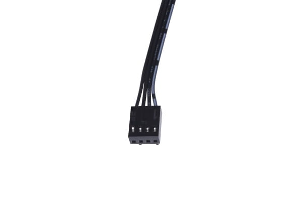

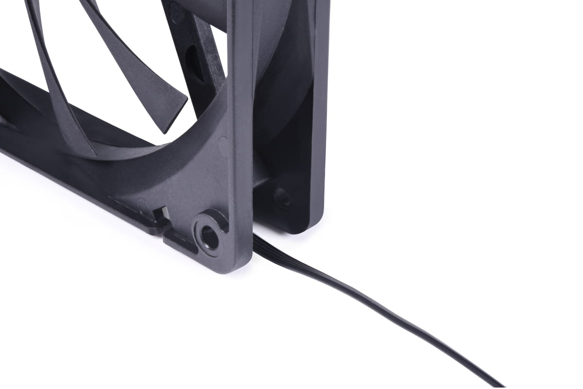

Connections
The fan is controlled via a 4-pin PWM connector. The cable is 40cm long. This allows the fan to be connected directly to the motherboard or a dedicated controller without the use of additional adapter cables or extensions.

| Technical data | |
| Dimension (L x W x H) | 140 x 140 x 25 mm |
| Material | synthetic material (PBT UL94V-0) |
| Bearing Type | hydraulic Bearing |
| Rated Voltage | DC 12 V |
| Operating Voltage | DC 7-14 V |
| Start-up Voltage | 7 V |
| Rated Current | 0.45 (Max: 0.5) A |
| Rated Power | 5.4 (Max: 6.0) W |
| Control Range | 0-2000 rpm ±10 % |
| Max. Air Flow | 103.03 CFM |
| Max. Static Pressure | 2.81 mmH₂O |
| Noise level | 38.3 (Max: 40.0) dBA |
| Life Expectance | 50 000 h at 25 °C |
| Connection | 4-Pin PWM |
| Speed Control Mode | via PWM |
| Operating Temperature | -10 to +55 °C |
| Other Features | Tachometer Output, Auto Start, Soft Start, Waterproof Level IP22 |
