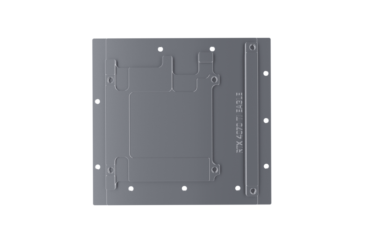

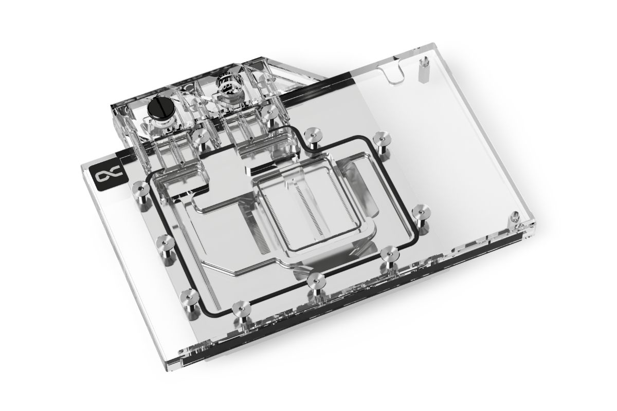

The next generation - the Alphacool Eisblock Aurora water cooler for Geforce RTX 40XX graphics... more
The next generation - the Alphacool Eisblock Aurora water cooler for Geforce RTX 40XX graphics cards. In order to dissipate the enormous heat of this graphics card generation in the best possible way, numerous optimizations have been made to the water cooler compared to the previous model. The fin structure was adapted and enables a very good water flow while increasing the cooling surface. The modified jet plate with improved inflow engine ensures an optimal distribution of the water on the cooling fins.

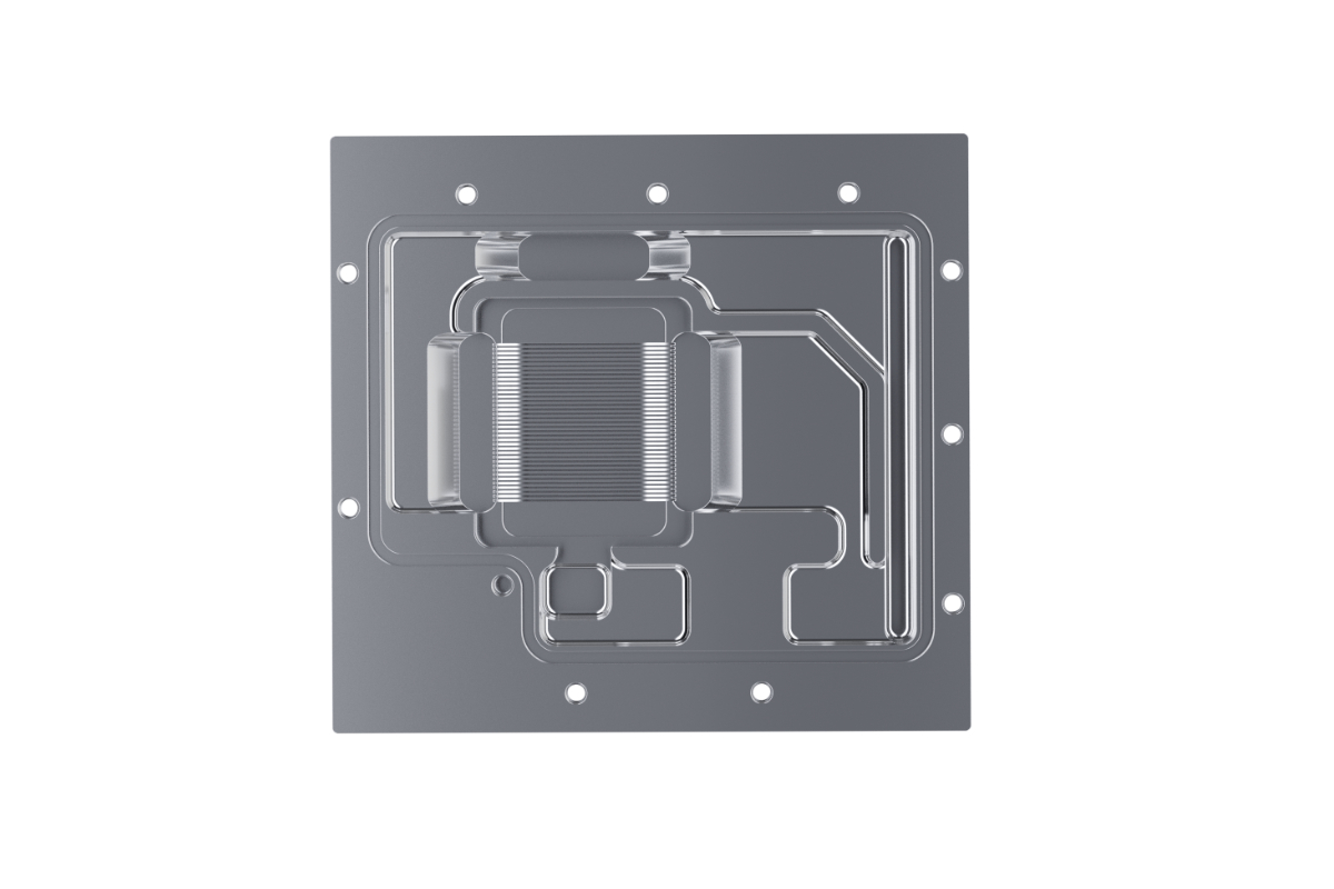

Technical Highlights
The fin structure of this Eisblock cooler generation was developed together with Nvidia board partners. The fin thickness is 0.4 mm, the distance between the cooling fins is 0.4 mm. This ensures a very good water flow while increasing the cooling surface. The jet plate has a revised inlay that spreads the water pressure better over the fins thus optimizing the heat absorption. The adjusted water inflow gives the water a better angle of inflow.
Chrome-plated copper
Design
The Aurora design of the Geforce RTX 40XX Eisblock generation is visually calmer and simpler. Only one O-ring runs around the entire cooler. The design around the cooling fins and jetplate makes for a cleaner look. The illumination of the digitally addressable RGB LEDs is even better distributed throughout the cooler as a result of the chrome plating. The terminal's design is in line with the classic Aurora design.
Thermal paste & thermal pads
The included thermal compound is Alphacool's Subzero. With a thermal conductivity of 16 W/mK, it is one of the highest performing thermal pastes on the market. The electrically non-conductive thermal compund is particularly well suited for high contact pressures, but can still be processed perfectly due to its viscosity of 850,000 TF. Alphacool Soft Pads with 0,5mm thickness are used on the voltage converter and the graphics memory. The thermal conductivity of the pads is 7 W/mK. The pads for the back of the PCB are 3mm thick and have a thermal conductivity of 3 W/mK.

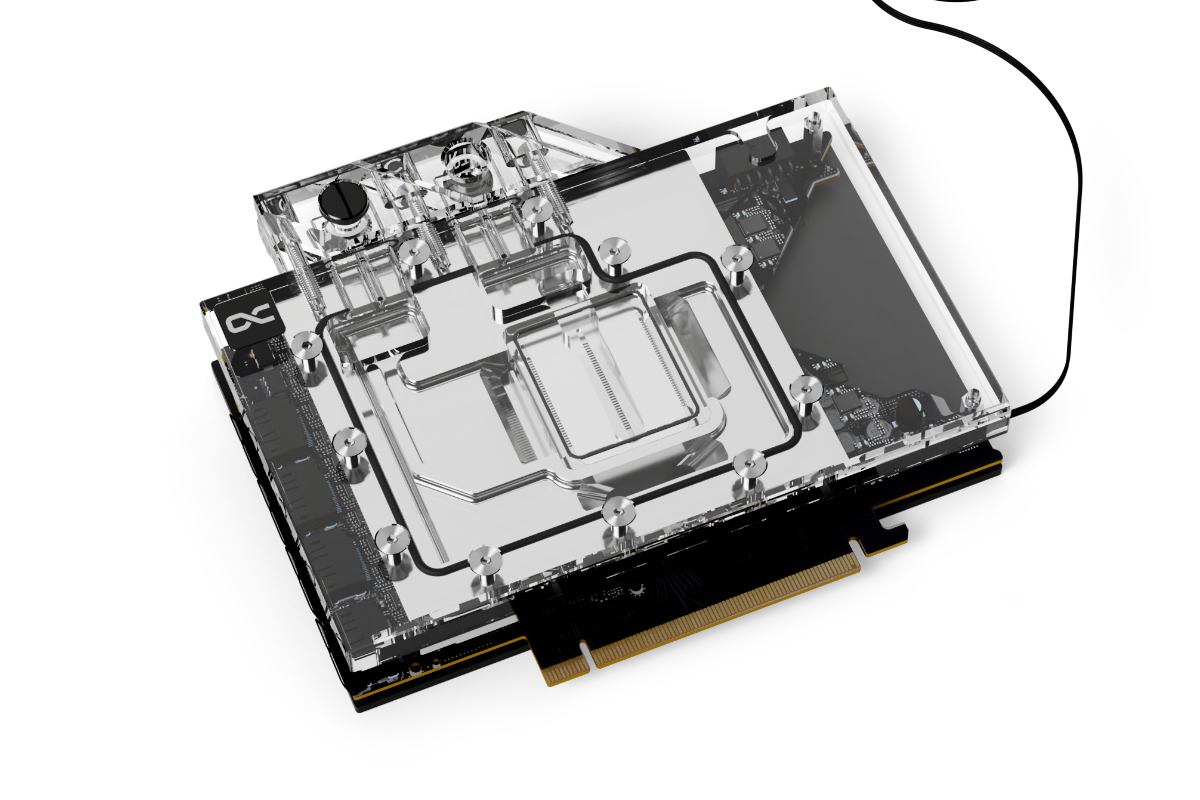

- Gigabyte GeForce RTX 4070 Ti Eagle 12G, 12GB GDDR6X (GV-N407TEAGLE-12G)
- Gigabyte GeForce RTX 4070 Ti Eagle OC 12G, 12GB GDDR6X (GV-N407TEAGLE OC-12G)
- Gigabyte GeForce RTX 4070 Ti Gaming OC 12G, 12GB GDDR6X (GV-N407TGAMING OC-12GD)
- Gigabyte GIGABYTE GeForce RTX 4070 Ti Aero OC 12G, 12GB GDDR6X, HDMI, 3x DP (GV-N407TAERO OC-12GD)
- Gigabyte GeForce RTX 4070 Ti SUPER Gaming OC 16G, 16GB GDDR6X (GV-N407TSGAMING OC-16GD)
Technical data cooler
Dimensions (L x W x H)176,60 x 134,00 x 34,40mm
Material cooler topacrylic
Max working temperature60°C
Pressure tested0,8 bar
Threads4 x G1/4"
Thickness cooling fins0,4mm
Distance cooling fins0,4mm
Illuminationdigital aRGB LEDs
Power digital aRGB LEDs5V
Number of digital aRGB LEDs13
Colortransparent

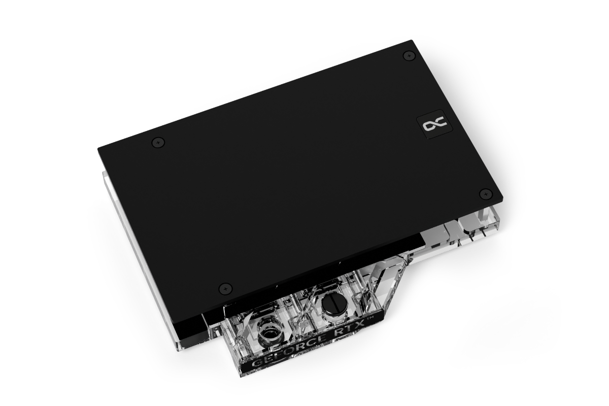

Technical data backplate
Dimensions (L x W x H)176,60 x 109,50 x 6mm
Materialaluminium
