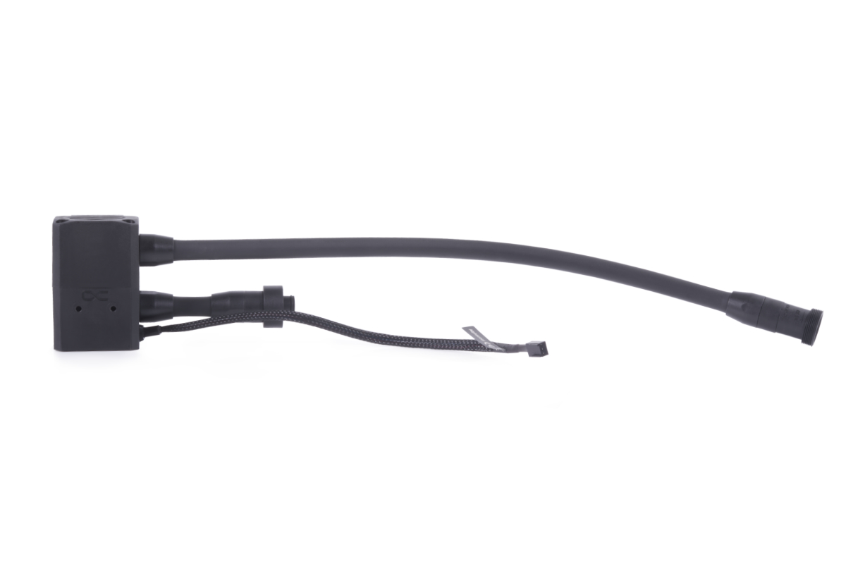

IThe DC80 AIO Power Unit pre-filled Eisstation fulfils two important functions. It can be used... more
IThe DC80 AIO Power Unit pre-filled Eisstation fulfils two important functions. It can be used as a filling aid for all Alphacool AIO systems or as a booster for more pump power if the loop is to be expanded with several components.

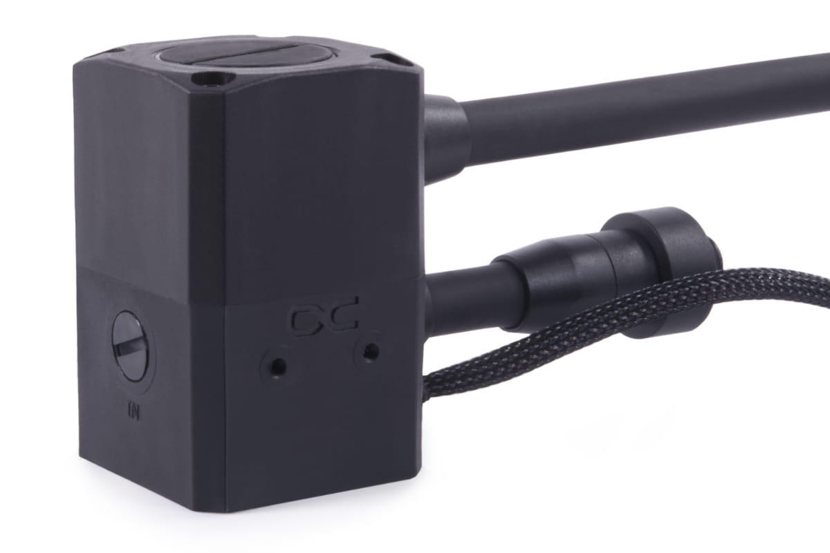

Structure
The Eisstation DC80 Power Unit consists of the Eisstation DC80, a reservoir with integrated pump top, and a DC-LT 2 pump. Connected to this are two TPV hoses, each with a male and female quick-release connector at the end. These quick connectors are compatible with all Alphacool AIO systems for graphics cards and processors.
Filling aid
If you want to refill your AIO system, you can connect it directly to the power unit via the existing quick-release fasteners in a simple and uncomplicated way. All that is needed to fill it is to open the large G1" screw plug. The integrated DC-LT 2 pump ensures sufficient pressure to pump the coolant into the AIO. Ideally, the AIO pump should only be run when there is already enough coolant in the system. This prevents the AIO pump from running dry during the filling process.
Power Unit?
Adding several components to an Alphacool AIO can quickly lead to the existing DC-LT 2 pump reaching its performance limit. If the Power Unit is additionally integrated into the circuit, the additional DC-LT 2 pump provides more power to operate a larger loop.
Mounting
An extremely adhesive Velcro fastener is included in the scope of delivery, which allows positioning anywhere in the case. The optionally available Alphacool mounting accessories allow even more mounting options.
