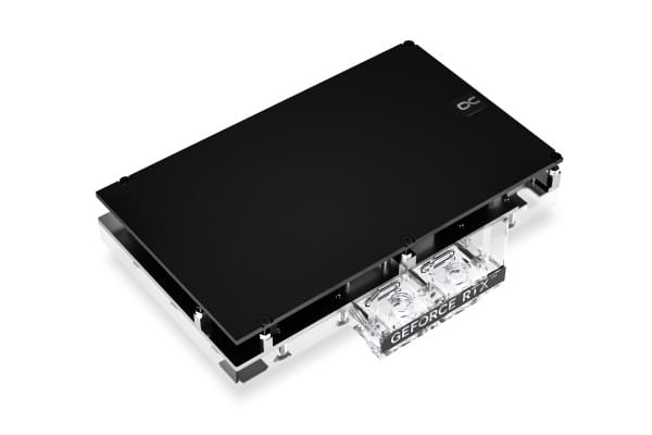

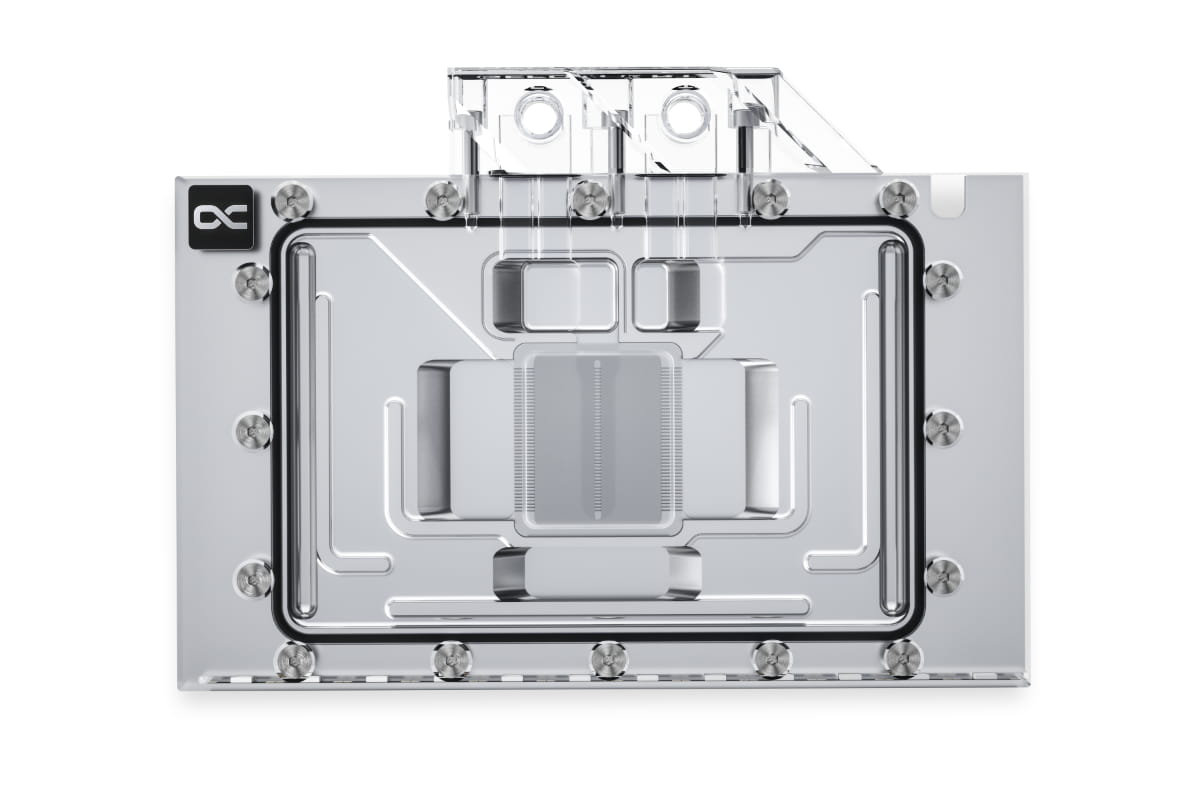

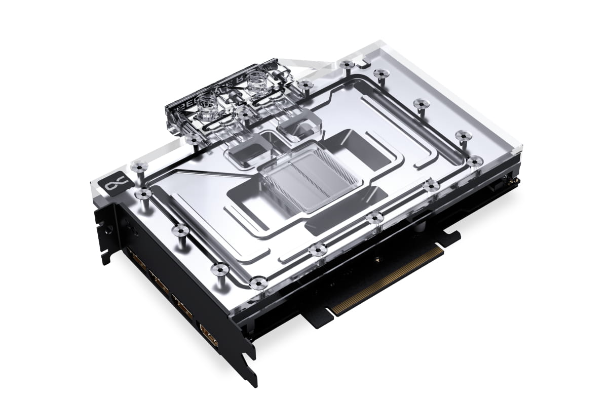

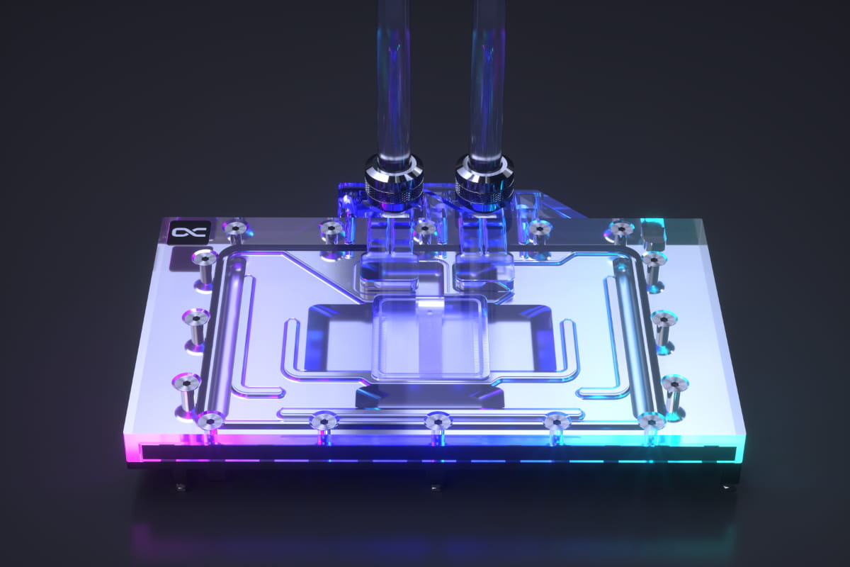

The next generation - the Alphacool Eisblock Aurora water cooler for Geforce RTX 4XXX graphics cards. In order to dissipate the enormous heat of this graphics card generation in the best possible way, numerous optimizations have been made to the water cooler compared to the previous model. The fin structure was adapted and enables a very good water flow while increasing the cooling surface. The modified jet plate with improved inflow engine ensures an optimal distribution of the water on the cooling fins.
Important note: The RTX 4080 Eisblock Aurora Reference cooler is not compatible with Nvidia's Geforce RTX 4080 Founders Edition.
Technical Highlights
The fin structure of this Eisblock cooler generation was developed together with Nvidia board partners. The fin thickness is 0.4 mm, the distance between the cooling fins is 0.4 mm. This ensures a very good water flow while increasing the cooling surface. The jet plate has a revised inlay that spreads the water pressure better over the fins thus optimizing the heat absorption. The adjusted water inflow gives the water a better angle of inflow.
Chrome-plated copper
Design
The Aurora design of the Geforce RTX 4XXX Eisblock generation is visually calmer and simpler. Only one O-ring runs around the entire cooler. The design around the cooling fins and jetplate makes for a cleaner look. The illumination of the digitally addressable RGB LEDs is even better distributed throughout the cooler as a result of the chrome plating. The terminal's design is in line with the classic Aurora design.

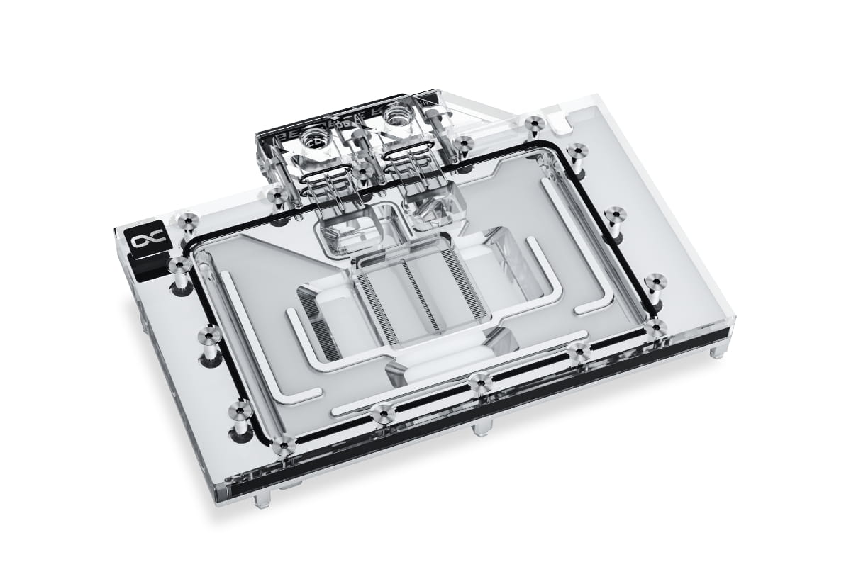

| Technical data cooler | |
| L x W x H | 198.41 x 144.69 x 34.40 mm |
| Material cooler | chrome-plated copper |
| Material cooler top | acrylic |
| Max working temperature | 60 °C |
| Pressure tested | 0.8 bar |
| Threads | 4 x G 1/4 |
| Thickness cooling fins | 0.4 mm |
| Distance cooling fins | 0.4 mm |
| Illumination | digital aRGB LEDs |
| Power connector digital aRGB LEDs | 3-Pin JST |
| Power digital aRGB LEDs | 5 V |
| Number of digital aRGB LEDs | 12 |

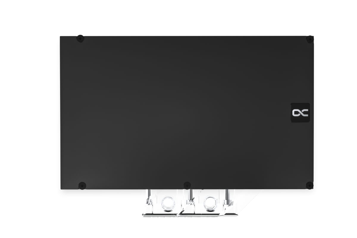

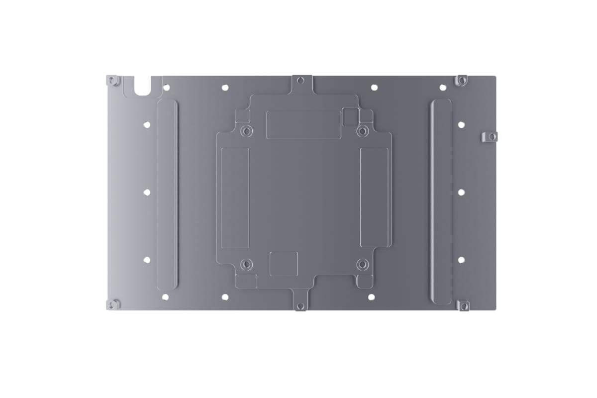

| Technical data backplate | |
| L x W x H | 198.41 x 120.19 x 6 mm |
| Material | aluminium |
| Color | black |
