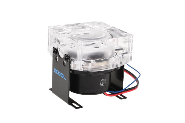

Alphacool's attachment for the Laing D5 is now a member of the Eisdecken series and receives an... more
Alphacool's attachment for the Laing D5 is now a member of the Eisdecken series and receives an update.
This attachment has been a benchmark for years. Small improvements have been made time and again. The second major update differs in a few details, both visually and technically.
The principle: There is space for the Laing D5 or VPP655 on the bottom and inlet and outlet at the front or on the top.

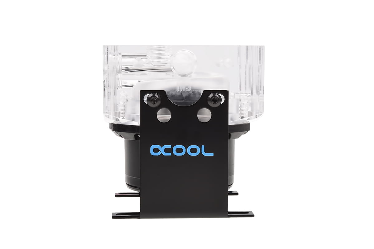

For even more flexibility, the ice cover has three inlets and two outlets. Another feature is the new bracket to give the whole unit a stable stand and round off the overall visual appearance. Installation in a 3.5" slot is also possible as an option.

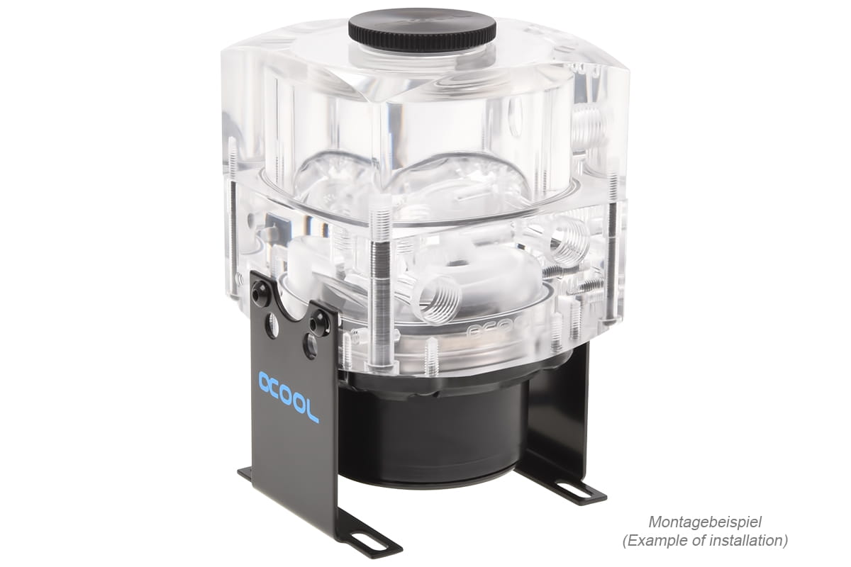

The attachment can be converted into a complete expansion tank using the expansion tank attachment available as an accessory, which has also been redesigned.
For all case modders, the acrylic glass attachment has four holes for 5mm LEDs!
  • Dimensions: 80 x 80 x 40mm
  • Dimensions with feet: 83 x 80 x 87mm
  • Material: Acrylic
  • Connections: 5x 1/4" thread

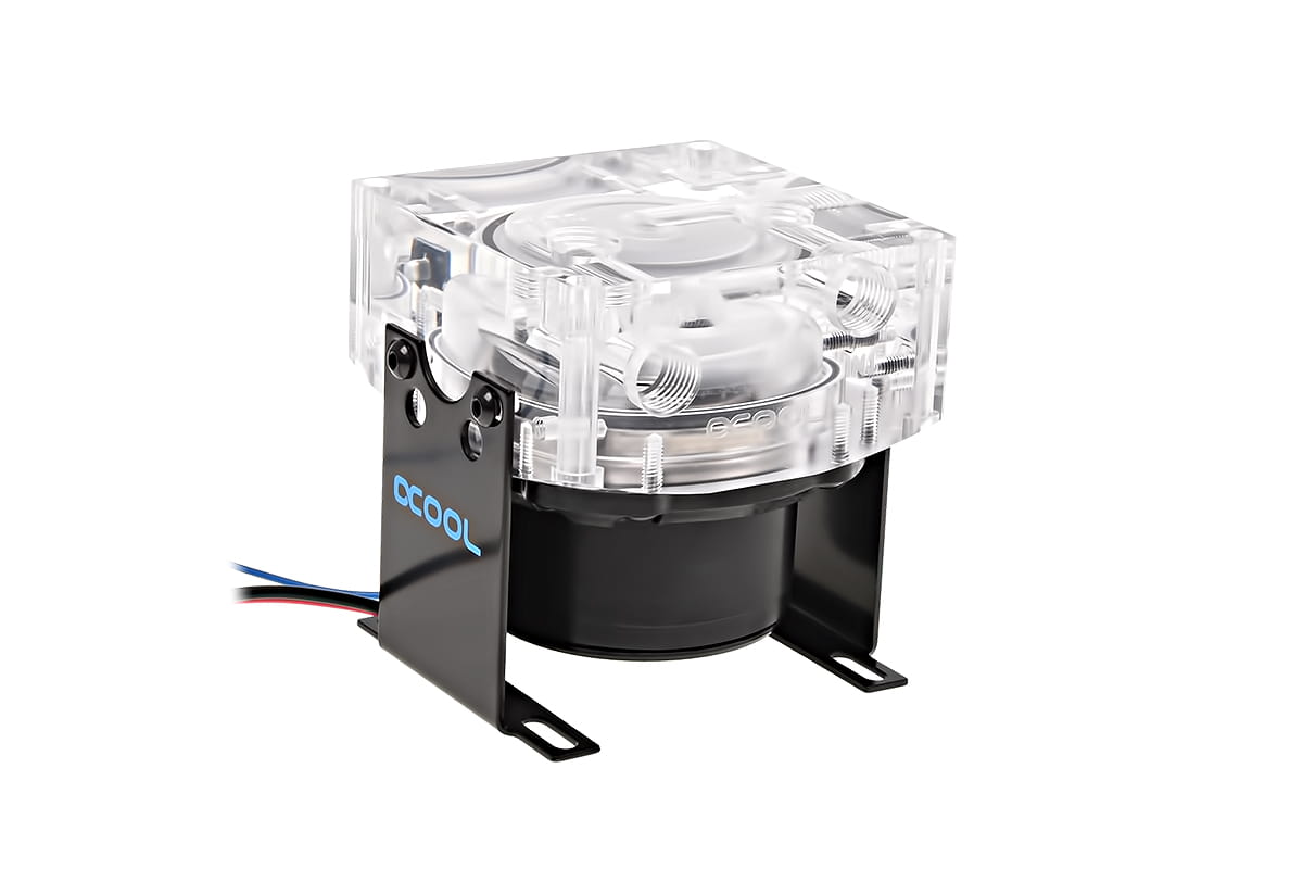

Alphacool VPP 655
Alphacool's new power pump series, unique performance at an unbeatable price. The 12V pumps can simply be connected to the power supply and the pump starts up together with the computer! This ensures maximum comfort and the greatest possible safety.
This pump is ideal for water cooling PCs and other electronic components. The DC motor pump is equipped with an electronically commutated spherical motor. In a pump with a spherical motor, the only moving part is a spherically shaped rotor, which in this case rests on a bearing ball made of ultra-hard and wear-resistant ceramic. The spherical bearing of the rotor offers a number of advantages: For example, an increase in bearing play is not possible due to the design, and the pump will always run consistently quietly and smoothly. Separate magnetic shielding is also not necessary with this pump. The spherical motor principle allows efficient operation with excellent performance. All parts of the pump are completely corrosion-resistant. The pump is simply operated on a 12V Molex connection of the PC power supply.
The special feature of this model is that only the pump core is supplied. Why not? If you want to connect the pump to an alternative cover or expansion tank anyway, why should you pay more for everything else? Another feature is located on the back; with a small turning movement, the pump can be regulated to 5 different pumping levels.
  • Dimensions (WxHxD): 65x65x57mm (without connections)
  • Motor: Electronically commutated spherical motor
  • Standard voltage: 12V DC
  • Power consumption: 23W
  • Allowed voltage: 8-24V DC
  • Pressure at 12V: 3.7m water column
  • Maximum flow: 350l/h
  • Pump medium: water, water/glycol mixture
  • Maximum system temperature: 60°C
  • Related materials: Stainless steel 1.4571, PPS-GF40, EPDM O-rings, aluminum oxide, hard carbon
  • Special features: Adjustable in five levels
  • Level 1: 1800 rpm
  • Level 2: 2550 rpm
  • Level 3: 3300 rpm
  • Level 4: 4050 rpm
  • Level 5: 4800 rpm
  • Power connector: 4 pin Molex
