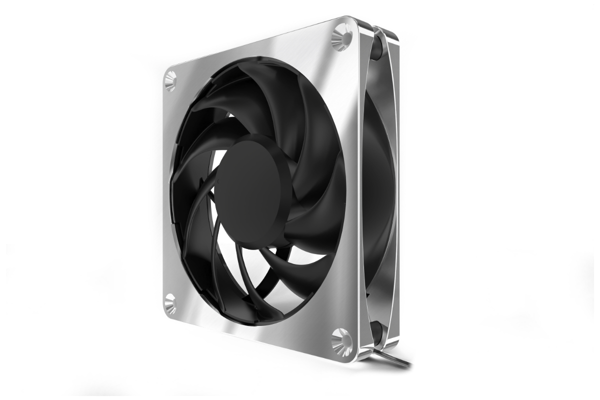

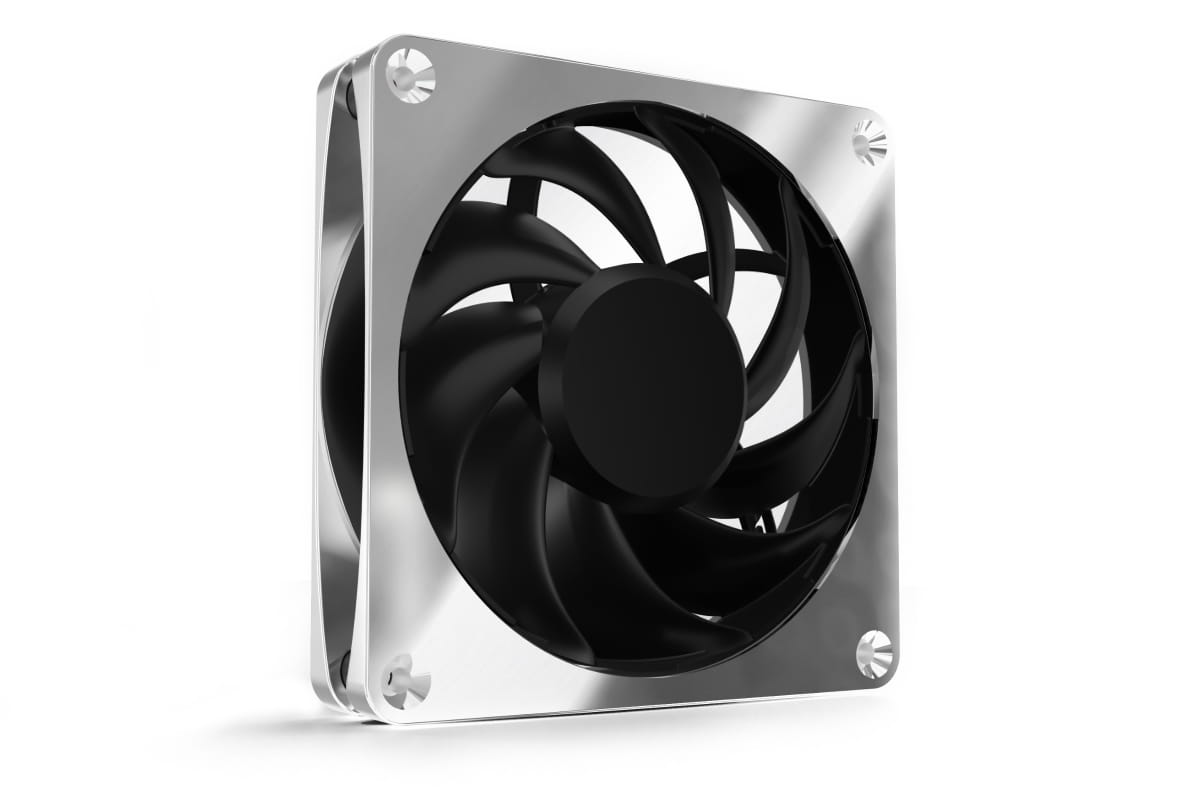

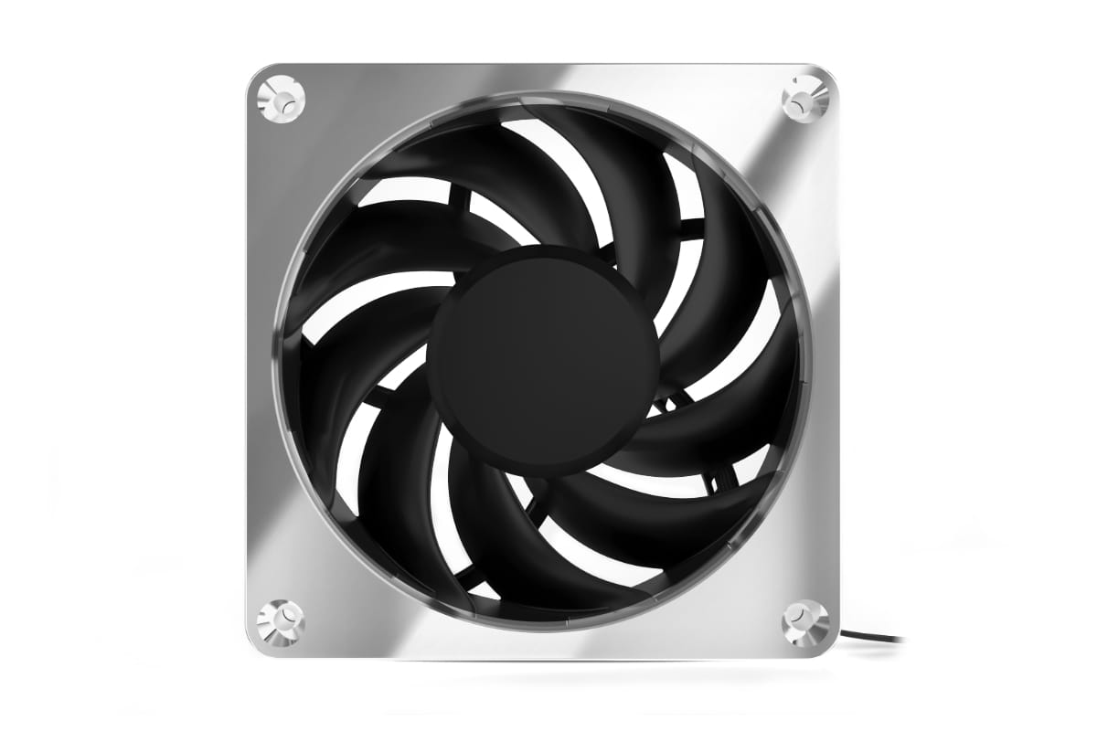

High-quality, elegant as well as timeless design and technical innovation - these are the features of the Alphacool Apex Stealth metal fan. With its patent-pending decoupling technology, the robust metal frame and a special rotor, this fan certainly impresses. Not only is the Apex Stealth one of the most powerful fans, but it also remains the quietest at any speed.
Whisper Quiet
The fan blades, motor and its suspension are completely decoupled from the metal frame. For this purpose, a special damping system was placed between the metal frame and the fan, which absorbs all vibrations. This type of decoupling is a completely new system, which is brought to the market by Alphacool for the first time with the Apex fan. In addition, the impeller is equipped with a closed frame that prevents the impeller tips from fluttering at high speed, which also has a positive effect on the fan's characteristics.
Powerful All-rounder
The Alphacool Apex Stealth metal fan is a true all-rounder. It sets new standards in terms of airflow and static pressure. Therefore, this fan is not only perfect for mounting on radiators, but also provides excellent airflow as a case fan. The Apex Stealth Power can be controlled between 400 to 3000 rpm via the 4-pin PWM connector. The startup speed is ~500 rpm. In addition, the Stealth offers Zero RPM control, which can be used to bring the fan to a complete stop.

Alphacool's Apex product line represents the highest level of perfection. First-class materials and innovative technologies guarantee a unique premium product. Consisting of high-quality metal, the curved frame gives the Apex Stealth its distinctive design and fits perfectly into any PC build.

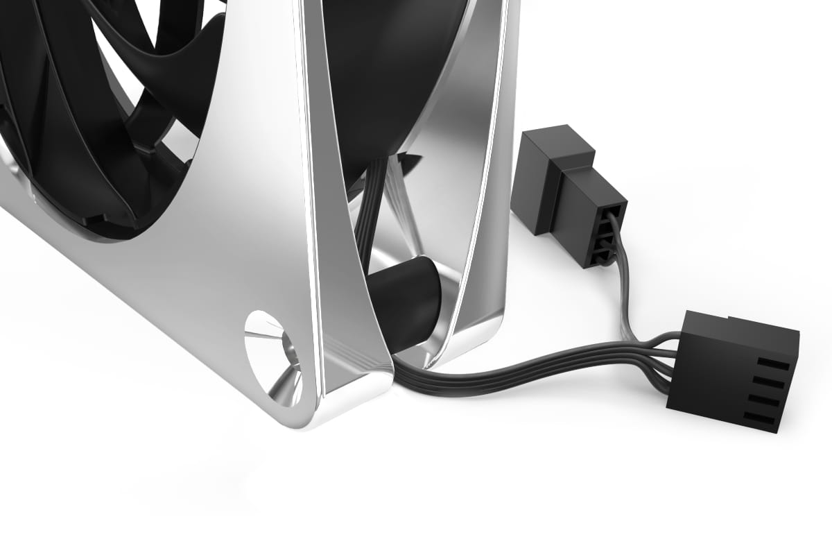

As usual with Alphacool, multiple fans can be effortlessly connected in series via daisy chain. The cables can be hidden in the corners of the fan so that they are no longer visible. A 50 cm PWM cable is also included as an extension. The 6-pole motor in combination with the HDB bearing (Hydro Dynamic Bearing) ensures extremely quiet operation and high durability.

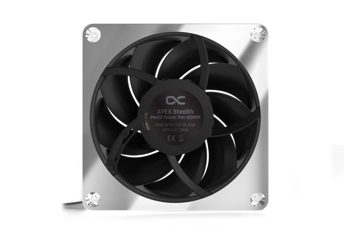

Dimensions (L x W x H)120 x 120 x 25,5mm
Material (Frame)Die-cast zinc
Material (Impeller)Plastic
Weight320g
Speed400~3000±10% rpm
BearingHydro Dynamic Bearing
Connection4-Pin PWM
Cable length PWM40±8 mm (+ 50cm extension cable)
Cable length (daisy chain)110±10 mm
Start-up Voltage6 V DC
Rated Volt12 V DC
Power Consumption6.60 Watt
Rated Current0.50 A (0.55Max)
Air Flow70.98 CFM
Static Air Pressure4.23 mmH2O
Noise Level40.1 dBA
MTBF100,000h
PWM controlYes
Zero RPM controlYes
Tacho SignalYes
Auto-restartYes
