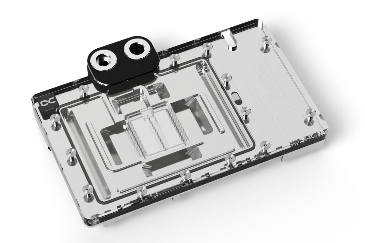

Alphacool's Core product series is characterized by high quality, outstanding performance and... more

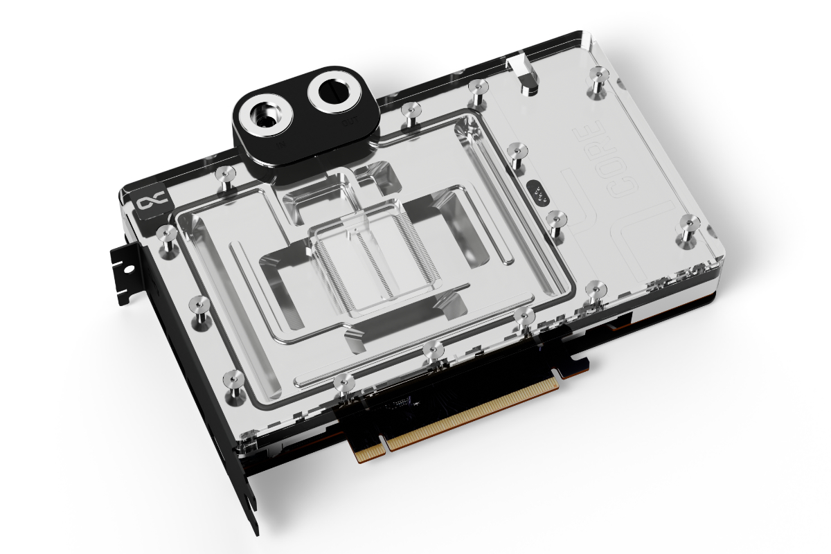

Alphacool's Core product series is characterized by high quality, outstanding performance and the uniform and functional design language.

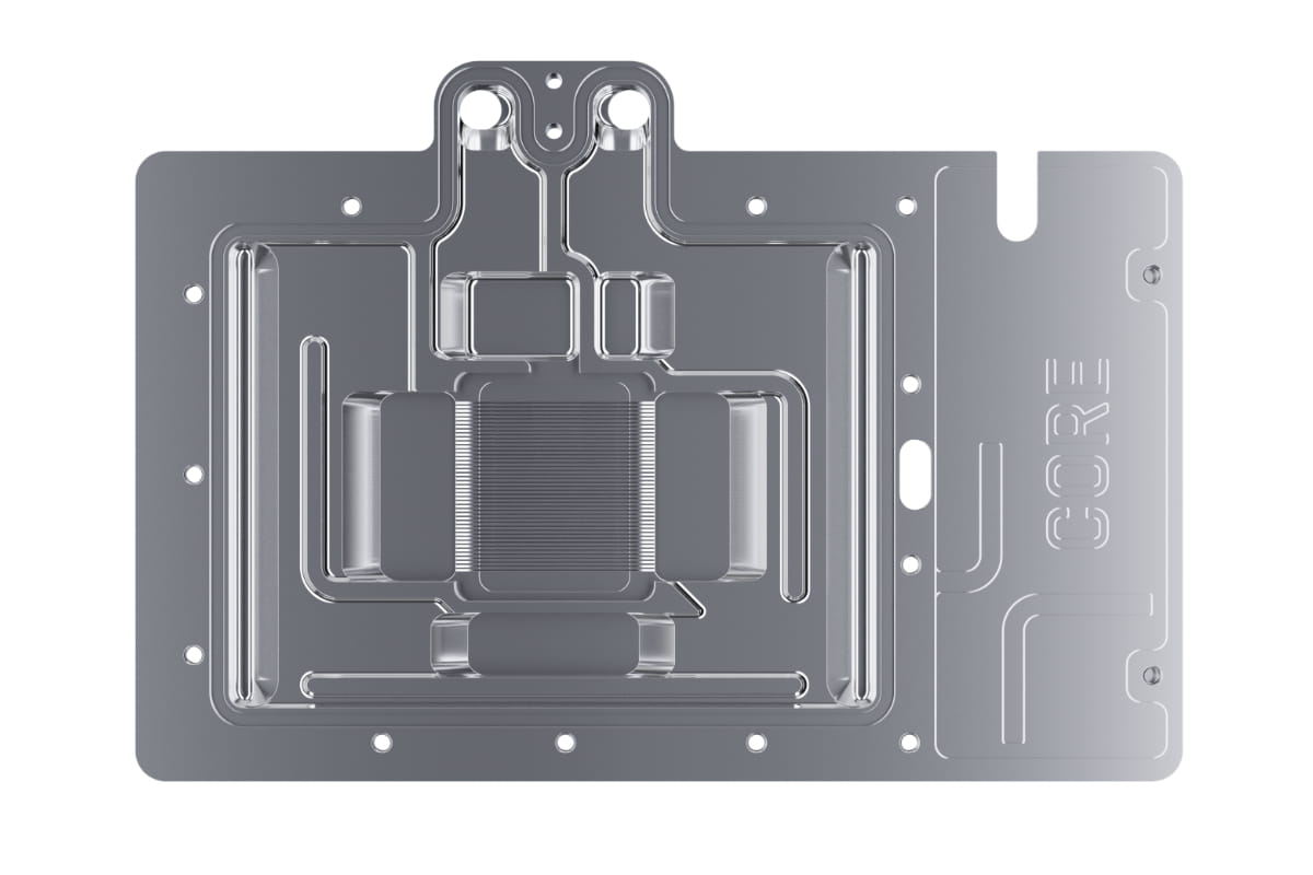

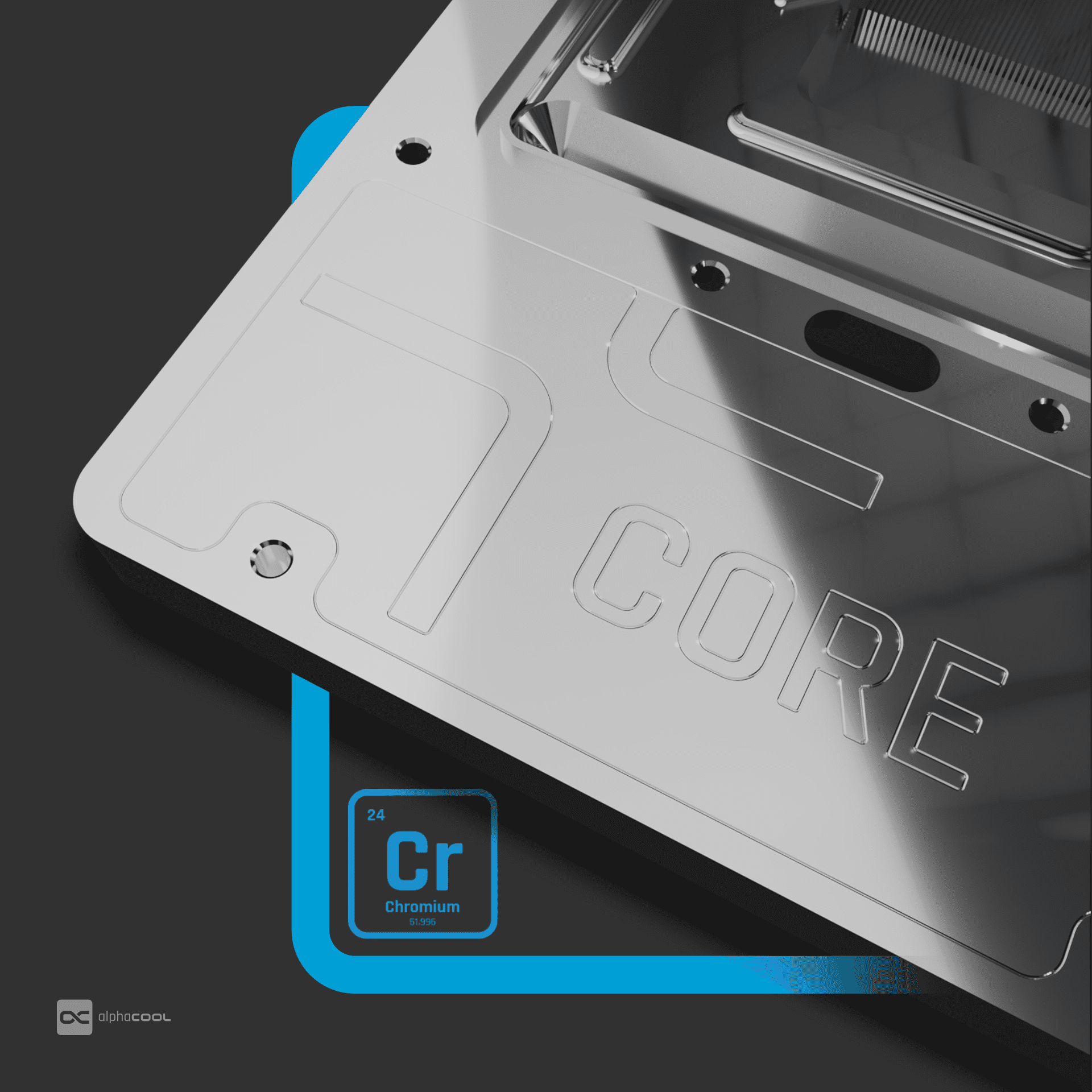

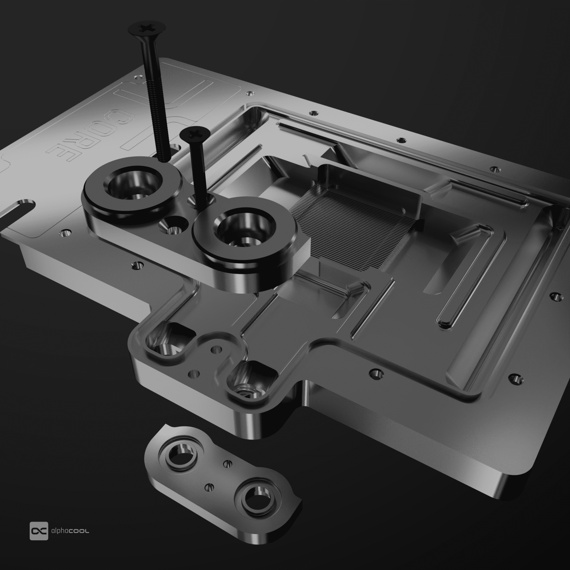

The copper cooler which, like the end terminal, is milled from a single piece of copper and is the core of this cooler. The fine workmanship, paired with the hard and resistant chrome plating covering the entire copper cooler, meet the highest quality standards. The chrome-plated brass G1/4" threads integrated on both sides stand out visually from the terminal. They are a central feature of the new design language that will be evident in all products in the Core series.
The aluminum backplate adapted to the design, together with the terminal, makes up the entire unit and enhances the back of the cooler with a clean and homogeneous look. The lighting consists of digitally addressable RGB LEDs, which illuminate the entire cooler evenly and effectively.
The technical advancements can be seen in the water supply to the jet plate as well as in the optimization of the jet plate itself. The jet plate has been completely redesigned based on many simulations and practical tests in cooperation with board partners. The fin thickness and spacing have been enhanced, the cooling surface has been increased and the water flow to the core components with the greatest heat output has been optimized. The enclosed special soft thermal pads with up to 7 W/mK adapt perfectly to even the smallest tolerances.
- Nvidia GeForce RTX 4090 Founders Edition, 24GB GDDR6X (900-1G136-2530-000)
Technical data cooler
L x W x H208.87 x 148.69 x 32.33 mm
Material cooler topacrylic
Max working temperature60 °C
Pressure tested0.8 bar
Threads4 x G 1/4
Thickness cooler bottom11.3 mm
Thickness cooling fins0.4 mm
Distance cooling fins0.4 mm
Illuminationdigital aRGB LEDs
Power digital aRGB LEDs5 V
Number of digital aRGB LEDs12
Technical data backplate
L x W x H208.87 x 125.69 x 5.76 mm
Materialaluminium
