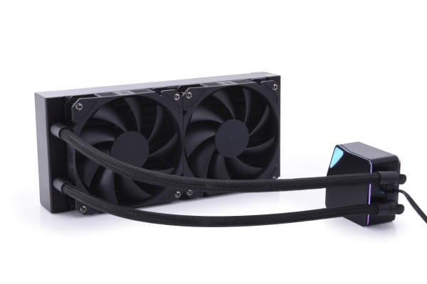

With the Core Ocean AiO, Alphacool presents an all-in-one solution that, thanks to its excellent... more

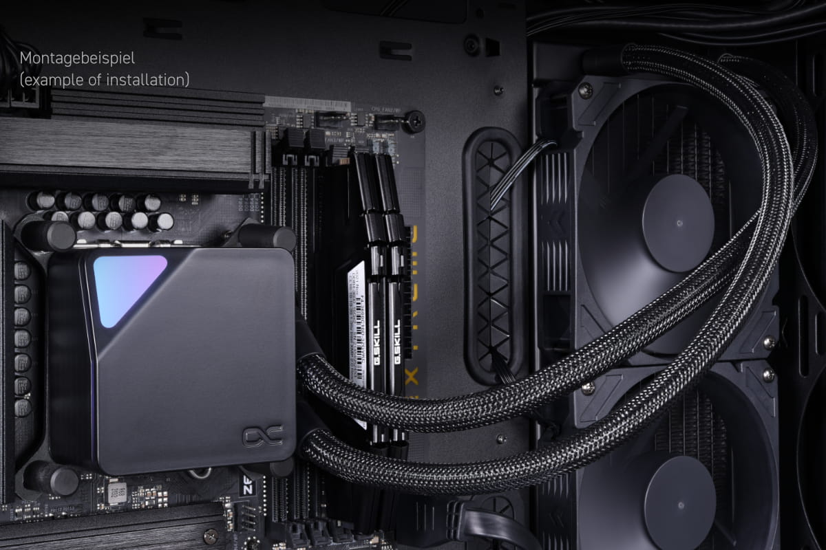

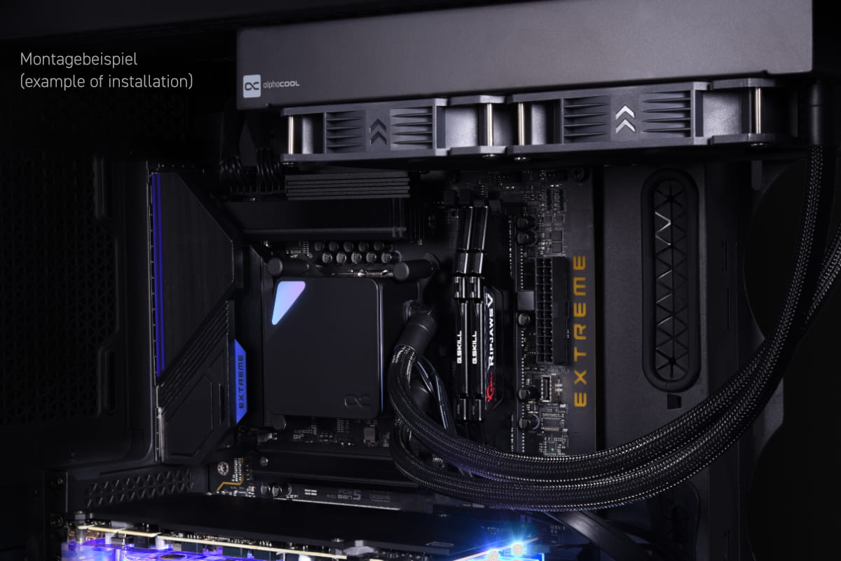

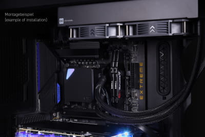

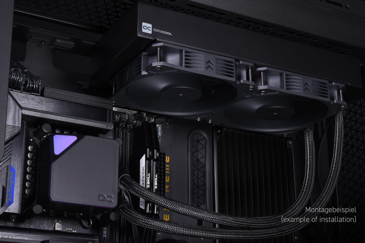

With the Core Ocean AiO, Alphacool presents an all-in-one solution that, thanks to its excellent price-performance ratio, enables entry into performance-oriented CPU water cooling. The difference to the Eisbaer CPU AiO is that the Ocean All-in-One is not expandable. Adding further components such as GPU coolers, radiators or expansion tanks is not intended here. But also not necessary! The choice of components and the design of the Core Ocean enable a long service life with low maintenance for water cooling of all common mainstream sockets from AMD and Intel.

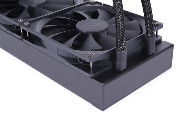

Aluminium Radiator
Compared to Alphacool's full copper models, the T38 aluminium radiator has additional cooling channels. This technical design allows a significant increase in cooling capacity without restricting the water flow within the radiator. Due to the low height of 38mm, the radiator with single-sided fan assembly fits into the tightest case and enables high-performance water cooling of the CPU.
Core fan
The fan can be regulated from 0 to 2500 rpm via the 4-pin PWM connection. The cable is 40cm long. This allows the fan to be connected to the mainboard or a special controller without the need for additional adapter cables or extensions. At 2500 rpm, it provides an air flow of 62.8 CFM, together with a high static pressure of 2.13mm/H2O. This makes the fan perfect for mounting on radiators of a water cooling system.

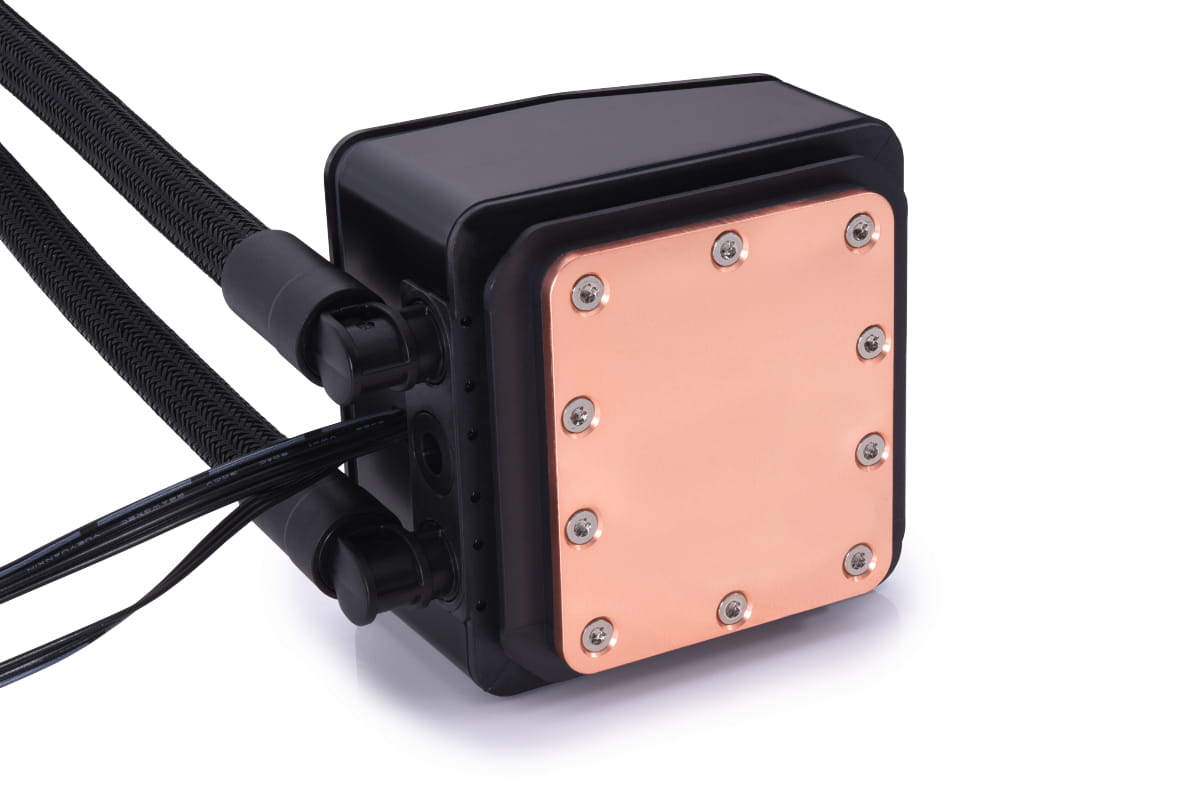

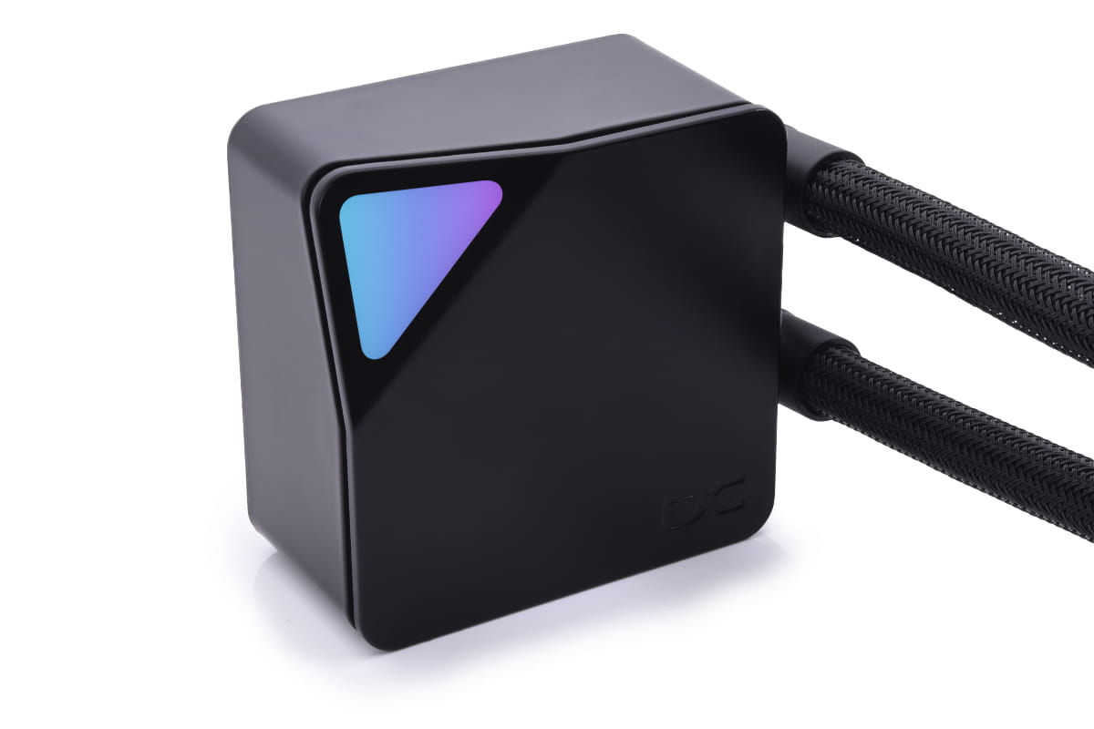

Cooler & Pump
As with all Alphacool products, the radiator base is made of copper and is equipped with very fine cooling fins distributed over the entire base. A nozzle plate ensures an accelerated flow over the cooling fins, which increases the cooling performance. The water flow is optimised so that all areas of the cooler base are cooled evenly. The cooler is compatible with all common mainstream sockets from AMD and Intel. The built-in pump has a speed range of 2500 - 3500 RPM (+/- 10%) and can be controlled via PWM. The pump is connected to the mainboard or to an external controller via the existing 4-pin fan connector. This allows the speed range of the pump to be controlled and monitored.
Hoses & Connections
The FEP hoses are 40cm long, sleeved and very flexible. The rotatable 360° connections to the cooler and to the radiator are permanently installed and cannot be replaced. However, the combination of hoses and connectors allows a very variable positioning of the AiO even in the tightest PC case.

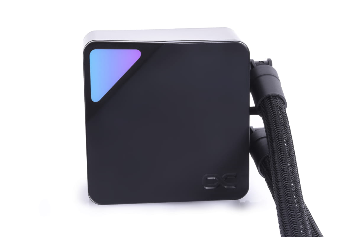

Illumination
12 digitally addressable 5V RGB LEDs are installed in the pump housing, which create a unique, very noble-looking illumination. The digital aRGB LED lighting is connected via a JST 3-pin connector. To control the lighting, the 3-pin female connector must be connected to a digital RGB controller (not included) or a digital RGB-capable mainboard. Additional digital RGB LEDs can be connected to the remaining 3-pin male connector.

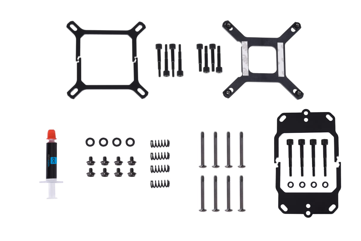

Thermal compound
The thermal paste included in the delivery has a thermal conductivity of 7.5 W/mK. The thermal grease does not harden, is particularly suitable for high contact pressures and can be applied perfectly due to the optimally selected viscosity.
AMD: AM4 / AM5
Intel: LGA 1150 / LGA 1200 / LGA 1700 / LGA 1851 / LGA 2066
Technical data radiator
L x W x H279 x 120 x 38mm
Material cooling fins, channels & prechamber3003 Aluminium
Material outer housing & threads3003 Aluminium
Fins per Inch19
Fan size120mm
Fan slots2 one-sided / 4 double-sided
Technical data fans
L x W x H120 x 120 x 25mm
Bearing Typehydraulic Bearing
Rated VoltageDC 12V
Operating VoltageDC 7-14V
Start-up Voltage7V
Rated Current0.23 (Max. 0.4) A
Rated Power2.76 (Max. 4.8) W
Rated Speed0 - 2500rpm/min (±10%)
Max. Air Flow62.8CFM
Max.Static Pressure2.13mm-H2O
Noise level (rated voltage, mute room, distance 1m)33.0 (Max. 34.3) dBA
MTBF50000hrs at 25°C
Speed Control ModePWM
Connection & control4-pin PWM (cable 40cm)
Auto-Restartyes
Tachometer Outputyes
Technical data cooler & pump
L x W x H70,2 x 70,2 x 46mm
Material cooler bottomcopper
Material pump housingSynthetic material (ABS+PC)
Fin structure cooler bottom0,1 x 0,1mm
Material pump bearing & shaftceramics
Starting voltage> DC 6V
Rated power7.1W
Noise level35Db
Rated Current0.59A (±10% MAX)
Speed2500~3500 (±10% RPM)
Power supply Digital aRGB3-pin 5V (male & female, cable length 30cm)
Number of aRGB LEDs12
Power supply pump4-Pin JST (Kabellänge 30cm)
Technical data tubes
MaterialFEP, black with weave cover
Length400mm
