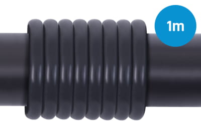

18662 Alphacool EPDM Tube 13/10 - Black 1m (3,28ft) Retailbox
€4.80*

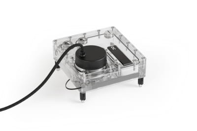

13889 Alphacool Core 140mm Reservoir D5 with VPP Apex PWM Pump
€188.98*
