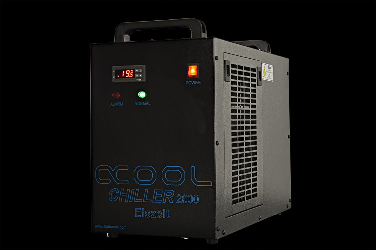

The Alphacool “Eiszeit” is a compressor cooler with a maximum cooling power of 1500W. Unlike... more
The Alphacool “Eiszeit” is a compressor cooler with a maximum cooling power of 1500W. Unlike most so-called Chillers or
circulating coolers, the Eiszeit has a high-performance integrated pump.
With the “Eiszeit”, you get a compressor cooler designed by Alphacool. With it, you can keep your system – or more than one
system – at a temperature you pre-set, automatically regulated for you. The Eiszeit has a maximum cooling power of 1500W.

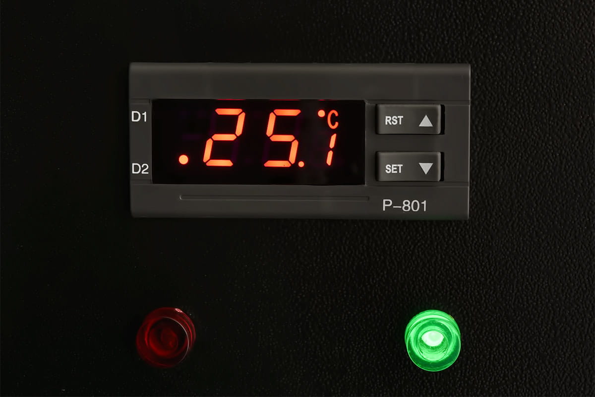

Entering your settings is easily done through the Eiszeit’s display, and you can set the temperature in precise increments of 0.3°
Kelvin. If necessary, you can reach temperatures far below room temperature.

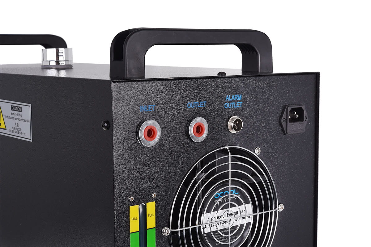

Another highlight is the integrated high-performance pump with a maximum head of 10m. This means a separate pump is no
longer necessary. If the pump performance proves to be too strong, a restrictor can be integrated into the cooling loop via a
ball valve or check valve. The G1/4” connectors can fit nearly all standard water cooling attachments. This gives the Eiszeit out-
standing compatibility compared to other current products like CPU coolers and graphics card coolers.

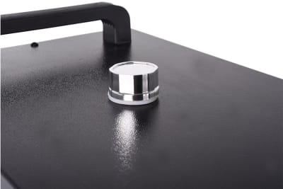

Using the Eiszeit is relatively simple. After connecting it to the cooling loop, the loop needs to be filled via the fill port on top of
the Eiszeit. The integrated reservoir holds 9L; additionally, you will need enough coolant to fill the complete loop.

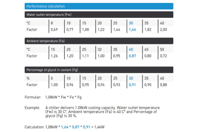

Performance calcuation
Water outlet temperature (Fw)
C°810152025303540
factor0,690,7711,221,441,641,822
Ambient temperature (Fa)
C°1520253235404550
factor1,261,21,1110,950,870,80,72
Percentage of glycol in coolant (Fg)
%010152025303540
factor10,960,950,940,930,910,90,88
Formular: 1,08kW * Fw * Fa * Fg
Example: A chiller delivers 1.08kW cooling capacity. Water outlet temperature (Fw) is 30 C°, Ambient temperature (Fa) is 40 C° and Percentage of glycol (Fg) is 30 %.
Calculation: 1,08kW * 1,64 * 0,87 * 0,91 = 1,4kW
