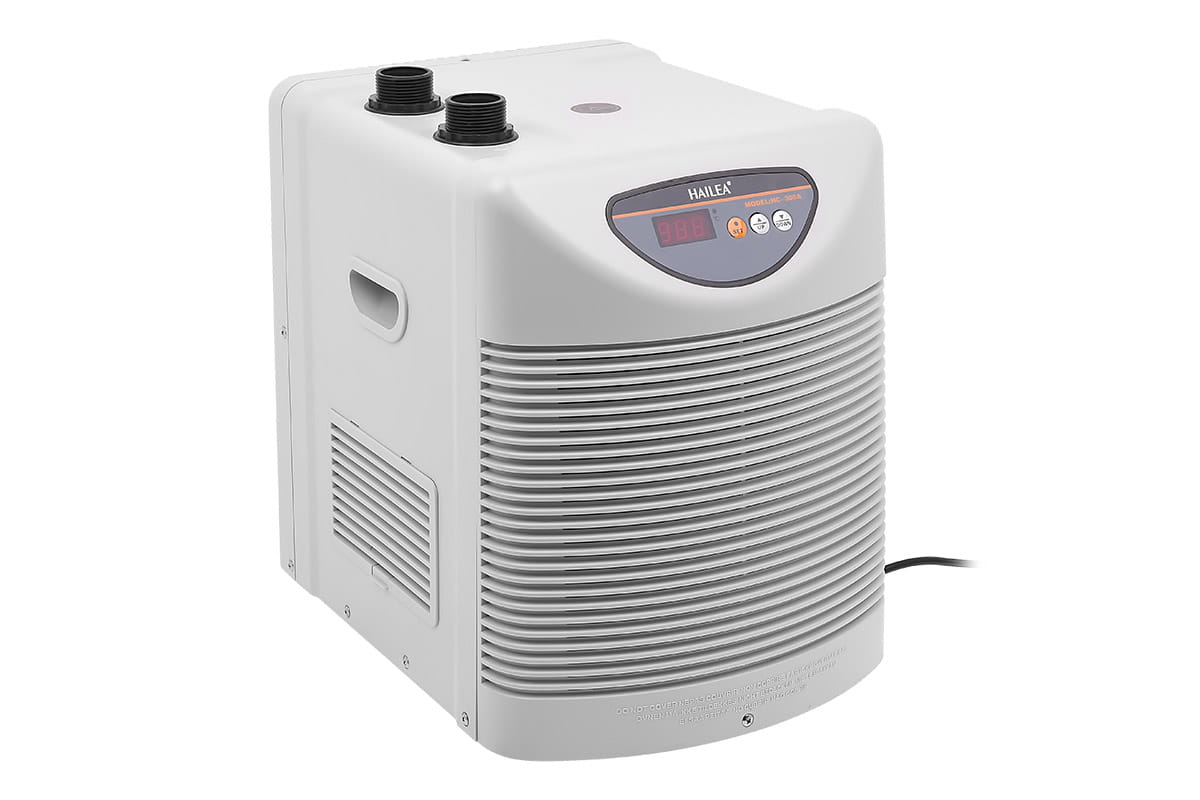

flow cooler Hailea Ultra Titan 500 (HC300=395W cooling capacity) - White Special Edition

Hailea's cooling units have been installed in proven flow coolers from other manufacturers for over 15 years. The new heat exchangers in the Ultra series are made of titanium. This makes the coolers perfect for water cooling systems and aquariums. Another positive feature of the devices is the low noise level. In addition, the prices of the new series have dropped to pleasing levels.
Experience the invigorating power of ice bathing according to the Wim Hof method.The Hailea flow cooler - an indispensable cooling device for cold water therapy and cold training!
New revision
  • new cool design - white
  • More stable materials for longer life
  • lower noise level
  • Suitable for endurance running
Noise development
According to the manufacturer, smaller chillers (e.g. HC150) can usually be operated next to the PC / aquarium without this being perceived as disturbing.
For larger models (from HC500) we recommend additionally decoupling and insulating the chiller
The HC1000 and HC2000 models should be specially insulated or operated in a separate room.
This flow cooler essentially replaces the radiator, as the water is regulated down to a temperature set by you. Temperatures of up to 4°C are possible, but please note that the temperature difference can cause condensation to form. The temperature can be set in individual steps up to 28°C via the display. Appropriate insulation accessories (for hose and CPU) are also available. Alternatively, the chiller can also be set to a value just below room temperature to avoid the problem of condensation.
The low water temperatures open up unprecedented possibilities for overclocking. The lifespan of your components increases many times over. This system is also interesting for no-noise applications, as the chiller can be placed in another room. We recommend integrating the chiller as an additional cooling source in a system next to an existing radiator. This way, you can switch off the normal radiator as needed (overclocking / benchmark / midsummer, etc.) and the chiller will then take over the cooling.

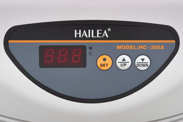

  • Temperature controller: Digital reading accuracy 0.1°C, setpoint adjustment in 1°C steps
