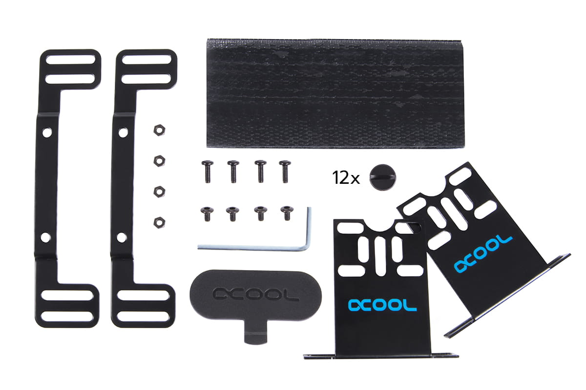

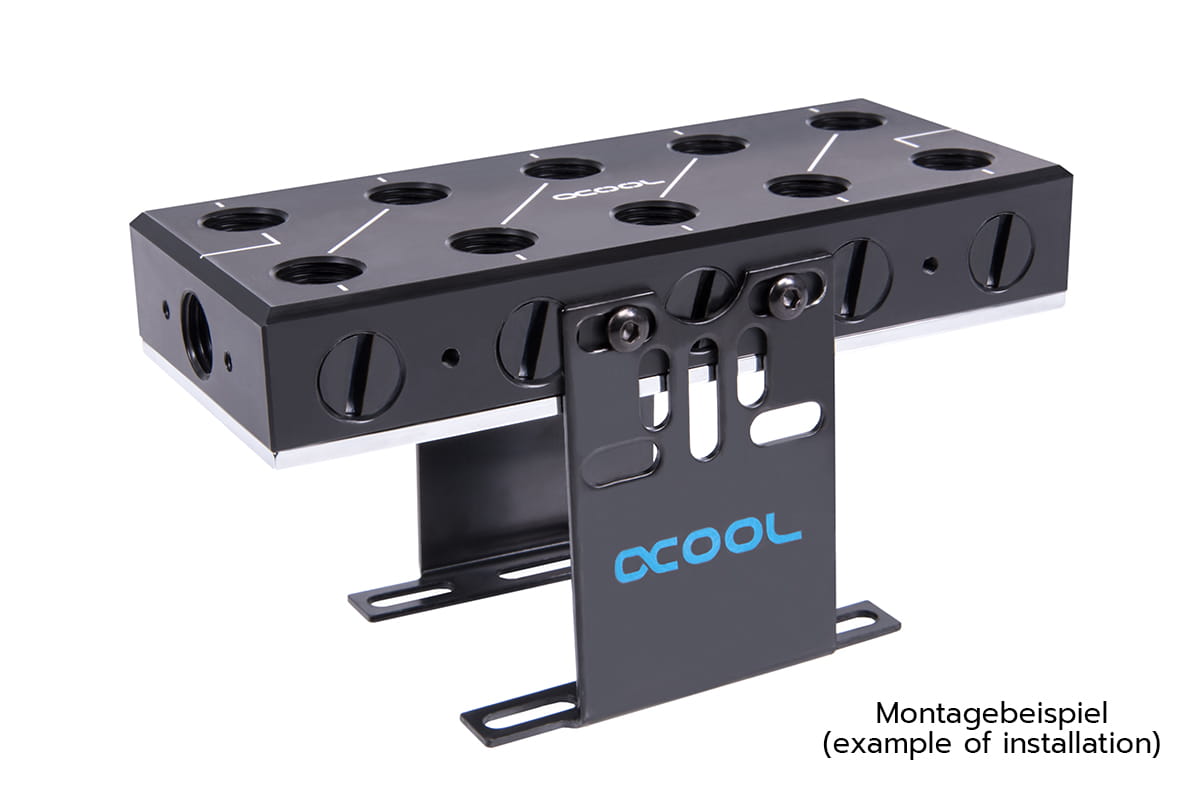

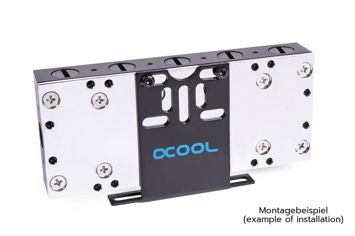

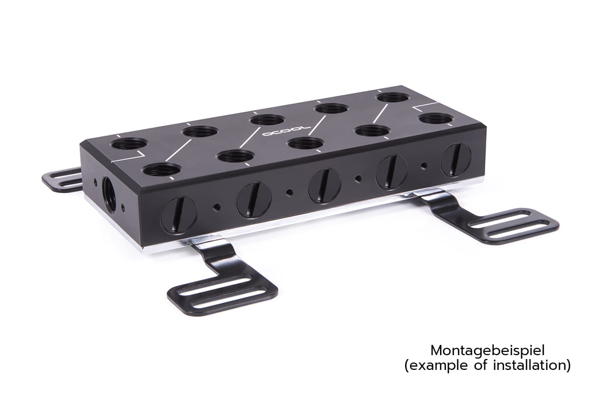

Mounting options
The ES Distro Plates can be mounted in many ways. The easiest and fastest variant is the mounting via the included self-adhesive Velcro. One side is glued stuck dirrectly to the Distro Plate, the other side to any place in the case. After that, you can simply put the Distro Plate on the Velcro. Alongside the Velcro, special feet and mounting frames are included to provide multiple installation options. With the mounting accessories, the Distro Plate can be mounted to any 120 or 140 mm fan space. The included feet also offer many mounting options, including a vertical mounting option on a single foot. Various threaded holes on the sides and back of the ES Distro Plate offer more direct mounting options, including customized holes for special mounting rails in Alphacool's server racks.

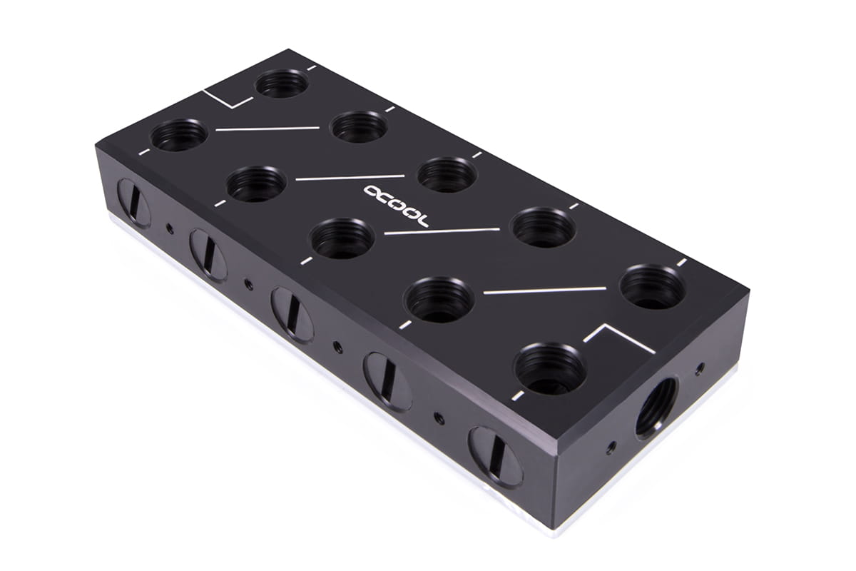

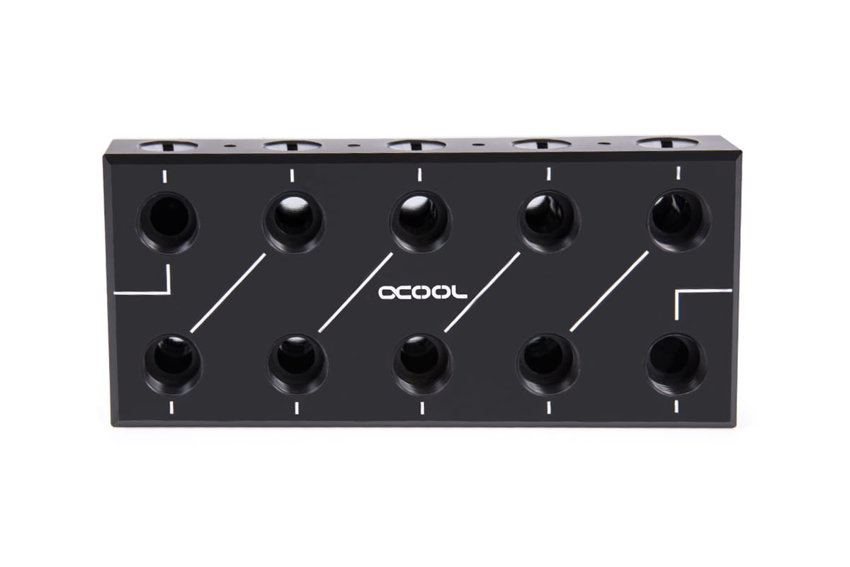

The ES Distro Plate C5 has a total of 22 connection options in G1/4 format with 5mm deep threads. There are 5 connections on each long side, 10 on the top side and one connection thread on each front side. However, it is important to note that all connections are in pairs. So you can only use the top or the side connection. The excpetion are the ports with 3 sides. Here, only the lateral, upper or the connection on the front side can be used. The exact options are illustrated in the instructions. This configuration makes it very easy to connect all components in the water circuit to the Distro Plate. Of course, several ES Distro Plates can also be connected in series.

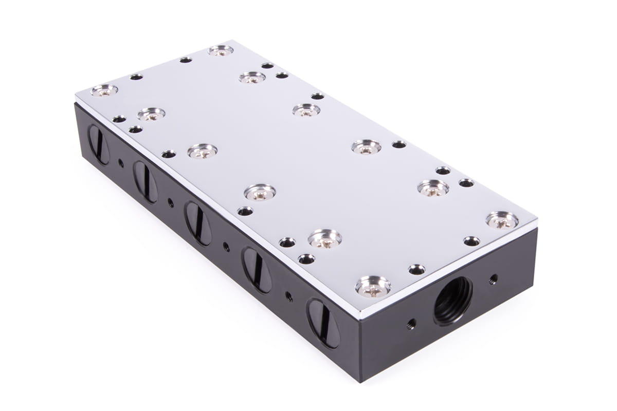

Dimensions (L x W x H)56 x 130 x 22,5 mm
Material topAcetal
Material bottomNickel plated copper
Threads22 x G1/4“
Pressure tested8 bar
Max working temperature60°C
