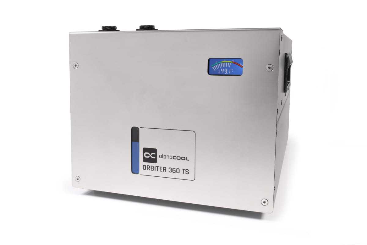

The Alphacool ES Orbiter 360 TS is an external cooling system for industrial applications. It is... more
The Alphacool ES Orbiter 360 TS is an external cooling system for industrial applications. It is compact and powerful, using two HPE-30 NexXxoS Full Copper radiators with a total of 360mm for cooling. The ES Orbiter 360 TS can dissipate heat of up to 1300 watts*.
Powerful Cooling!

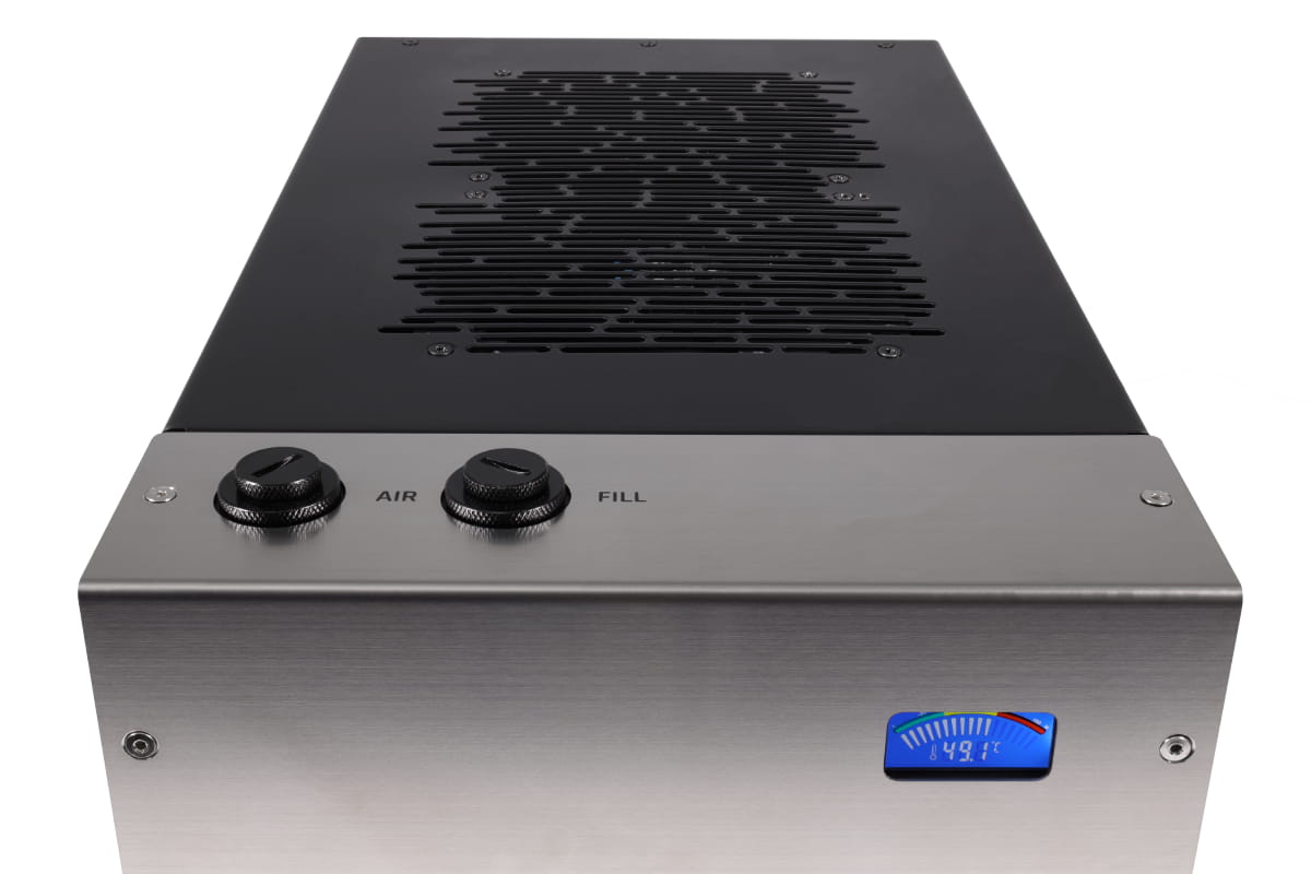

The system utilizes a 120mm and a 240mm NexXxoS Full Copper radiator with 30mm thickness each in the HPE variant. The HPE version of the NexXxoS radiators features a condensed design of the cooling channels, allowing more coolant to flow through the radiator and significantly improving the cooling performance. The three Alphacool Core 120mm fans with high durability ensure optimal ventilation of the radiators. The fans and pump are controlled and monitored by the ES Guardian Powerfan Hub, which alerts in case of component failure. The temperature can be monitored with the color display on the front, which also features a fluid level indicator to determine the amount of liquid in the system.

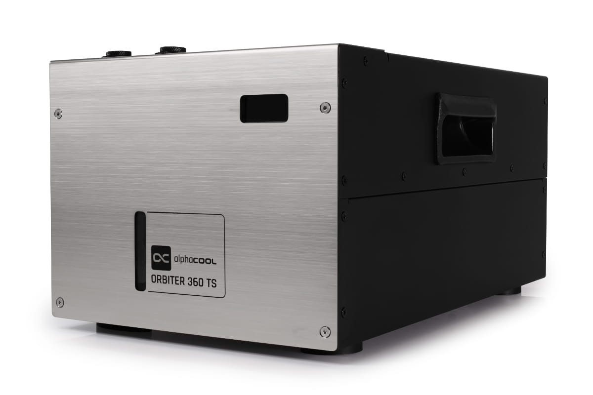

Compact Design

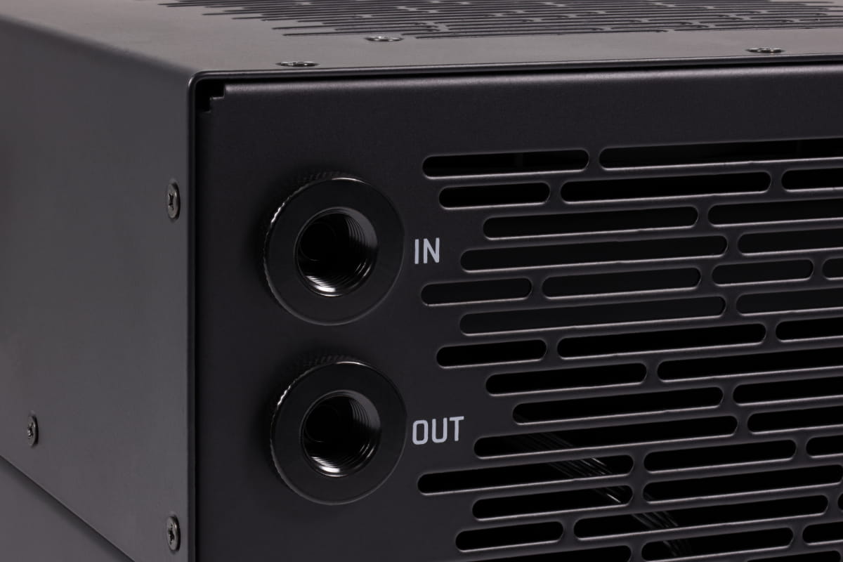

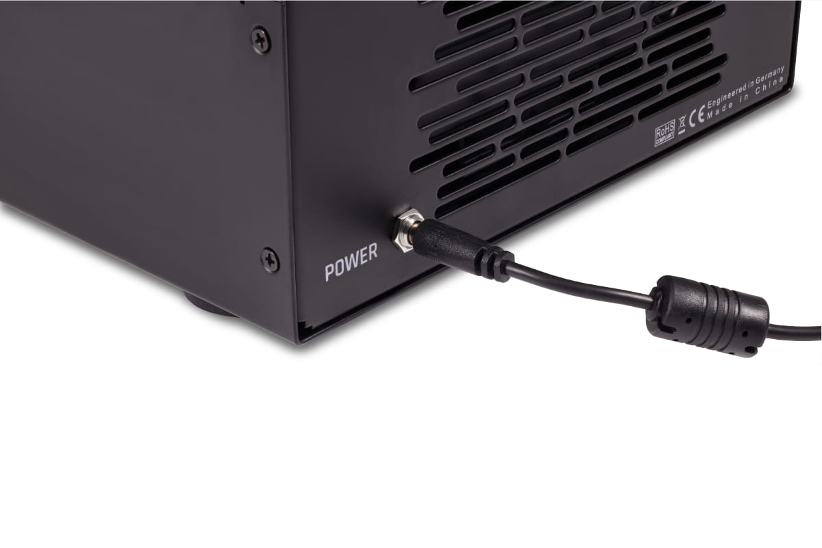

The ES Orbiter has a simple and sleek design, with two built-in handles on the left and right for easy lifting. The Alphacool Eisfach with integrated and powerful third-generation VPP755 pump is used as the reservoir. Thanks to this powerful pump, almost any desired loop can be reliably operated. Refilling the coolant is easy using to the fill port on the top, and the system can be easily vented through the adjacent valve. The water inlet and outlet, as well as the power connector, are located on the back of the Orbiter.
*at an ambient temperature of 23°C

Voltage12V DC
Total power consumption17,7W

Fillport1x G1/4“
Water connections2x G1/4“
Air balance connection1x G1/4“
