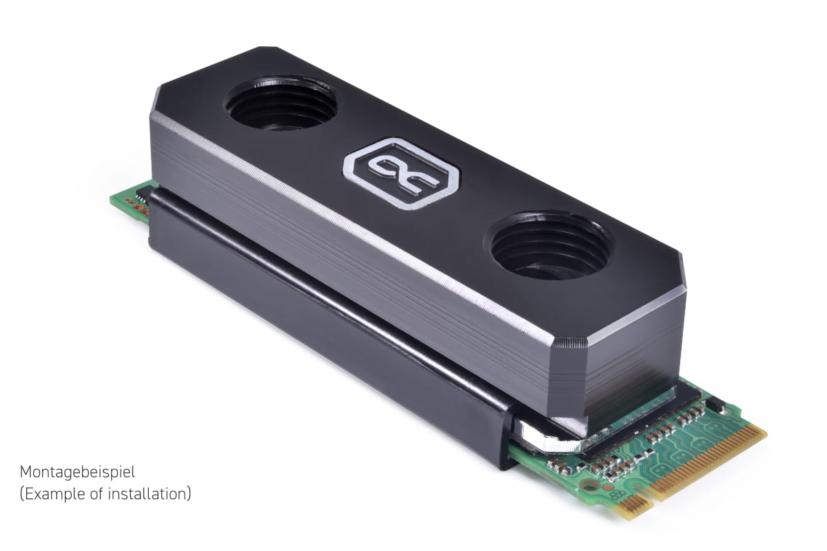

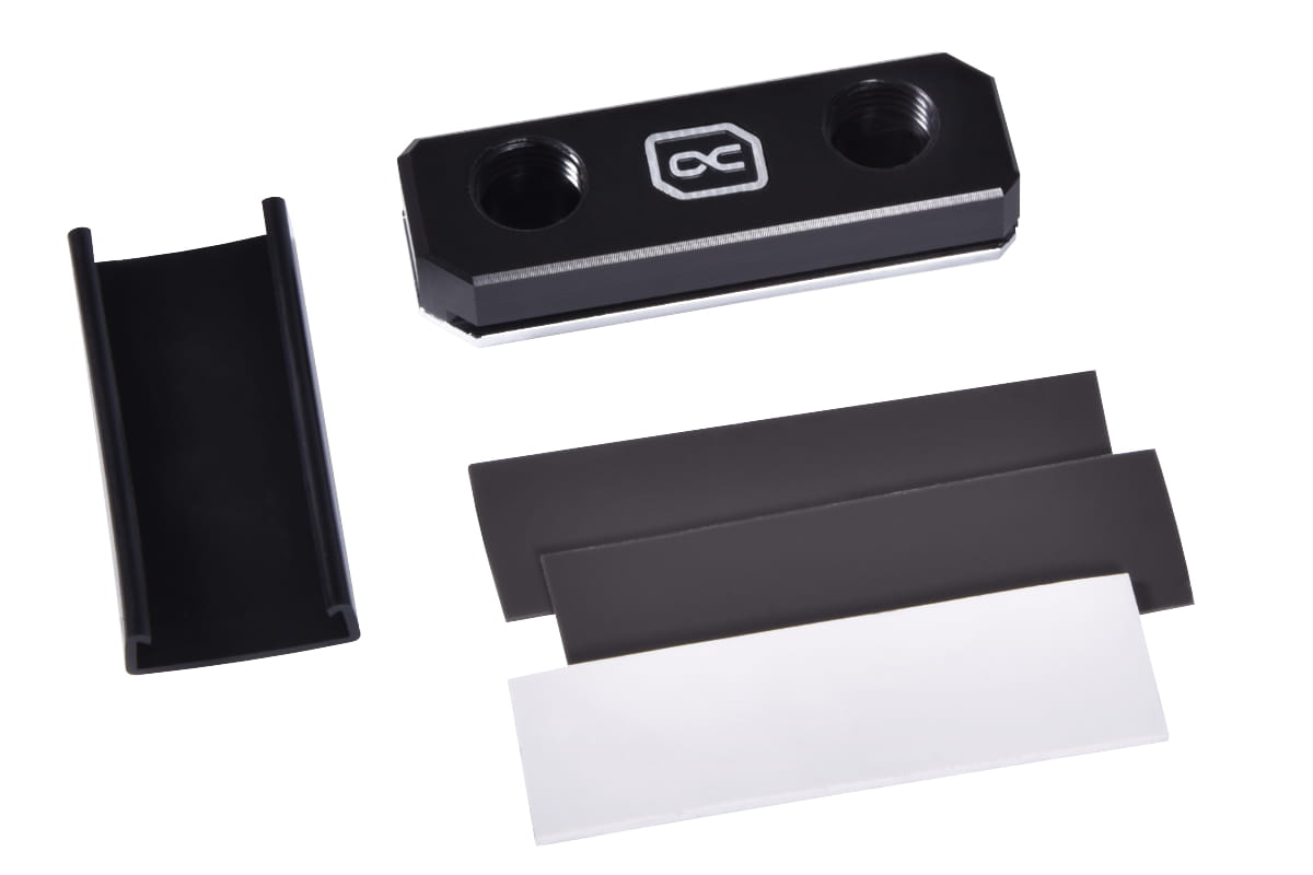

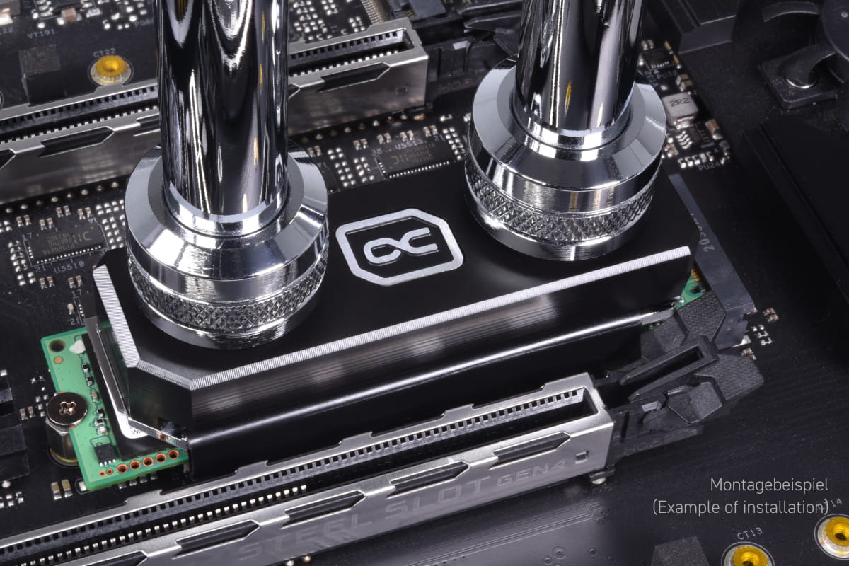

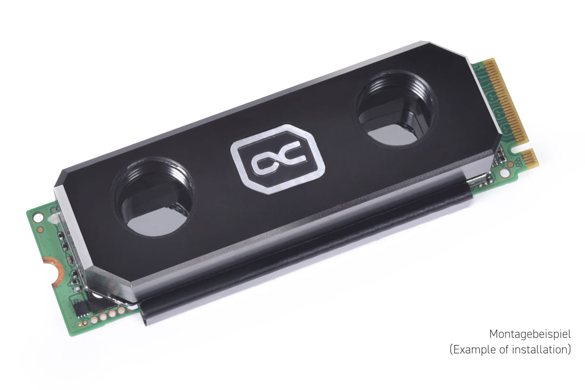

Mounting
The HDX Apex Acetal cooler is compatible with M.2 2280 SSDs that are mounted on one or both sides. If the PCB is populated with memory chips on both sides, the 0.5mm heat conduction pad is used on both sides. If memory chips are only installed on one side, then the 1.5mm heat conduction pad is used on the side without chips. Once the top and bottom of the SSD have been fitted with thermal pads, the SSD memory is pushed into the retaining clip and mounted under the cooler. The installation on the mainboard is then carried out as usual. The cooler can now be integrated into the water circuit using the existing G1/4" connections.

Technical data cooler
L x W x H67.99 x 25.6 x 16.8 mm
Material coolernickle-plated copper
Material cooler topacetal
Material clipsynthetic material
Threads2x G 1/4
Thickness cooler bottom1.6 mm
Thermal conductivity thermal pads3 W/(m·K)
Pressure tested0.8 bar
Weight43 g
