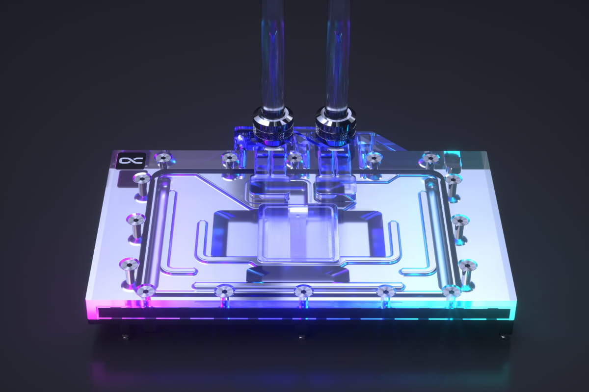

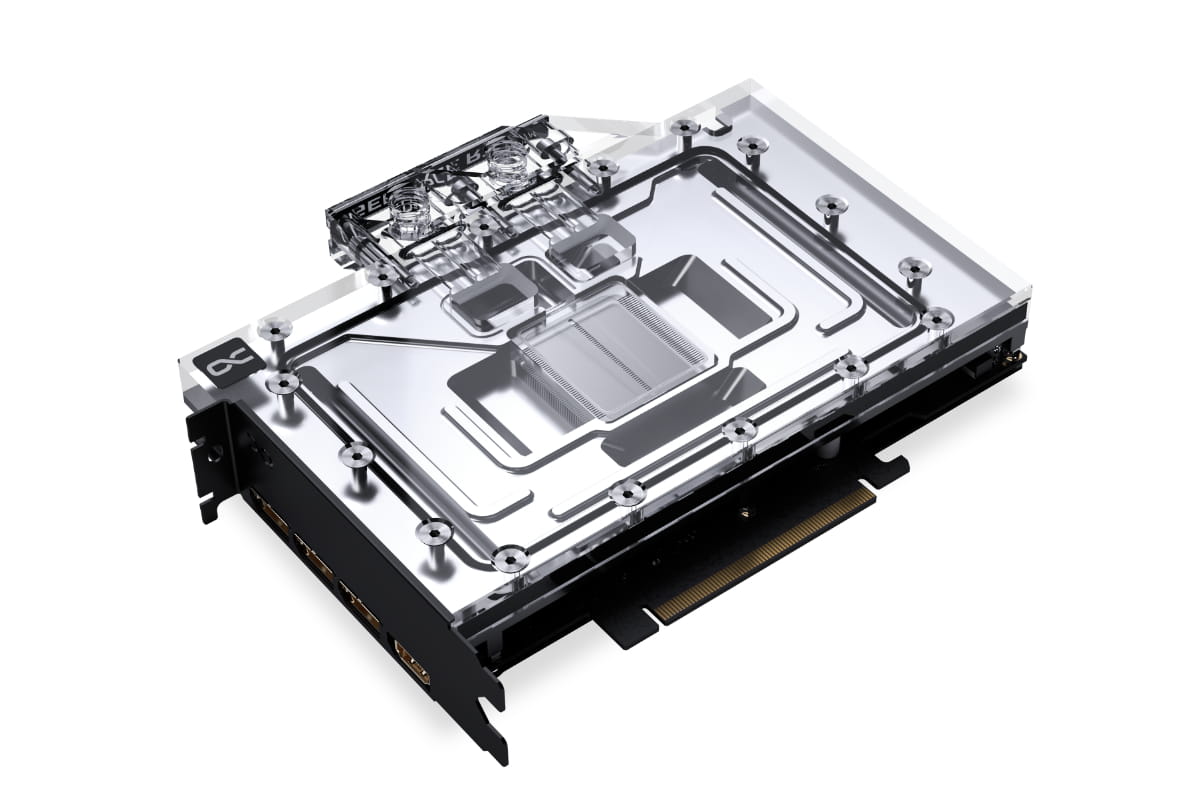

The next generation - the Alphacool Eisblock Aurora water cooler for Geforce RTX 4XXX graphics... more

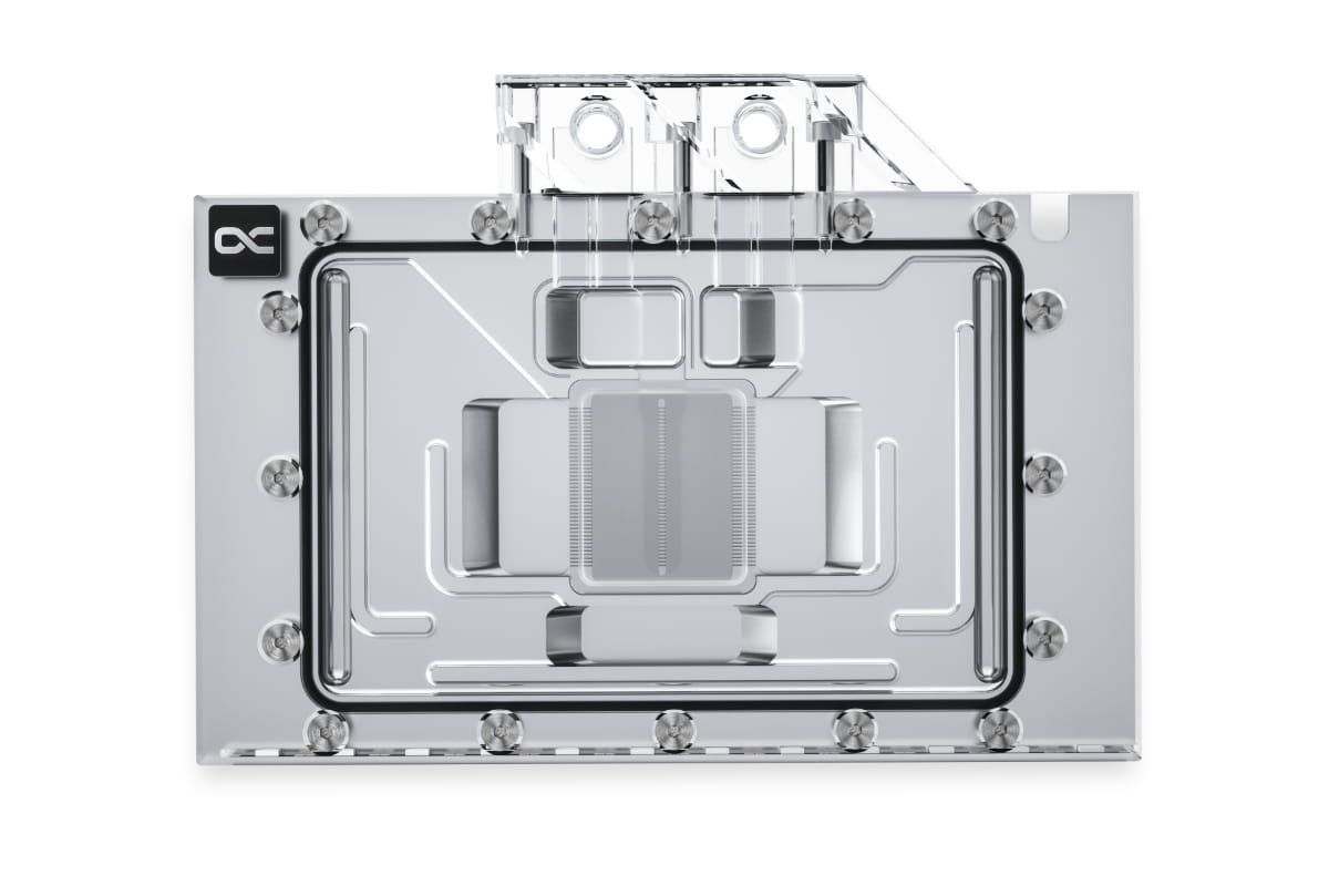

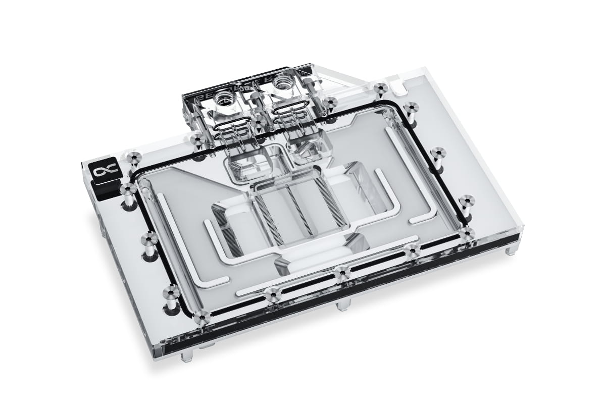

The next generation - the Alphacool Eisblock Aurora water cooler for Geforce RTX 4XXX graphics cards. In order to dissipate the enormous heat of this graphics card generation in the best possible way, numerous optimizations have been made to the water cooler compared to the previous model. The fin structure was adapted and enables a very good water flow while increasing the cooling surface. The modified jet plate with improved inflow engine ensures an optimal distribution of the water on the cooling fins.
Important note: The RTX 4090 Eisblock Aurora Reference cooler is not compatible with Nvidia's Geforce RTX 4090 Founders Edition. The RTX 4090 FE is compatible with the following cooler: Alphacool Eisblock Aurora Acryl GPX-N RTX 4090 Founders Edition with Backplate (Art. 13456)
Technical Highlights
The fin structure of this Eisblock cooler generation was developed together with Nvidia board partners. The fin thickness is 0.4 mm, the distance between the cooling fins is 0.4 mm. This ensures a very good water flow while increasing the cooling surface. The jet plate has a revised inlay that spreads the water pressure better over the fins thus optimizing the heat absorption. The adjusted water inflow gives the water a better angle of inflow.
Chrome-plated copper
Design
The Aurora design of the Geforce RTX 4XXX Eisblock generation is visually calmer and simpler. Only one O-ring runs around the entire cooler. The design around the cooling fins and jetplate makes for a cleaner look. The illumination of the digitally addressable RGB LEDs is even better distributed throughout the cooler as a result of the chrome plating. The terminal's design is in line with the classic Aurora design.
Thermal paste & thermal pads
The included thermal compound is Alphacool's Subzero. With a thermal conductivity of 16 W/mk, it is one of the highest performing thermal pastes on the market. The electrically non-conductive thermal compund is particularly well suited for high contact pressures, but can still be processed perfectly due to its viscosity of 850,000 TF. Alphacool Soft Pads with 1mm thickness are used on the voltage converter and the graphics memory. The thermal conductivity of the pads is 7W/mk. The pads for the back of the PCB are 3mm thick and have a thermal conductivity of 3W/mk.
Attention! For PNY GeForce RTX 4090 the rear part of the PCB is not completly covered. This has no negative effect on the cooling performance!
Attention: Unfortunately Inno3D is using two different PCB Layouts. Please check your serial number. If it looks like following, it is not compatible with our water blocks: 32-879-xxxx8xxxx

Technical data cooler
L x W x H198.60 x 144.29 x 35.89 mm
Material cooler topacrylic
Max working temperature60 °C
Pressure tested0.8 bar
Threads4 x G 1/4
Thickness cooling fins0.4 mm
Distance cooling fins0.4 mm
Illuminationdigital aRGB LEDs
Power digital aRGB LEDs5 V
Number of digital aRGB LEDs12

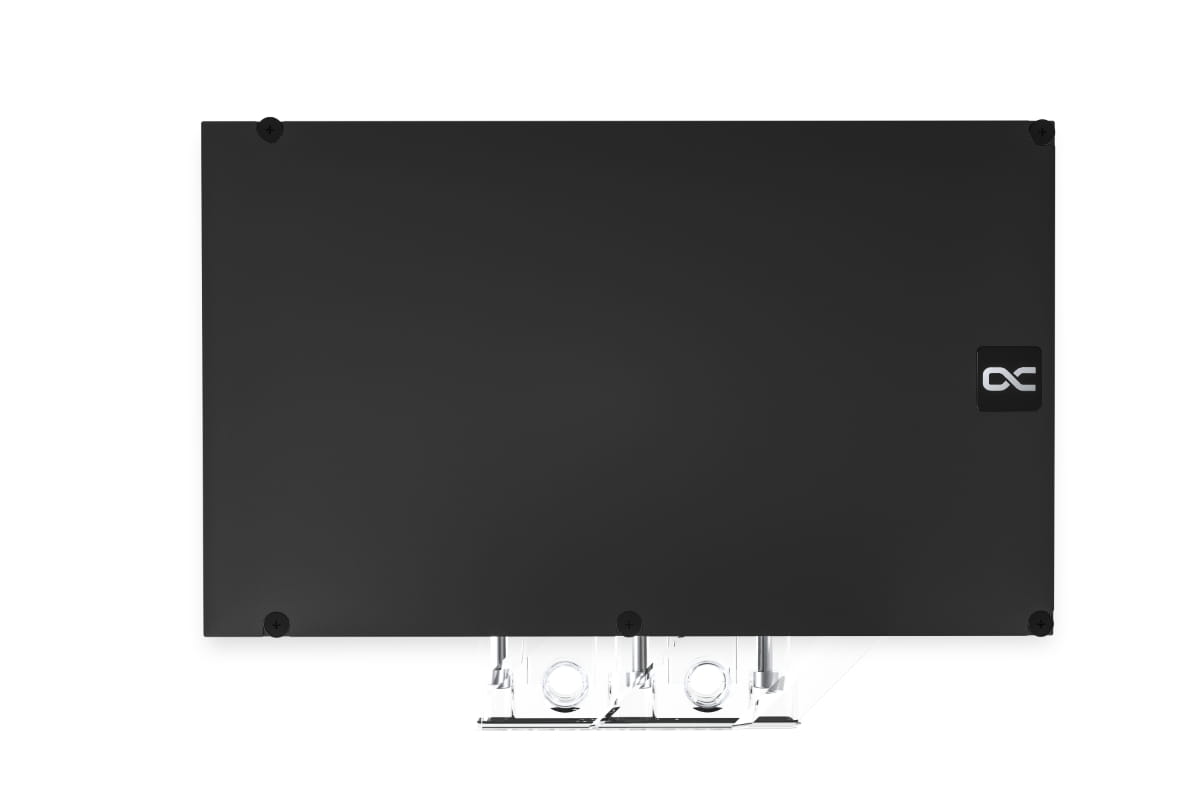

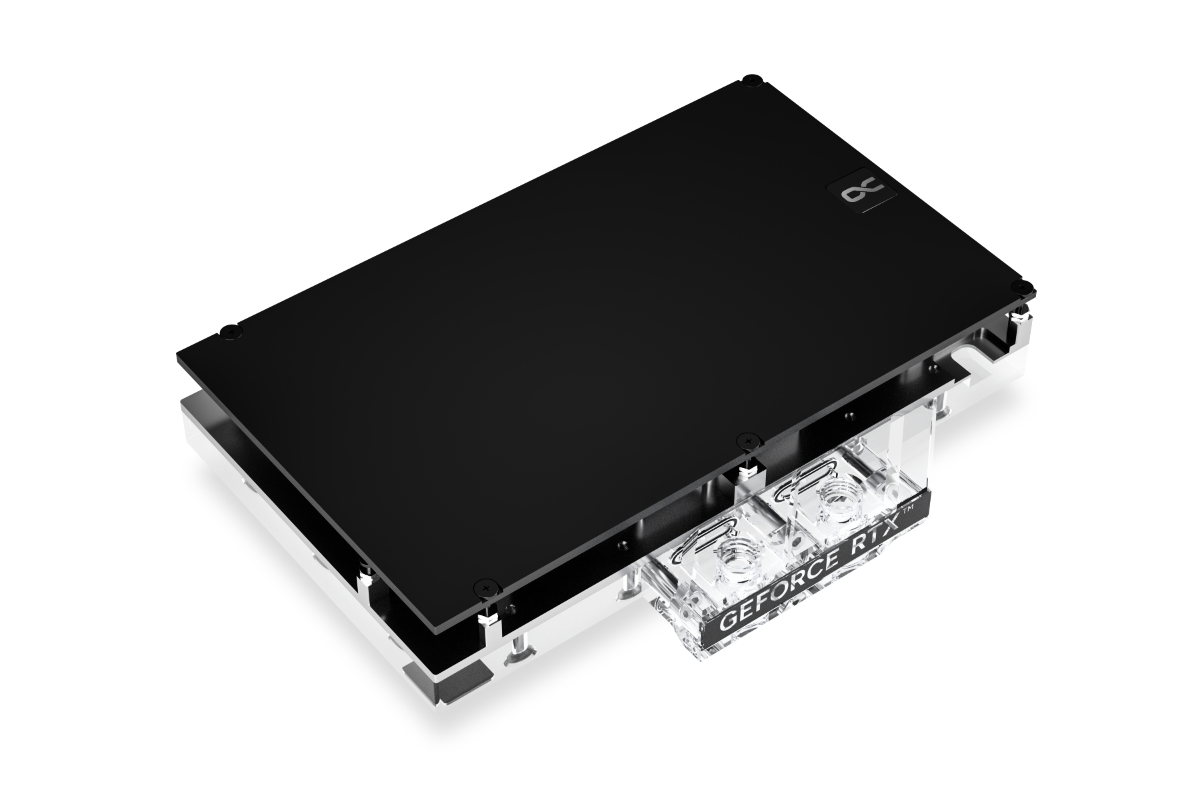

Technical data backplate
L x W x H198.60 x 119.69 x 6 mm
Materialaluminium
