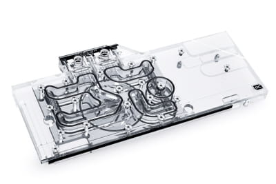

13056 Alphacool Eisblock Aurora Acryl GPX-N RTX 3090TI Founders Edition with Backplate
