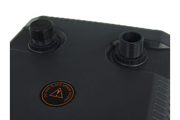

RAKZ connection adapter for ultra flow cooler 150 to G1/4
2x
€1.98*

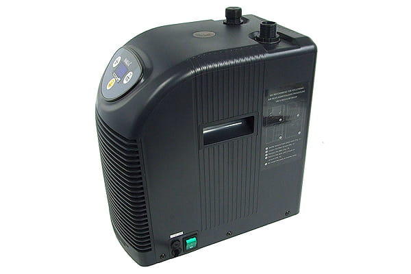

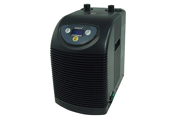

Hailea's cooling units have been installed in proven flow coolers from other manufacturers for... more
Hailea's cooling units have been installed in proven flow coolers from other manufacturers for over 15 years. The new heat exchangers in the Ultra series are made from titanium. This makes the coolers perfect for water cooling systems for PCs, servers, aquariums or cold baths. Another positive feature of the devices is the low noise level. In addition, the prices of the new series have dropped to pleasing levels.

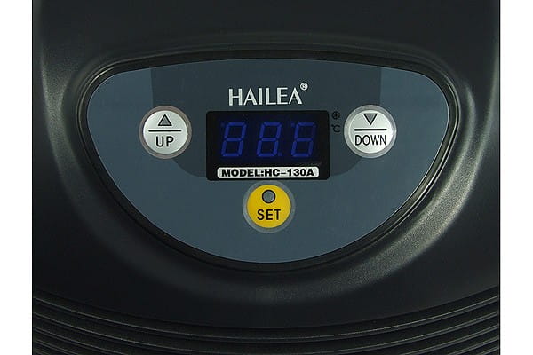

This flow cooler essentially replaces the radiator, as the water is regulated down to a temperature set by you. Temperatures of up to 4°C are possible, but please note that the temperature difference can cause condensation to form. The temperature can be set in individual steps up to 28°C via the display. Appropriate insulation accessories (for hose and CPU) are also available. Alternatively, the chiller can also be set to a value just below room temperature to avoid the problem of condensation.

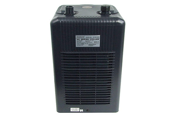

  • Compressor power: 1/15 HP
  • Mains voltage: 220-240V
  • Cooling capacity: 110 watts
  • Recommended water flow: 200-1000l/h
  • Weight: 9.2Kg
  • Refrigerant: R 134 A
  • Dimensions: 338x218x325mm (LxWxH)
  • Connection outer diameter: 11-13mm
  • Heat exchanger: titanium
  • Max. pressure load: 0.8 bar
  • Temperature controller: Digital reading accuracy 0.1°C, setpoint setting in 1°C steps
  • Current consumption: 0.8 A (50 Hz)
  • Power consumption: 184 W

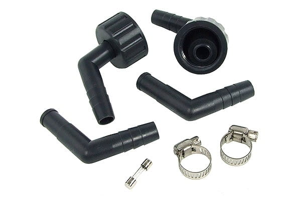

Scope of delivery
  • 1x Flow cooler Hailea Ultra Titan 150
  • 2x 45° angle with rubber seal
  • 2x 45° replacement angle without rubber seal
  • 2x matching hose clamps
