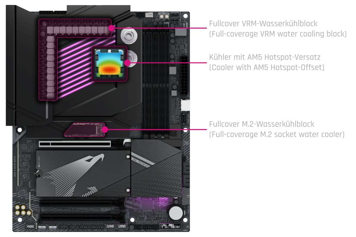

The Apex Monoblock is the ideal cooling solution for maximum performance, combined with an... more

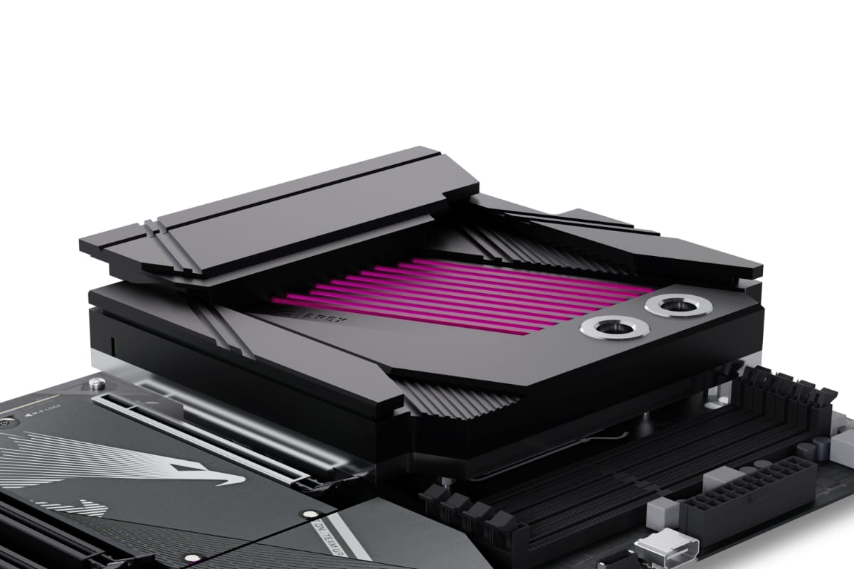

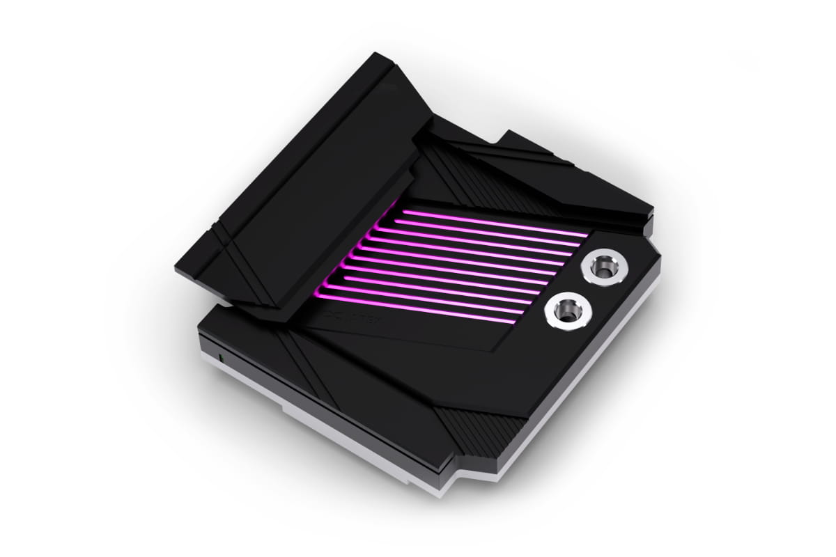

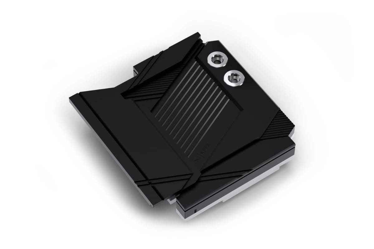

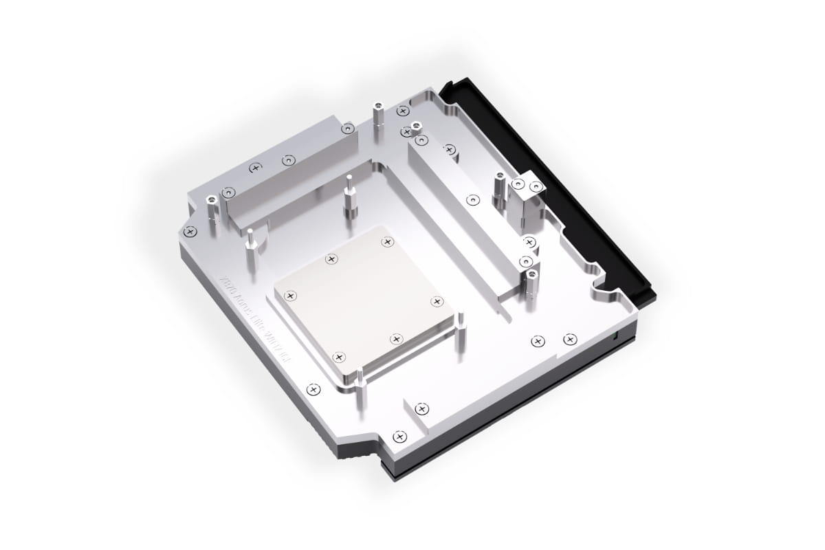

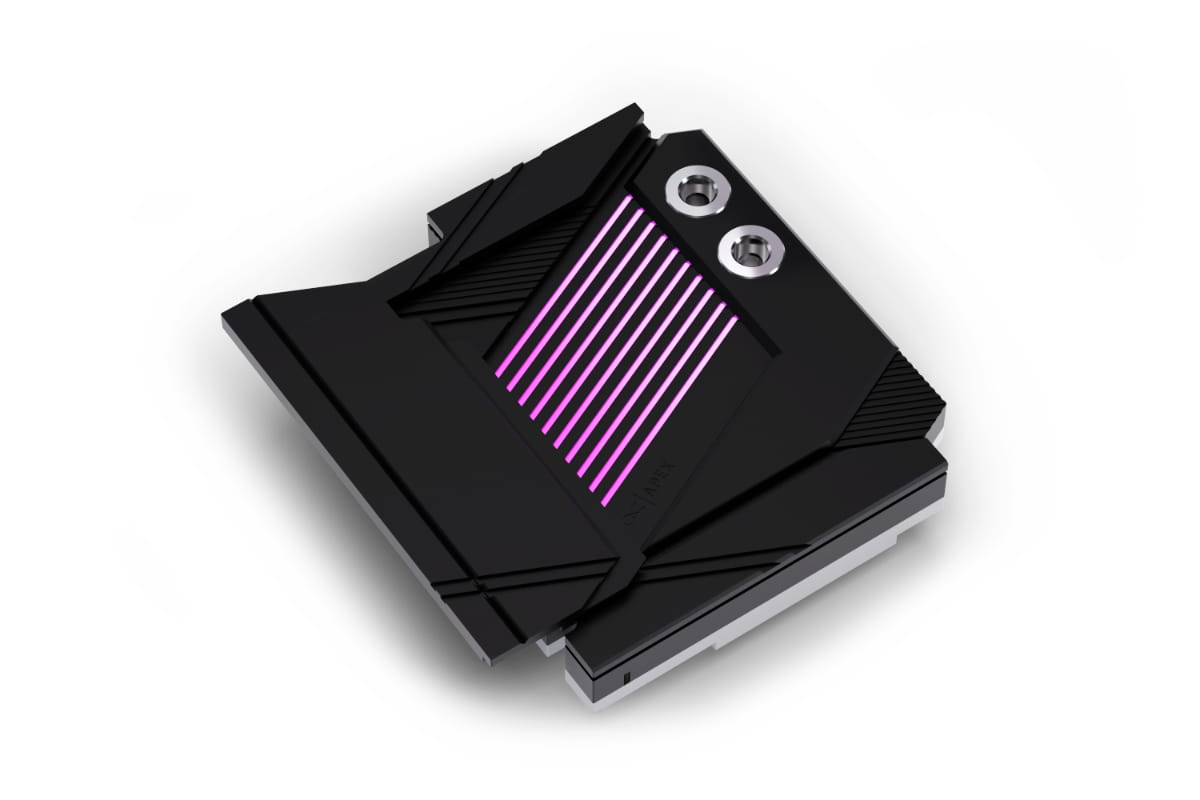

The Apex Monoblock is the ideal cooling solution for maximum performance, combined with an elegant design that is perfectly matched to the motherboard. Developed specifically for the motherboard, the monoblock cools the CPU, the voltage regulators (VRMs), as well as the M.2 NVMe SSD located below the CPU socket. All key motherboard components are actively cooled through the monoblock’s water block.
Like the Apex 1 CPU cooler, the Apex Monoblock uses an offset cold plate. This allows the coolant flow to hit the thermal hotspot of the AM5 CPU directly. In combination with the proven cross-slot structure and the 3D Jetplate 2.0, this design generates high water pressure, enabling particularly efficient heat dissipation. Ideal for overclocking or continuous operation.
The cooler is milled from a solid block of copper. The G1/4" connection terminal is made of brass and, together with the copper base, ensures long durability as well as excellent thermal conductivity.
The Apex Monoblock design, tailored to the respective motherboard, not only delivers optimal cooling performance but also integrates seamlessly into the motherboard’s appearance.
It features an integrated I/O cover, creating a clean and cohesive look that blends perfectly with the motherboard’s design.
The monoblock combines performance, design, and functionality, making it a highlight of any custom water-cooling setup.
Gigabyte X870 AORUS ELITE WIFI7 (AM5) (Rev. 1.0/1.1)
Dimensions (L x W x H) (in mm)173,50 x 175,50 x 54,30
Material coolerChome-plated copper (Cu-HCP)
Material coverAluminium (AlMg0,7Si)
Material cooler topPlexi (LXN865)
Material TerminalBrass (CuZn39Pb3)
Threads2x G 1/4
