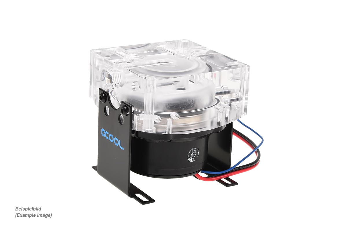

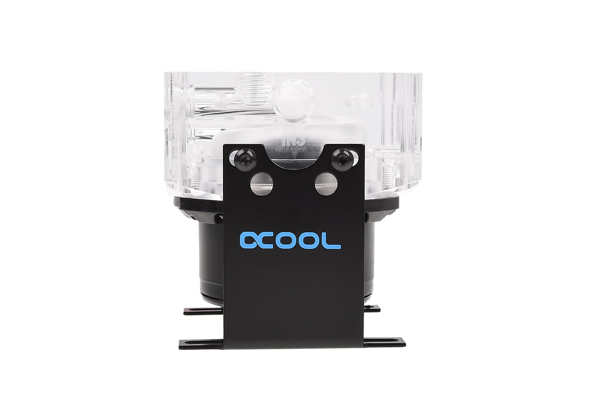

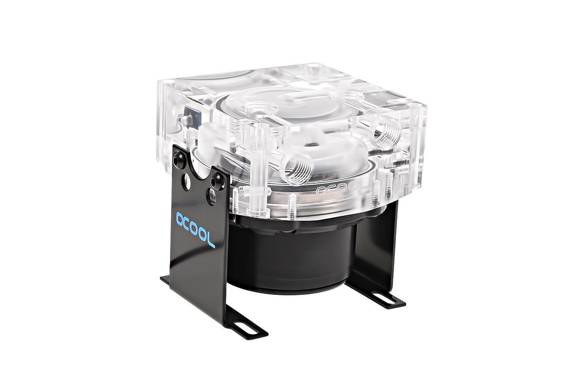

Alphacool's attachment for the Laing D5 is now a member of the Eisdecken series and receives an... more
Alphacool's attachment for the Laing D5 is now a member of the Eisdecken series and receives an update.
This attachment has been a benchmark for years. Small improvements have been made time and again. The second major update differs in a few details, both visually and technically.
The principle: There is space for the Laing D5 or VPP655 on the bottom and inlet and outlet at the front or on the top.
For even more flexibility, the ice cover has three inlets and two outlets. Another feature is the new bracket to give the whole unit a stable stand and round off the overall visual appearance. Installation in a 3.5" slot is also possible as an option.
The attachment can be converted into a complete expansion tank with the help of the expansion tank attachment available as an accessory, which has also been revised.
For all case modders, the acrylic glass attachment has four holes for 5mm LEDs!
  • Dimensions: 80 x 80 x 40mm
  • Dimensions with feet: 83 x 80 x 87mm
  • Material: Acrylic
  • Connections: 5x 1/4" thread

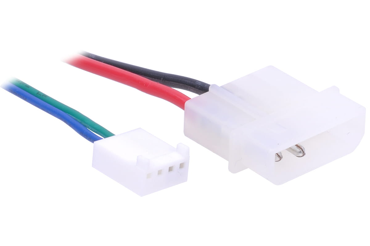

  • Power connector: 4 pin Molex

Power connection: 4Pin
