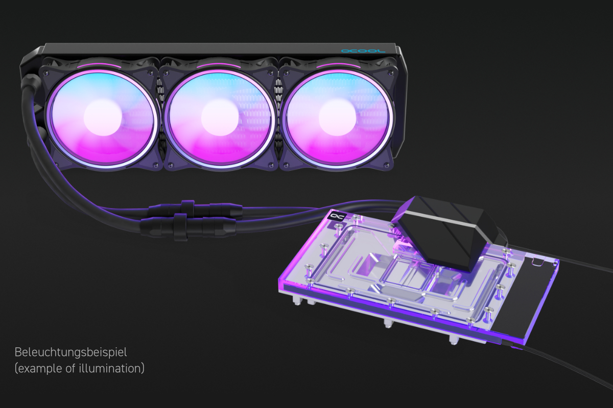

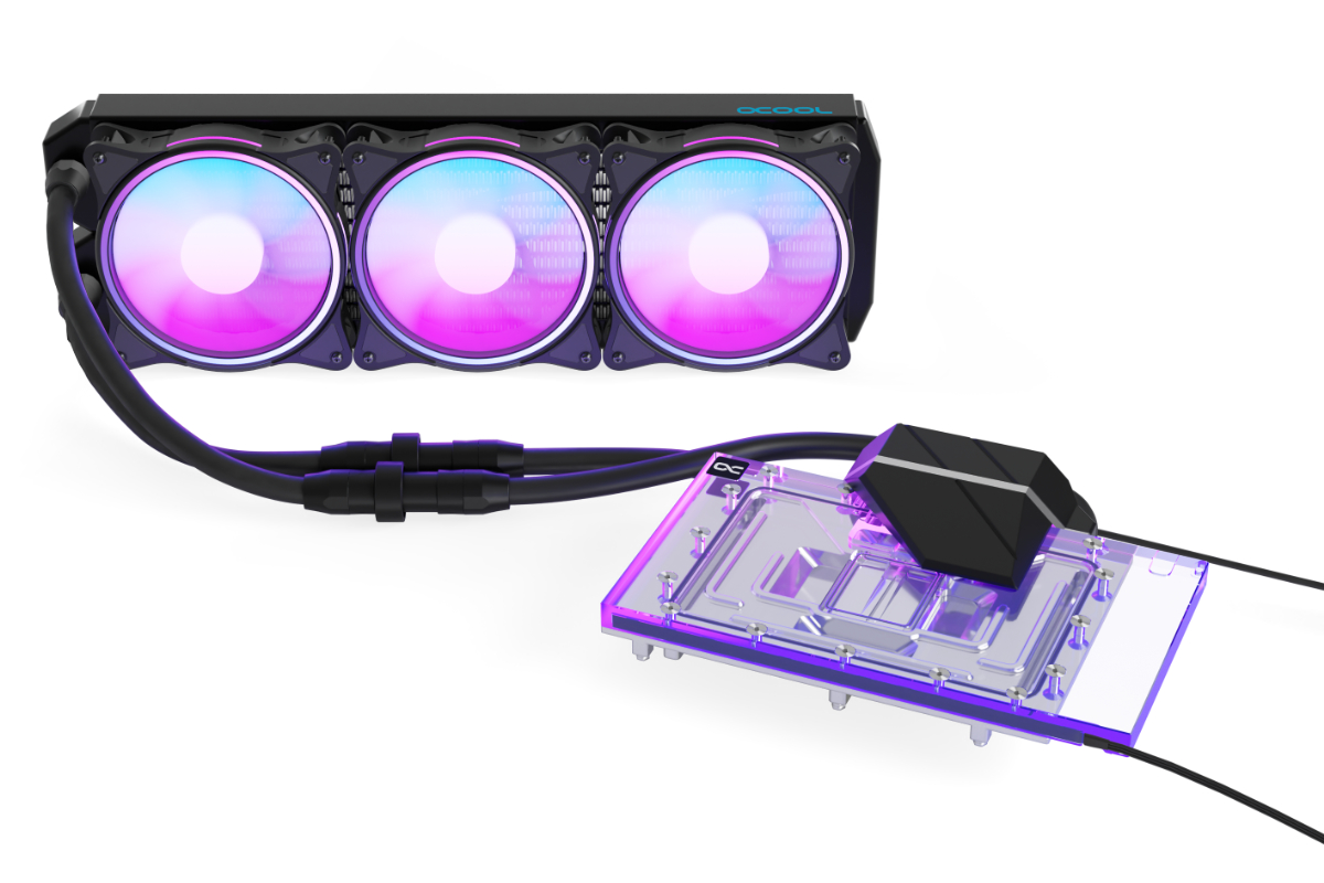

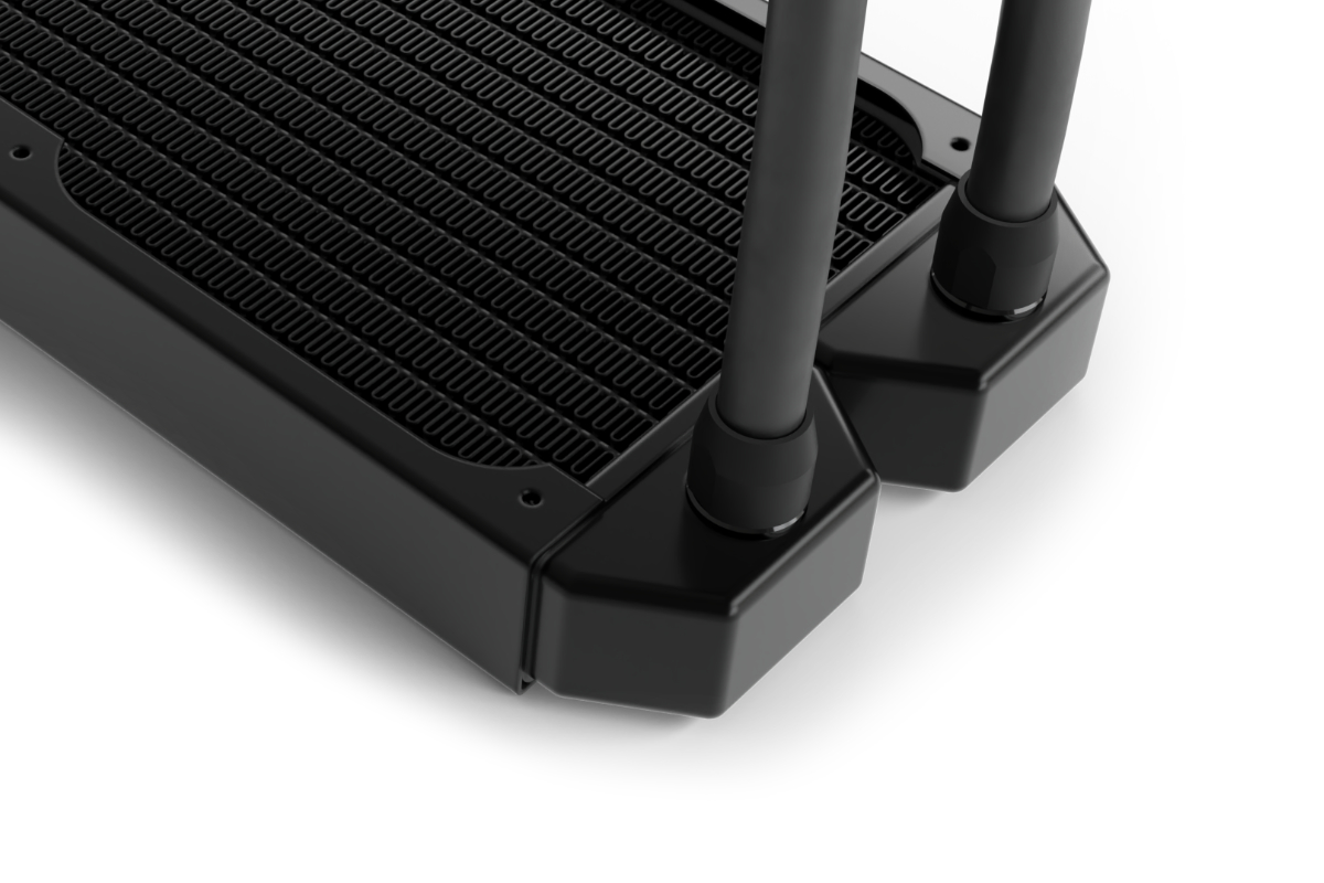

The Alphacool Eiswolf 2 is the first full cover GPU AIO waterblock from Alphacool. It is based... more
The Alphacool Eiswolf 2 is the first full cover GPU AIO waterblock from Alphacool. It is based on the Alphacool GPX Eisblock Aurora GPX water block, a pump unit and a 360mm NexXxoS ST30 full copper radiator. The latter is equipped with the Alphacool Aurora Rise Digital RGB fans.
Fullcover Waterblock?

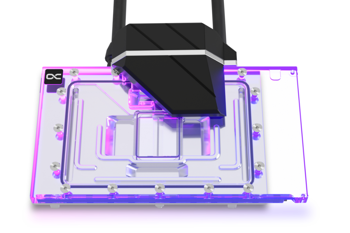

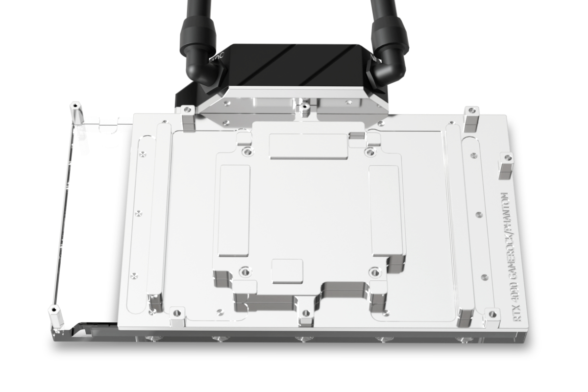

The Eiswolf 2 graphics card AIO water block not only cools the GPU with liquid but also all relevant components that require active cooling. This includes the graphics memory, the VRM and, if necessary, other components that require direct cooling. By using the Eisblock GPX Aurora water cooler, the cooling capacity is identical to that of a DIY graphics card water cooler.
Chrome-plated copper

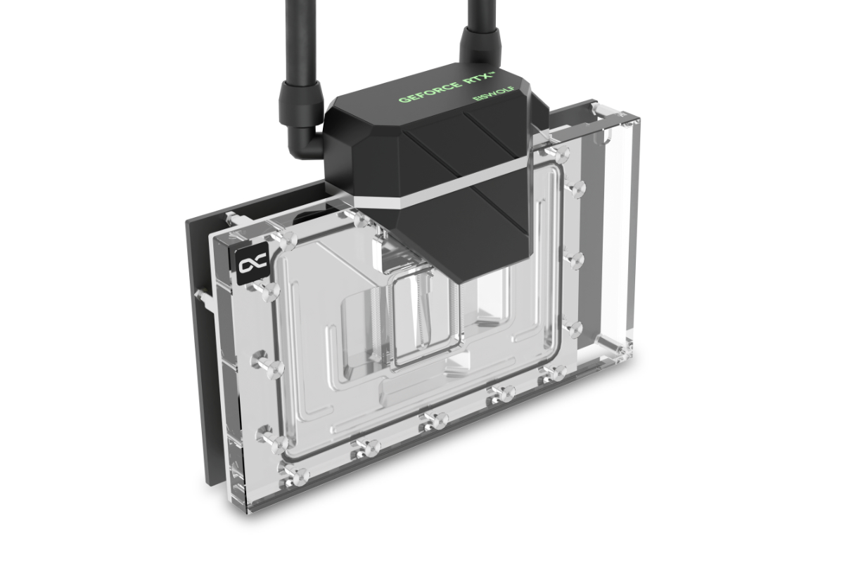

Pump
The Eiswolf 2 has a pump unit in place of the normal connection terminal. This pump unit houses the DC-LT 2 pump. An improved and quieter version of the well-known DC-LT Low Noise Ceramic Pump. Despite looking rather large, the pump unit is only 5 mm wider than a normal connection terminal.
Fittings and Tubing
As with all new AIO units, Alphacool uses only TPV hoses from the Enterprise Solution range for (usually reserved for servers and workstations) in the Eiswolf 2. The tubing is made of EPDM/PP and are extremely heat-resistant, durable, and free of plasticizers. All fittings are also based on the Enterprise Solution range and match the TPV hoses perfectly.
Expandability
By using the quick-release fastener, the Eiswolf 2 can be connected to another Alphacool AIO unit to achieve a larger loop in seconds. Alphacool offers various prefilled components with which the loop can be easily extended. For safety reasons, the quick-release fasteners are firmly screwed together and not just plugged together.
Lighting and fans
The Eiswolf 2 cooler has a digital RGB LED lighting, also called addressable RGB LEDs. They run along the entire back of the graphics card cooler and provide complete illumination of the water cooler. The pump unit is more discreet and offers a green glowing logo for Nvidia and a red glowing logo for AMD cards. The name "Eiswolf" on the pump unit remains unlit, discreetly in the background. The fan used is the Aurora Rise with 120mm. Due to the special blade design, the fan is extremely quiet and the addressable RGB LEDs provide brilliant illumination. The Alphacool Aurora Rise fan convinces with a max. static pressure of 3.17mm/H2O and offers a max. air flow of 119.8m3/h. The PWM control allows the fan to be controlled over a wide speed range. In addition, it offers a zero control. It can therefore be regulated down to 0 rpm and then starts with approx. 350 rpm.
NexXxoS Radiator
As with all AIO units, Alphacool uses radiators from the world renowned NexXxoS series. The full copper radiators offer a much higher cooling capacity than aluminium radiators and have contributed significantly to Alphacool's worldwide success.
The combination of all of the components results in a solution that is as simple as an AIO solution to install, but with the performance of a pre-assembled and prefilled custom loop.

Technical data radiator
Dimensions (L x W x H)395 x 124 x 30mm (+/- 3%)
Material cooling fins, chambers & channelsCopper
Material threadsBrass
G 1/4“ threads2 x for tubes (+ 1x Fillport G1/4“)
For fan size120 mm
Options for fan assembly3 x one-sided / 6 x both-sided
Technical data cooler and pump
Dimensions (L x W x H)214,91 x 154,79 x 47,62mm
Material cooler bottomChrome plated copper
Material cooler topacrylic
Threads2 x G1/4“
Pump typeDC-LT 2
Pump speed2600 rpm (+/- 10%)
Head of delivery1 m
Maximum flow rate72 L/h
Voltage6-13.5V DC
Power consumption3.2W
MTBF50.000 h
Technical data liquid
Colorclear
Ingredient 1Destilled water (CAS-number 7732-18-5)
Ingredient 2Glysantin (CAS-number 1017-21-1)
Working temperatures-15 C° / +90 °C
Technical data quick fasteners
L x D95 x 27mm
MaterialNylon
For tube size12,7 / 7,6mm
ColorBlack
Technical data fittings
L x D straight fitting24 x 18mm
Quantity straight fittings2x
L x B x H 90° fitting35 x 27 x 17mm
Quantity 90° fittings2x
Material fittingsBrass
Technical data tube
Length50cm
Material tubeTPV (EPDM/PP)
ColorMatt black
Tube size12,7 / 7,6mm
Hardness grade35 Shore-A to 50 Shore-D
Working temperature-50 to +155 °C
Technical data fan
Speed0 - 2500 RPM
Static pressure3,17 mm H2O
Air flow rate119,8 m³/h
BearingsSleeve bearing
Fan connector4-Pin PWM
Connection Digital aRGB3-Pin JST + 3-Pin 5V
Dimensions (L x W x H)120 x 120 x 25mm
Net weight187g
Max working temperature60°C
Technical details mehr
Radiator dimensions: 395 x 124 x 30mm
Radiator thickness: 29 - 39mm
Radiator size: 360mm
Hose dimensions: 12,7/7,6mm
Base: Nvidia GeForce;
