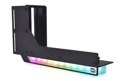

11951 Alphacool Aurora vertical GPU mount with riser cable
€79.98*
