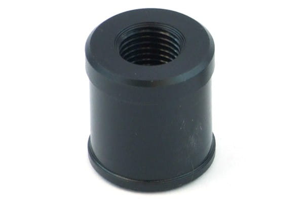

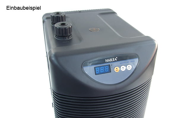

Special adapter for the ultra-flow coolers. The adapter is screwed onto the plastic nut at the... more
Special adapter for the ultra-flow coolers. The adapter is screwed onto the plastic nut at the top instead of the hose connection and seals using the seals supplied with the flow cooler.
Technical data:
Compatible with Hailea Ultra Titan 300 500 and 1500 flow chillers
Material: POM
Suitable for connections with G1/4 inch
Not compatible with Hailea Ultra Titan 2000
Two of these adapters are required for a flow cooler.

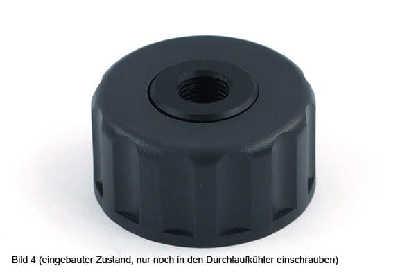

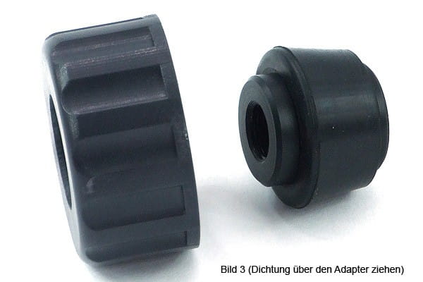

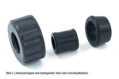

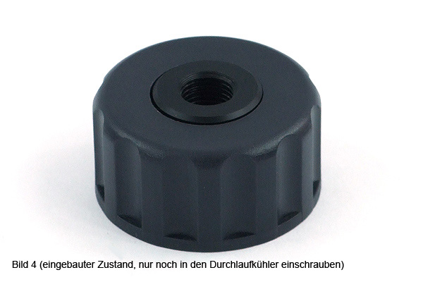

Installation instructions:
The adapter is mounted on the chiller instead of the thick standard connection. To do this, the seal must be removed from the standard connection and then reassembled with the adapter and the fastening screw as shown in the photos.
