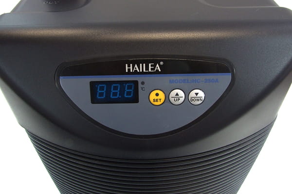

This flow cooler essentially replaces the radiator, as the water is regulated down to a temperature set by you. Temperatures of up to 4°C are possible, but please note that the temperature difference can cause condensation to form. The temperature can be set in individual steps up to 28°C via the display. Appropriate insulation accessories (for hose and CPU) are also available. Alternatively, the chiller can also be set to a value just below room temperature to avoid the problem of condensation.

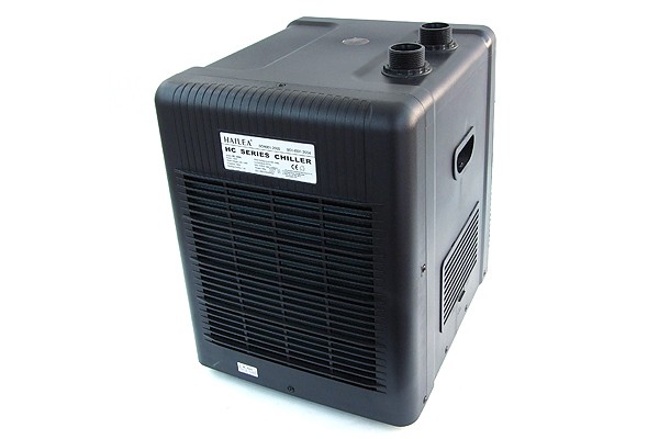

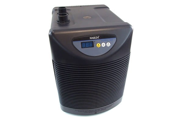

- Compressor power: 1/6 HP
- Mains voltage: 220-240V
- Cooling capacity: 265 watts
- Recommended water flow: 600-2200l/h
- Weight: 18Kg
- Refrigerant: R 134 A
- Dimensions: 448x330x440mm (LxWxH)

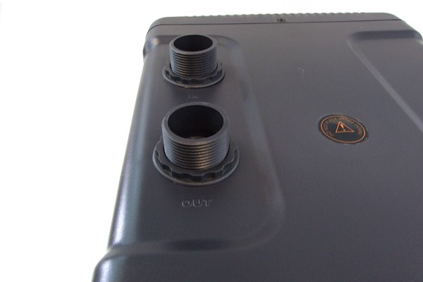

- Connection outer diameter: 18-20mm
- Heat exchanger: titanium
- Max. pressure load: 0.8 bar
- Temperature controller: Digital reading accuracy 0.1°C, setpoint adjustment in 1°C steps
- Current consumption: 1.3 A (50 Hz)
- Power consumption: 299 W

- 2x 45° angle with rubber seal

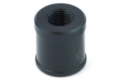

- 2x rubber seal with G1/4" internal thread
- 2x matching hose clamps
