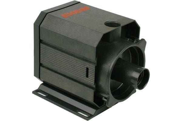

This high performance ceramics centrifugal pump is designed for uncompromising continuous use. It has an integrated pre-filter on the suction side to protect the pump mechanism. The base plate of the device is variable, which means there are numerous mounting options. The Eheim centrifugal pump 1048 is the ideal "motor" for your
Water cooling, it is compact, tried and tested, quiet and works very reliably. To mount universal hose connections,
use our Eheim adapters.

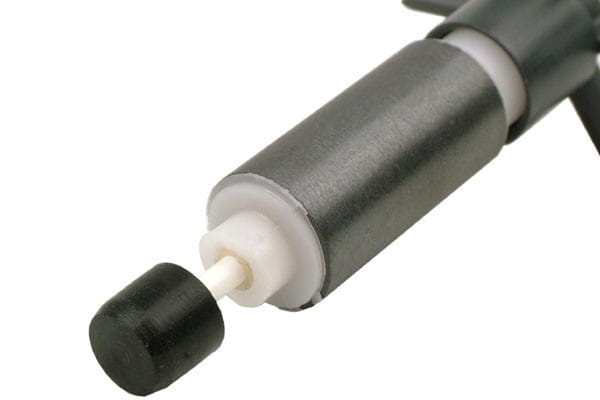

This variant of the Eheim pump is delivered as a fully ceramic version with a ceramic axle and ceramic bearings. This design ensures long-term smooth running.

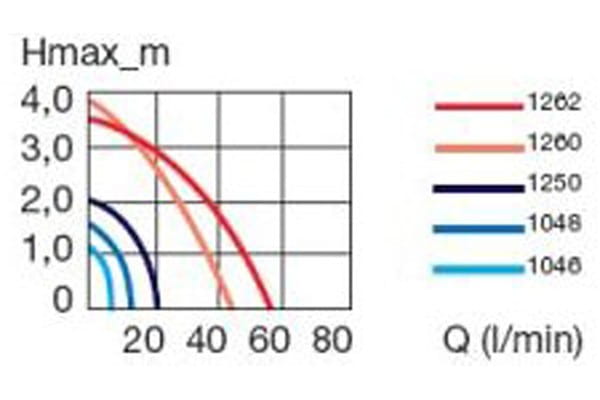

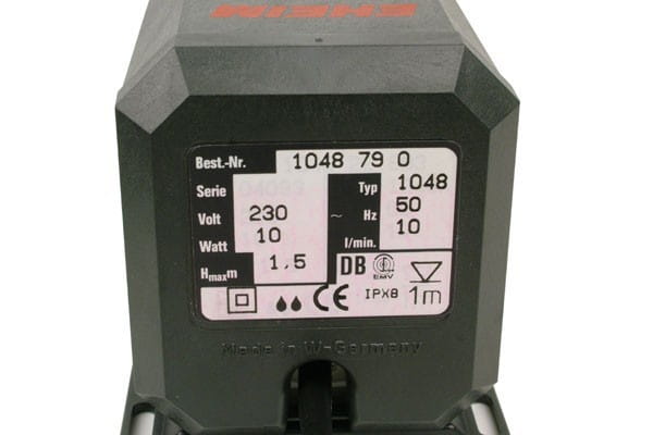

Pump capacity: 600 l/h
Discharge head: 1.50 m
Power consumption: 10 W
Dimensions L x W x H mm: 147 x 75 x 118
Ceramic axle and ceramic bearing
EHEIM No.: 1048-790

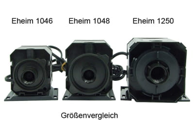

Attention! This pump is delivered without accessories as shown in the picture!
Important: The 1048 can make an unexpectedly loud noise, similar to a rattling noise. This is NOT A REASON FOR COMPLAINT as it is a design-related characteristic. Instead, we recommend carrying out the well-known Eheim MOD with Phobya thread sealing tape by sticking the Phobya thread sealing tape around the pump shaft to prevent the shaft from rattling.
Only buy the pump if you have previously informed yourself about the Eheim MOD .
