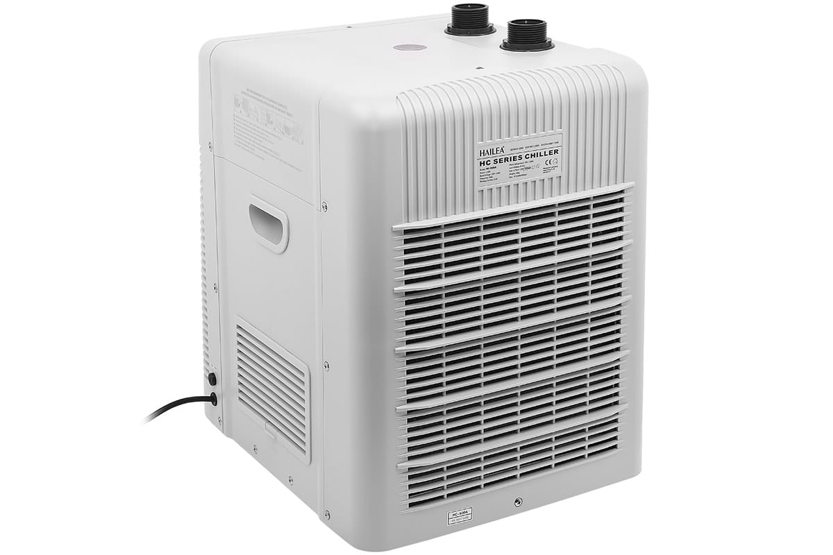

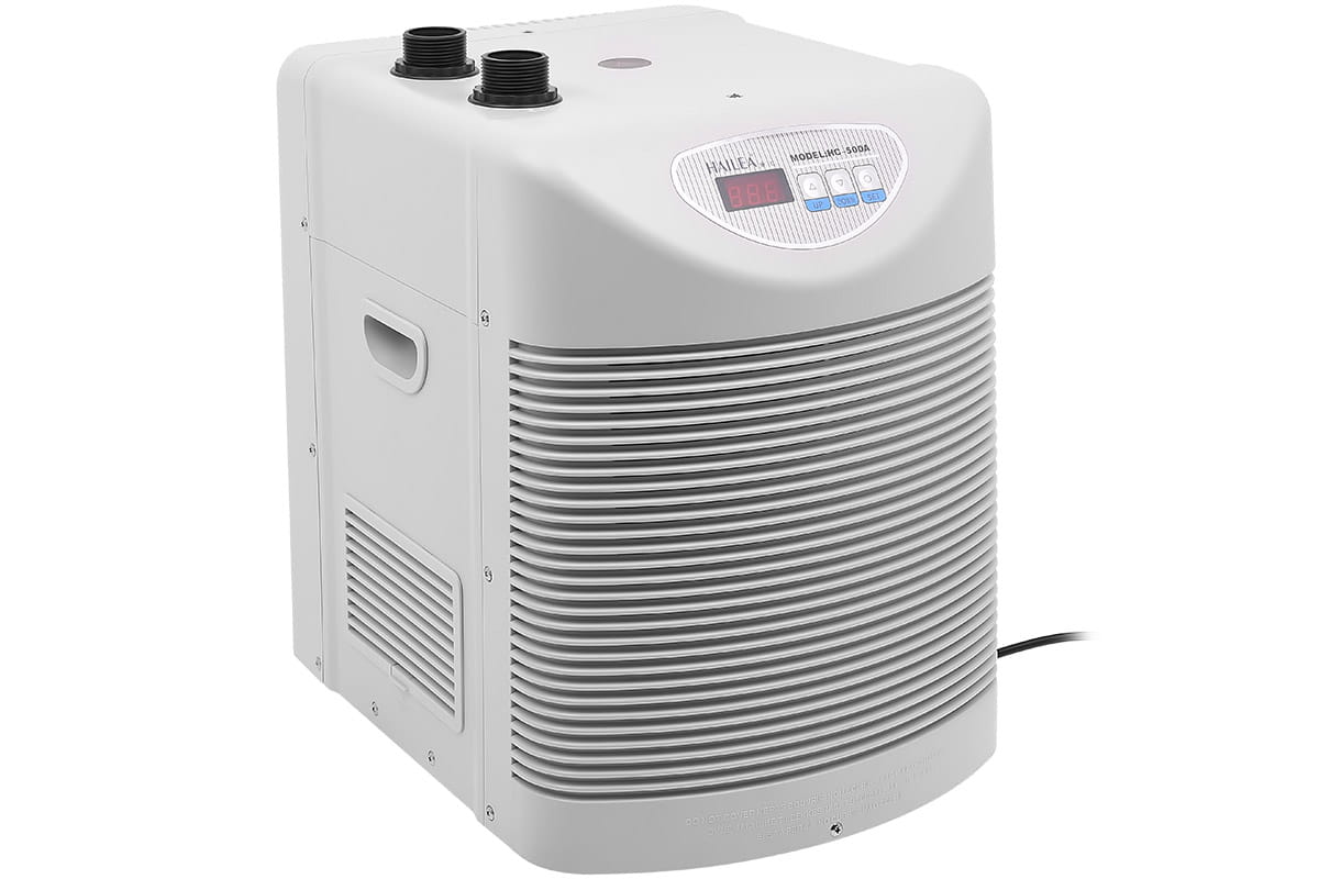

flow cooler Hailea Ultra Titan 1500 (HC500=790Watt cooling capacity) - White Special Edition

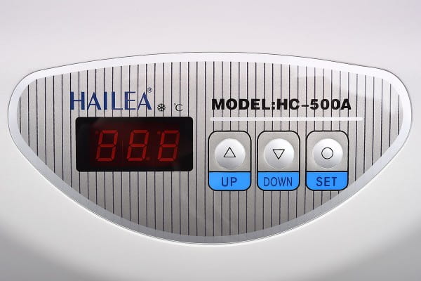

This flow cooler essentially replaces the radiator, as the water is regulated down to a temperature set by you. Temperatures of up to 4°C are possible, but please note that the temperature difference can cause condensation to form. The temperature can be set in individual steps up to 28°C via the display. Appropriate insulation accessories (for hose and CPU) are also available. Alternatively, the chiller can also be set to a value just below room temperature to avoid the problem of condensation.

- Compressor power: 1/2 HP
- Mains voltage: 220-240V
- Cooling capacity: 790 watts (suitable for extreme overclocking and extreme cooling)
- Recommended water flow: 1200-3000l/h
- Weight: 22Kg
- Refrigerant: R 134 A
- Dimensions: 475x360x490mm (LxWxH)
- Connection outer diameter: 20-22mm
- Heat exchanger: titanium
- Max. pressure load: 0.8 bar
- Temperature controller: Digital reading accuracy 0.1°C, setpoint adjustment in 1°C steps
- Current consumption: 2.4 A (50 Hz)
- Power consumption: 552 W
