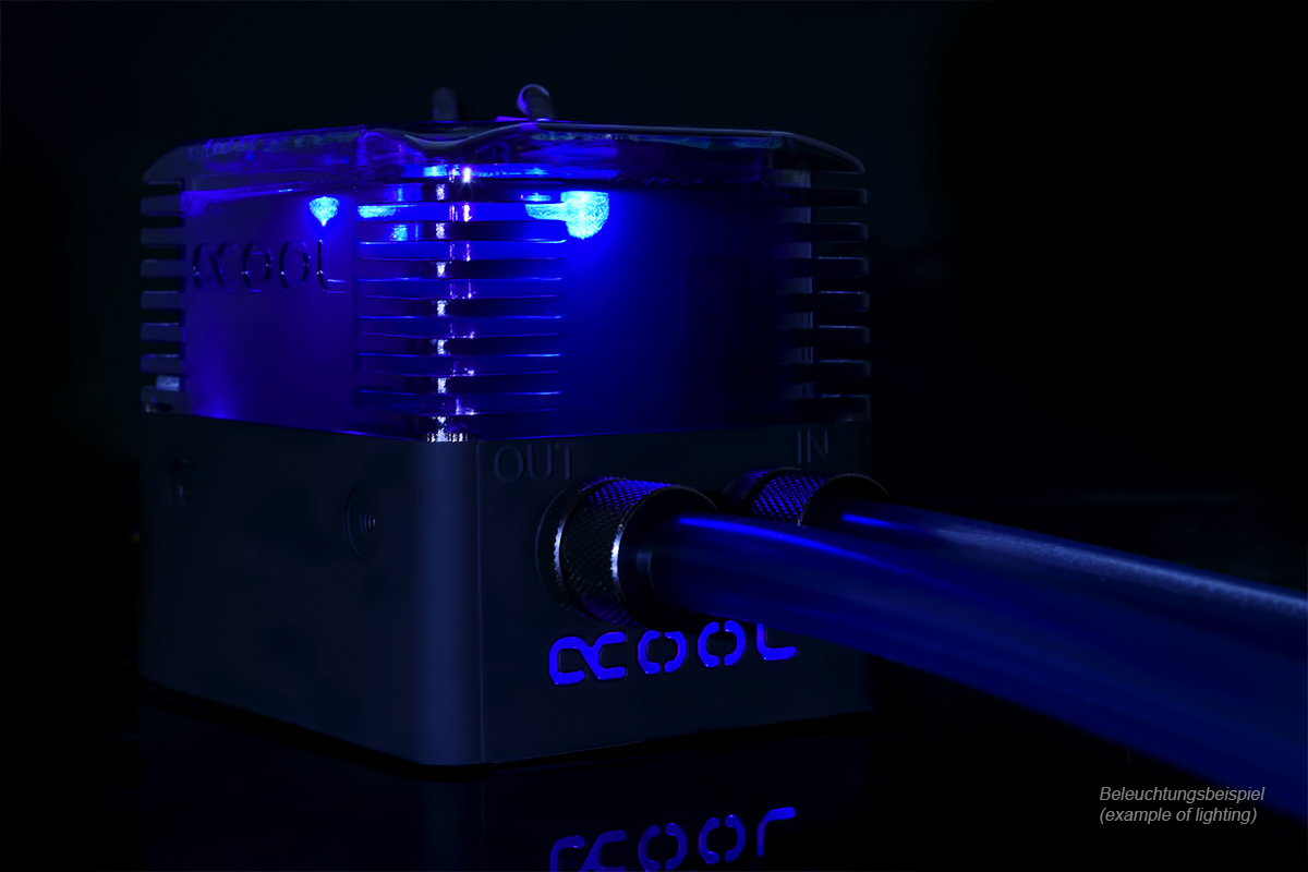

4. Illuminated logo and LED mounting options

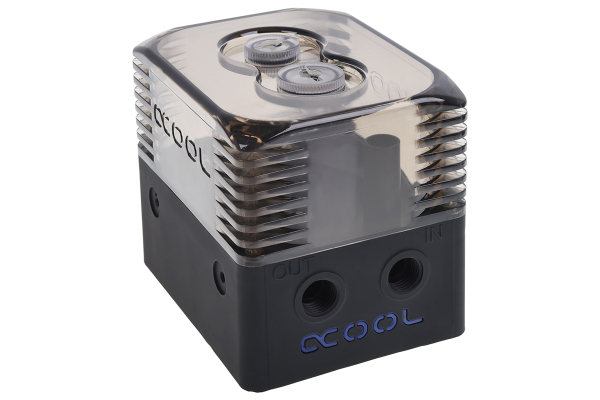

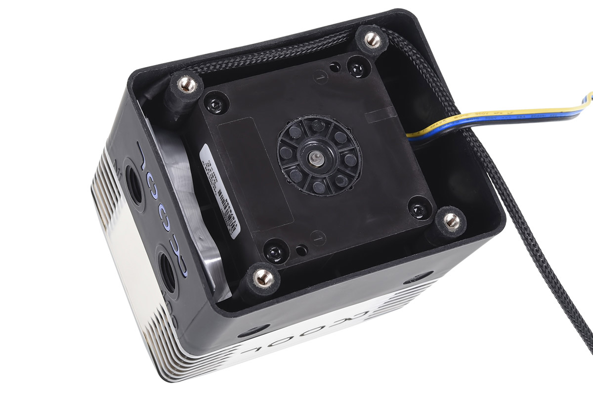

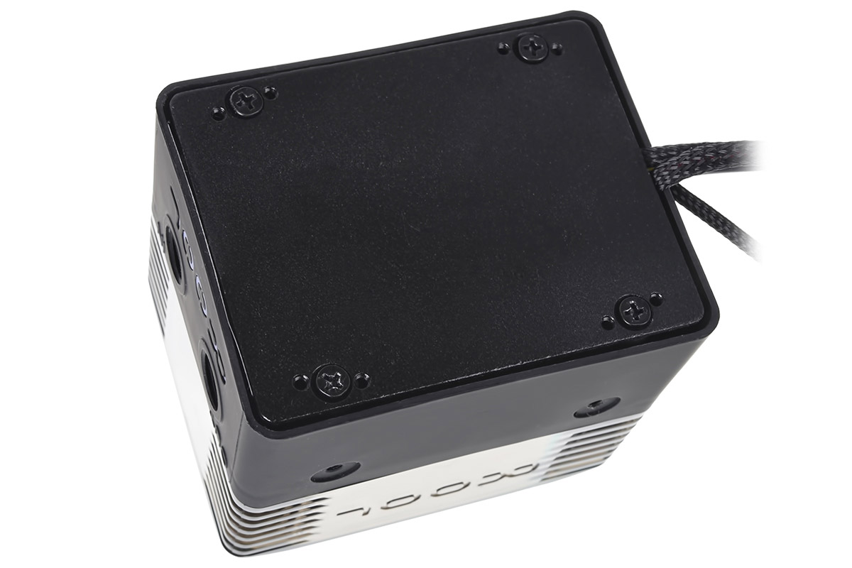

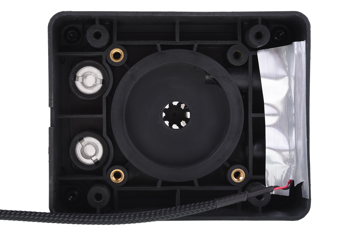

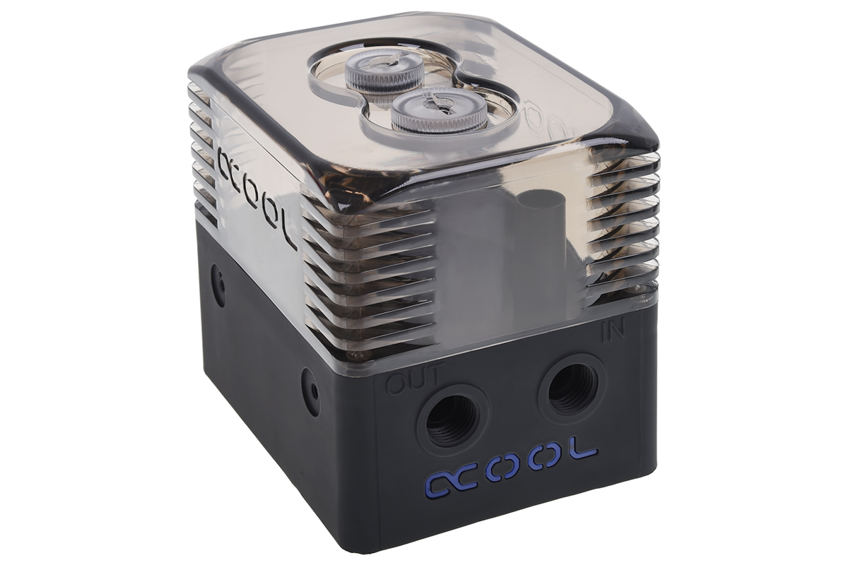

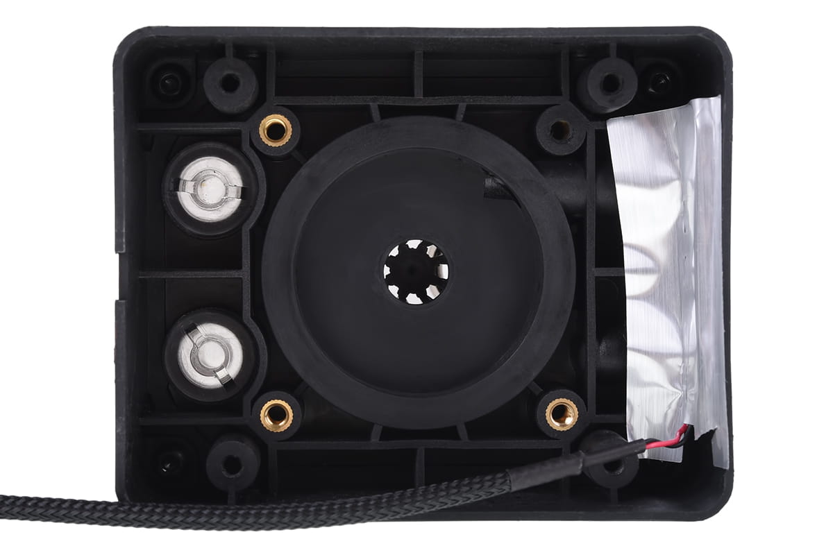

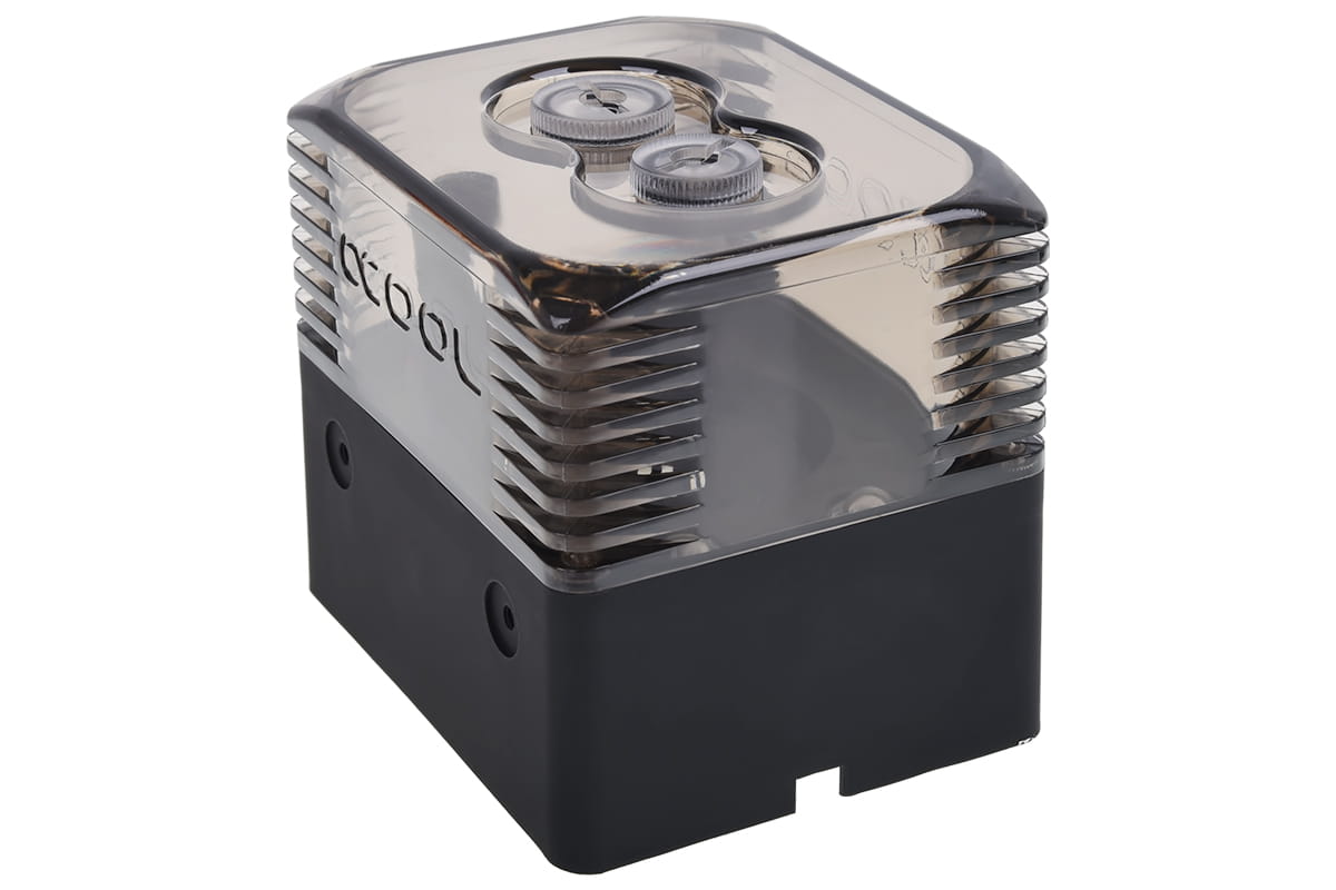

The Alphacool Eisstation expansion tank is extremely compact and is available in three versions, depending on the pump you want. A D5, a DDC and a version for the DC-LT pump are available. The pumps are installed in the base of the Eisstation and are not visible from the outside. The base of the Eisstation consists of a metal plate, which increases the stability of the Eisstation.

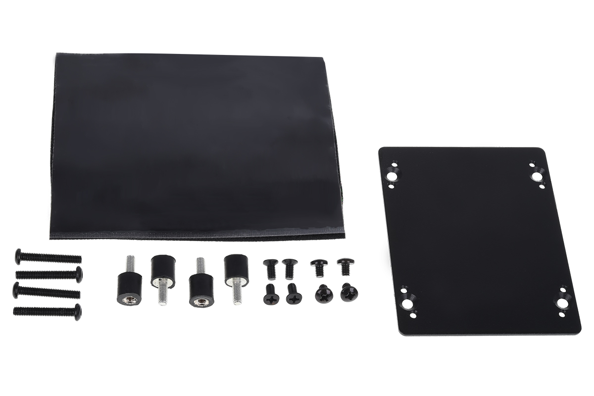

Mounting options
It is possible to screw the ice station onto a 2.5" mount for SSD hard drives. It can also be installed in a 5.25" slot. In both cases, the screw connection is made using the special decoupling screws provided. This minimizes the transmission of vibrations to the housing and overall operation is significantly quieter. Another mounting option is the included Velcro fastener. One part of the Velcro fastener is simply glued to the bottom of the ice station while the other part is glued into the housing. Then the ice station only needs to be pressed onto the counterpart in the housing with the bottom. The size of the Velcro fastener ensures a secure position even during transport. The installation can be done vertically or horizontally, depending on your needs and space.
Connection options

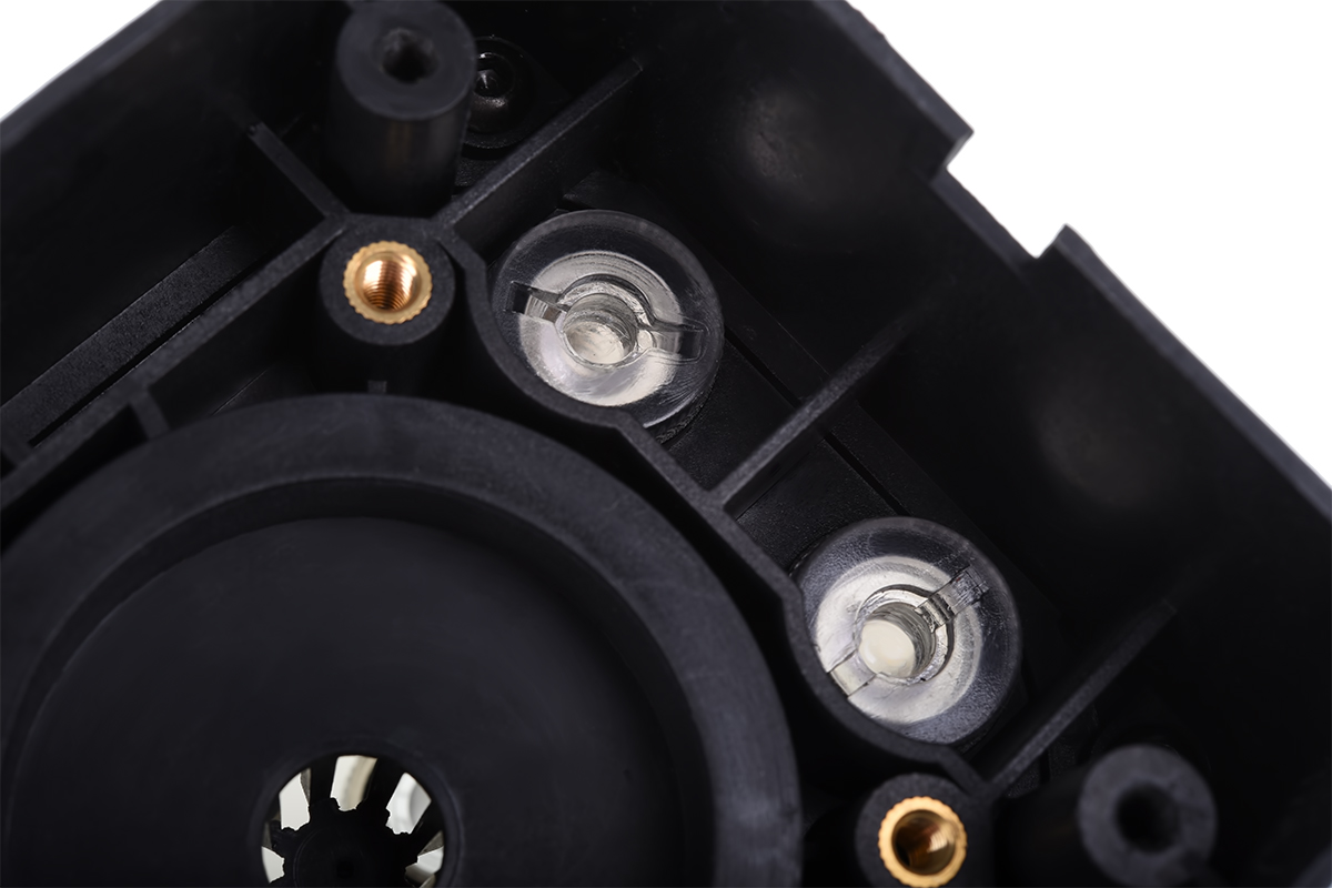

An IN and OUT with G1/4 thread can be found on the head side with the illuminated logo. A G1/4" and a G3/8" connection are available in the lid. The G3/8" connection makes filling the ice station easier due to its larger diameter and can alternatively be used as a lighting module for 5 mm LEDs. Two additional 5 mm LED spaces can also be found in the base and illuminate the part filled with water from below.
A special highlight is the choice of material for the ice station. The lower part is covered with a high-quality soft-touch surface, which gives it an outstanding feel and appearance. The upper part and the actual expansion tank is not made of simple and easily breakable acrylic glass, but of extremely stable nylon. While normal expansion tanks made of glass or acrylic glass can tear or break even if dropped from a small height or if handled improperly, it is almost impossible to destroy the transparent container of the ice station.
Technical data ice station
  • Dimensions (LxWxH): 102 x 82 x 105mm
  • Capacity: 250ml
  • Material: Nylon / PMMA
  • In / Out: G1/4"
  • Connection options: 3x G1/4"/ 1x G3/8"

Technical data DDC-1T pump
  • Dimensions: (WxDxH) 62x62x38mm (without connections)
  • Motor type: Electronically commutated spherical motor
  • Nominal voltage: 12 V DC
  • Permissible voltage range 6 to 13.2 volts
  • Discharge head at 12V: 3.7m
  • max. flow rate: 420L/h
  • Pumped media: water, water/glycol mixtures*
  • Max. system temperature: 60° C
  • Parts in contact with media: stainless steel 1.4571, PPS-GF40, EPDM O-rings,
  • Aluminium oxide, hard carbon
  • Connections: 2x 10/8mm hose connection (no nozzle required)
Scope of delivery
  • 1x Alphacool Eisstation DDC incl. Alphacool Laing DDC-1T
  • 1x metal floor
  • Mounting screws
  • 4x decoupling screws
  • Self-adhesive Velcro mat
