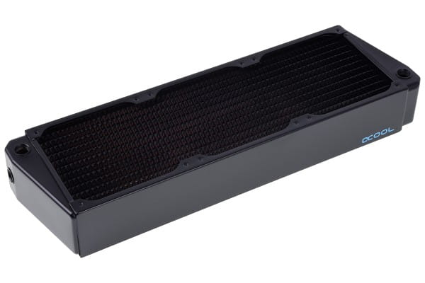

Following this tradition, the new NexXxos radiators are the first to truly deserve the “Full copper” attribute. All main parts, not only the fins and channels, but the chambers are also made from copper. This brings an improvement in performance where other radiators are left without a chance. In structure, the Alphacool NexXxoS X-Flow Radiators differentiate materially from the standard radiators. The X.Flow Radiators are designet for high flow rates. The bevelled copper chambers on both sides have an identical structure. This Water is jetting at the same time through all avialable channels to the other chamber to whitch it then leaves the radiator.

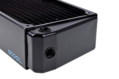

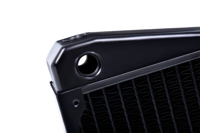

Versatile and easy mounting is one of the main points, on which the research and development department at Alphacool focused. The chamber offers three possibilities for fitting installation on both inlet and outlet (not on the NexXos ST30). Less angled fittings are needed, improving flow rates and offering more mounting possibilities.

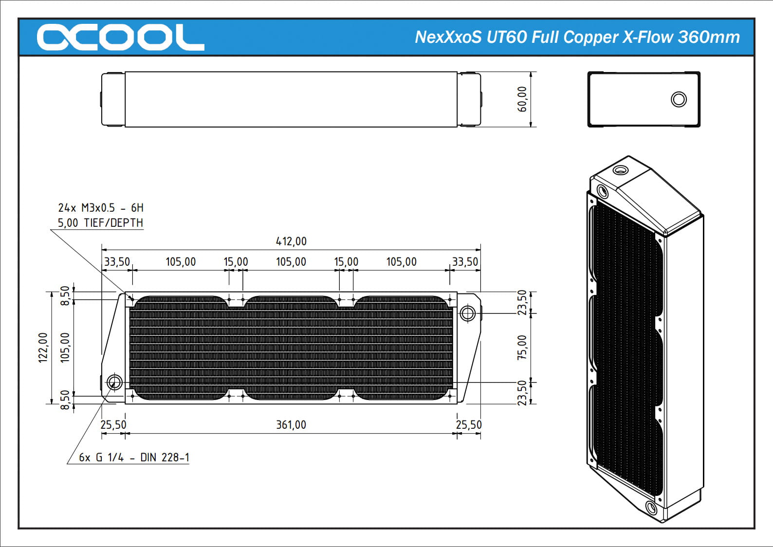

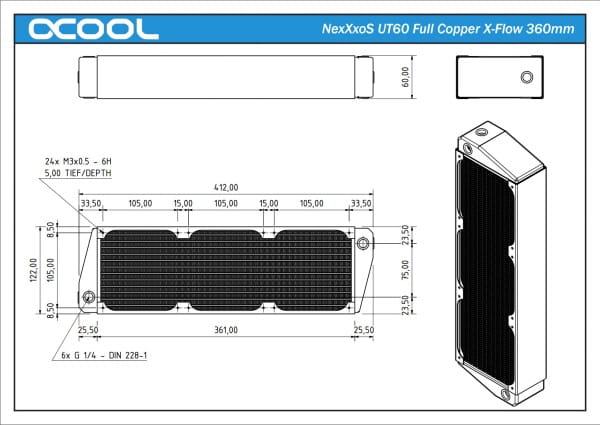

| Technical data | |
| Dimensions (L x W x H) | 413 x 124 x 60mm |
| Quantity of cooling channels | 36 |
| Thickness | 49 - 69mm |
| Cooling channels | Copper |
| Color | black |
| Fan thread | M3 |
| Connection | 6x G1/4" |
| Slats | Copper |
| Number of fans | 3 |
| Fan size | 120mm |
| Housing | Steel |
| Manufacturer | Alphacool |
| Fins per inch | 10 |
| Pressure tested | 0,8 bar |
