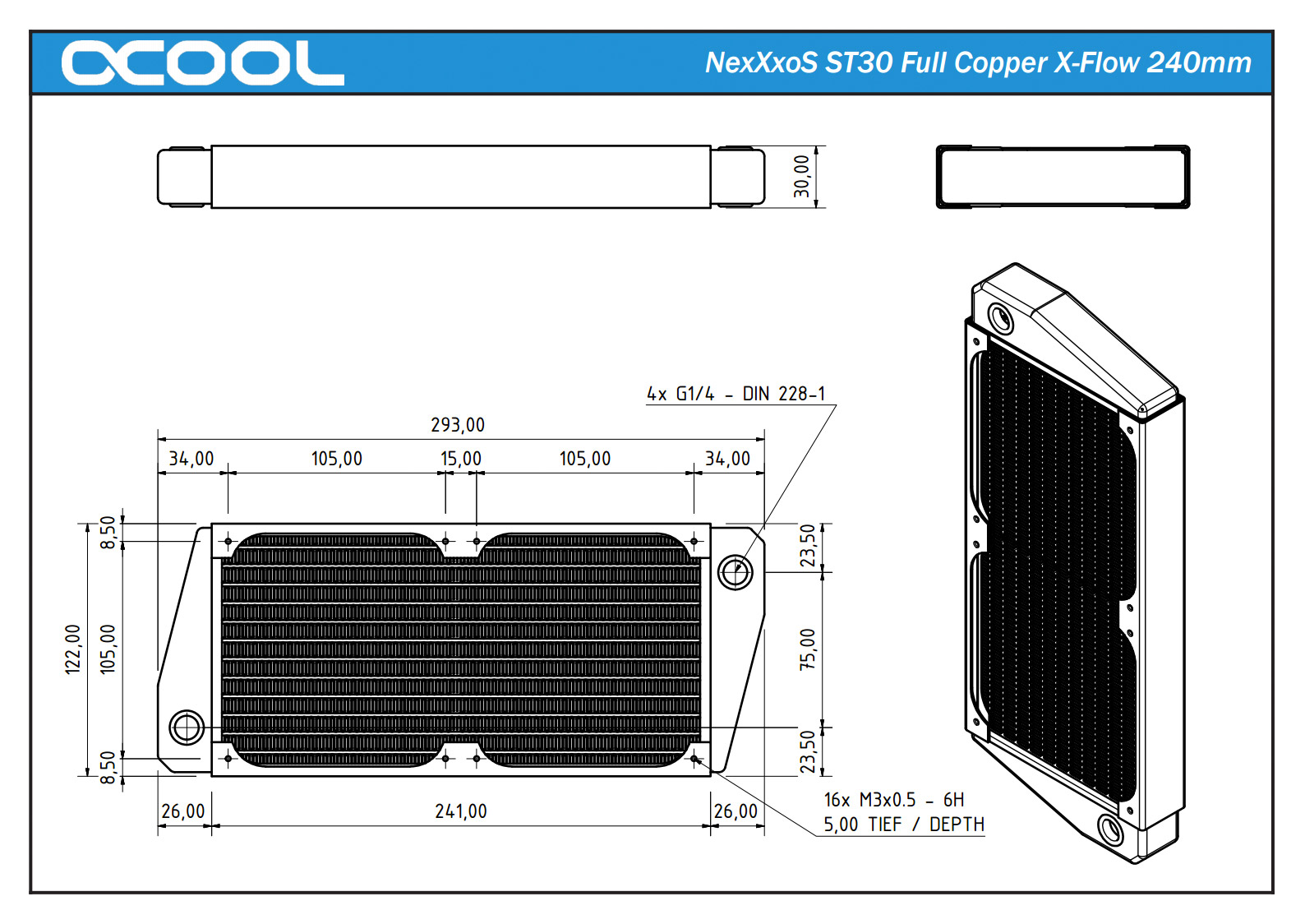

| Technical data | |
| Dimensions (L x W x H) | 293 x 124 x 30mm |
| Quantity of cooling channels | 12 |
| Cooling channels | Copper |
| Color | black |
| Connection | 4x G1/4" |
| Fan thread | M3 |
| Slats | Copper |
| Number of fans | 2 |
| Fan size | 120mm |
| Housing | Steel |
| Pressure tested | 0,8 bar |
| Manufacturer | Alphacool |
| Thickness | 29 - 39mm |
| Fins per inch | 16 |
