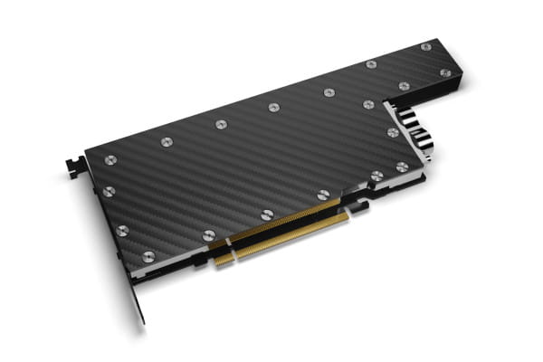

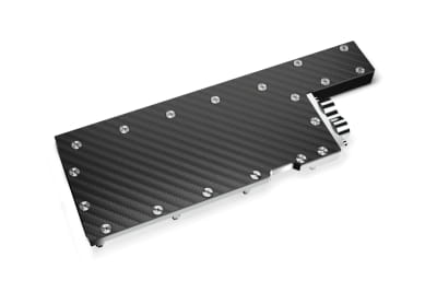

The Alphacool ES Copper/Carbon water cooler with backplate was developed for the Alphacool... more
The Alphacool ES Copper/Carbon water cooler with backplate was developed for the Alphacool Enterprise Series. Due to the positioning of the connections, the hosing of the cooler in the server rack is significantly simplified. The top of the cooler is made of carbon. This makes the water cooler lighter compared to Alphacool's Eisblocks with acetal or acrylic tops. Thanks to the compact design, only 1 slot is needed to mount the cooler in the server rack instead of 1.5 slots as before. This additional space saving is one more argument for using the ES Copper/Carbon graphics card water cooler.
More performance!

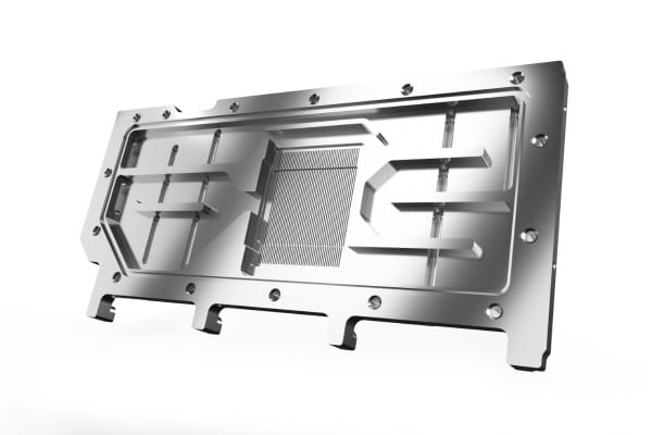

Alphacool manages to position the cooler as close as possible to the components to be cooled. For this purpose, the heat conducting pads used are reduced to a thickness of 1mm. The maximum possible reduction in the thickness of the copper block and the optimization of the water flow inside the cooler allow all important components such as GPU, voltage converters and VRAMs to be cooled by water much better and more effectively. All of this provides a significant increase in cooling performance.
Chrome-plated copper

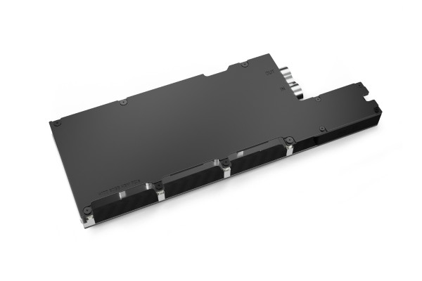

Connections on the back?
In order to save space in the width and height during installation, the water input and output have been moved to the back of the cooling block. This positioning of the connections makes hosing much easier. It enables easy integration of the GPU cooler into the water circuit even in the tightest server housings.
Copper or aluminum?
Alphacool uses only copper for all water-bearing parts. Copper has almost twice the thermal conductivity of aluminum and is therefore clearly the better choice of material for water cooling. The chrome-plated copper base is highly resistant to acid, which means that chipping of the chrome plating can be ruled out.
Thermal paste & thermal pads
The included thermal paste is Alphacool's Apex with a thermal conductivity of 17 W/mK. The electrically non-conductive thermal paste is particularly well suited for high contact pressures. For the thermal pads, Alphacool uses soft pads that fit perfectly to the components to be cooled and are very durable. The 3mm thick pad have a thermal conductivity of 3 W/mK. The 1mm thick pads can dissipate 7 W/mK of heat.
Discreet appearance
The matte carbon finish gives the cooler a noble appearance. This makes it additionally interesting for private users who want to do without aRGB lighting.
- Nvidia H100 80GB PCIe 5.0
Dimensions (L x W x H)261,89 x 95,71 x 19,40mm
Slot size1
Material coolerChome-plated copper
Material cooler topCarbon
Threads2 x G1/4"
Pressure tested4 Bar
Colorblack, carbon

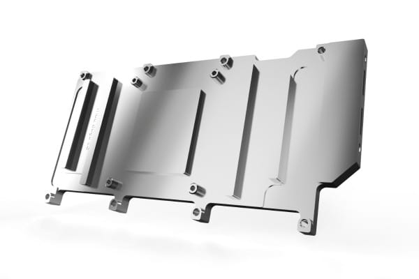

Technical data backplate
Dimensions (L x W x H)261,89 x 95,71 x 4,00 mm
MaterialAluminium
