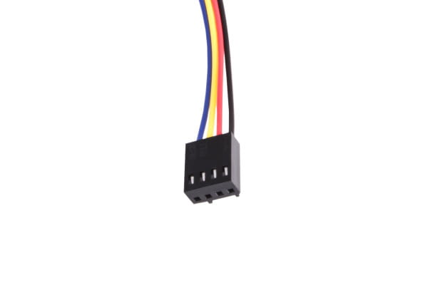

The Alphacool ES fans have been specially developed for use in servers and workstations and, unlike usual, do not offer a 2 or 3-pin DC power connection, but a 4-pin PWM control.
PWM control
Instead of the usual 2 cables or the 3-pin connector Alphacool now also uses a 4-pin PWM connector for enterprise fans, which is supported by more and more server mainboards. Via the 4-pin PWM connector, the fan always receives full voltage and is controlled by pulse width modulation. This allows the fan to be controlled over a much wider speed range. A considerable amount of energy can be saved whilst controlling the fans in server racks and with 0% PWM control, the fans can even be stopped completely. The fan also offers a soft start, which increases the service life of the fan and reduces the risk of injury. At speeds of several thousand revolutions per minute, no parts of the body should get between the fan blades.

Integrated functionsFG tachometer output, Automatic restart, Soft start, PWM speed control

Main materials and connection (connector)2510-4P
