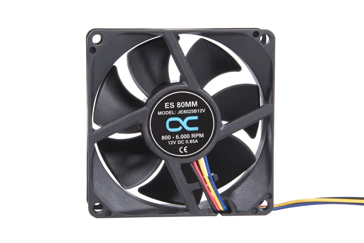

The Alphacool ES fans have been specially developed for use in servers and workstations and,... more

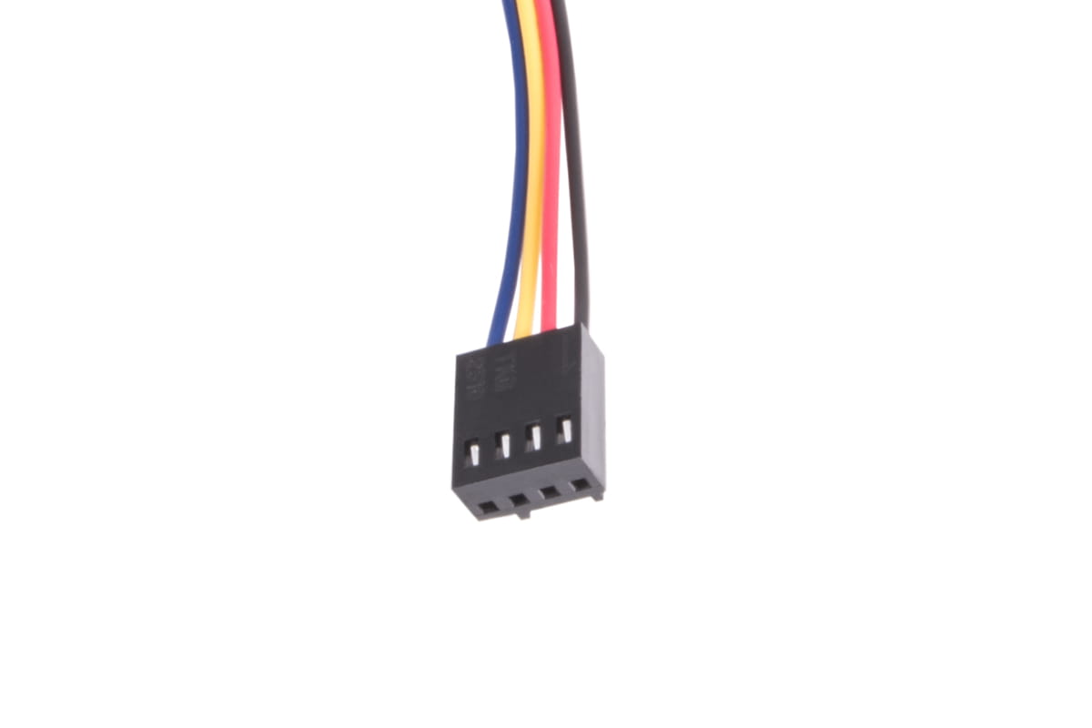

The Alphacool ES fans have been specially developed for use in servers and workstations and, unlike usual, do not offer a 2 or 3-pin DC power connection, but a 4-pin PWM control.
PWM control
Instead of the usual 2 cables or the 3-pin connector Alphacool now also uses a 4-pin PWM connector for enterprise fans, which is supported by more and more server mainboards. Via the 4-pin PWM connector, the fan always receives full voltage and is controlled by pulse width modulation. This allows the fan to be controlled over a much wider speed range. A considerable amount of energy can be saved whilst controlling the fans in server racks and with 0% PWM control, the fans can even be stopped completely. The fan also offers a soft start, which increases the service life of the fan and reduces the risk of injury. At speeds of several thousand revolutions per minute, no parts of the body should get between the fan blades.

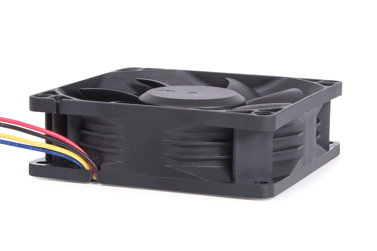

Double ball bearings
Unlike classic plain bearing, Alphacool ES fans have a double ball bearing for increased service life under full load. Double ball bearings are generally regarded as the highest quality bearings in terms of durability and quality. This also ensures a high level of running smoothness in terms of minimal vibration.
Protection circuits
All Alphacool Enterprise fans have multiple protection circuits. If the fans are blocked, they automatically try to restart at reduced speed after a few seconds. Thanks to the soft start, including the emergency start function, the fan can be blocked for up to 72 hours without suffering damage. In case of wrong polarity when connecting the fan, a burn-out of the electronics for at least 5 seconds is impossible. If the fan is connected incorrectly for a short time, this is no problem.

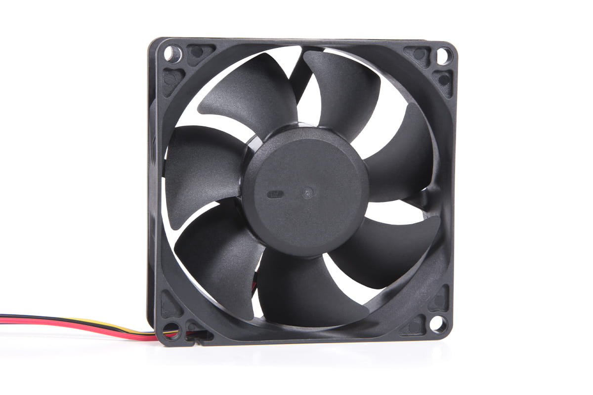

The Alphacool ES fans for servers and workstations offer an extremely high air flow and an extremely high static pressure. They are therefore ideal for use on radiators or as particularly powerful case fans.
Dimensions (L x W x H)80 x 80 x 25mm
Speed800-6000rpm
BearingTwo ball bearing
Connection4-Pin PWM
Cable length30cm
Operation voltage7 - 14V
Start voltage min.7V
Power consumption0,66 - 0,85A (7,92 - 10,2W)
Static pressure14,29 mm H2O
Max. air flow130,83 m³/h
Noise50 dB(A)
MTBF70.000h
colorblack
Security features
Automatic ShutdownAutomatic switch-off if the fan is blocked
Automatic restartingRestart attempt after 2-6 seconds if blocked
Damage due to blockingIt is guaranteed that the fan will not be damaged if it is blocked for up to 72 hour
