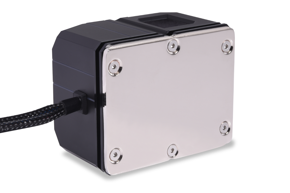

The Eisbaer Pro ES 2U 80mm Quad HPE AIO water cooling solution features an extremely powerful... more
The Eisbaer Pro ES 2U 80mm Quad HPE AIO water cooling solution features an extremely powerful NexXxos 80mm Quad full copper radiator, equipped with high-throughput 80mm ES fans. All components used come from the Enterprise Solutions water cooling segment. Alphacool's Eisbaer Pro ES 2U 80mm Quad HPE AIO is a professional all-in-one water cooling solution that is easy to install and offers the performance of a pre-assembled and pre-filled custom loop.
Powerful Full Copper Radiator
The 80mm NexXxoS radiators are specifically designed for server racks and workstations. The copper cooling fins are extremely thinly coated compared to most other manufacturers. This ensures that the cooling performance is not reduced, as a thick coating acts as insulation. The fin spacing is also optimally chosen with 10 FPI. The fins are close enough together to provide enough cooling surface area, but far enough apart to not hinder the airflow. Additionally, all cooling fins are equipped with flaps to provide controlled air turbulence, allowing the flowing air to better absorb and transport heat away from the fins.
Optimal Cooling
The cooler base covers the entire surface area of the respective processors. The surface area with cooling fins is larger that of all known processor DIEs, with a size of around 55 x 42mm. This ensures that all hotspots of a CPU are optimally cooled. The cooling fins are 0.4mm thick and also have an optimal spacing of 0.4mm from each other. There are a total of 58 cooling fins on the cooler base. The cooler base is only 3mm thick, allowing the heat to quickly reach the water and be removed.
Reliable Pump
The Eisbaer Pro ES cooler uses the very compact and small DC-LT 2 pump. It provides enough power to include additional components such as GPU water blocks or radiators in the water loop.
High-Quality TPV Tubes
The hose connections come from the normal DIY segment and use a G1/4" thread. Therefore, they can be easily replaced. The TPV hose is free of plasticizers and does not deform, unlike traditional PVC hoses, even at high temperatures.
With the Alphacool LGA 4677 Mounting Bracket (article no.: 13764), this cooler is also compatible with the Intel socket LGA 4677.
Attention: This set is not compatible with servers in the 1U and 2U form factor.
Intel: LGA 1700 / LGA 1851 / LGA 2011 / LGA 2011-3 / LGA 3647 / LGA 4189 / LGA 4677 (optional) / LGA 4710 (optional)
Technical data cooler with pump
Dimensions (L x W x H)64 x 79 x 54,3mm
Tube length75cm
Material cooler bottomnickel plated copper
Material cooler topAcryl
Threads2x G1/4“ (+ 1x Fillport G1/4“)
Pump typeDC-LT2
Pump speed2600 rpm (+/- 10%)
Head of delivery1m
Maximum flow72 L/h
Voltage6-13,5V DC
Power consumption3,2W
Pressure tested0,8 Bar
