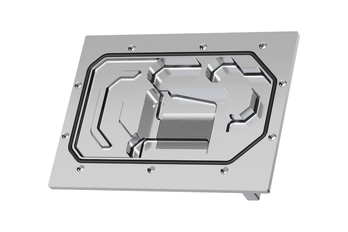

Engineered specifically for Intel Arc Pro B60 ASRock Creator graphics cards, this GPU water block is precisely matched to the card’s PCB layout. It combines technical refinement and optimized coolant flow with a sleek, minimalist design.
Technical Highlights
The fin structure is based on the proven cooling technology of previous Eisblock generations and has been specifically adapted to meet the demands of the Arc B60 GPU. With a thickness of 0.4 mm and a fin spacing of 0.4 mm, it ensures excellent coolant flow while delivering strong thermal performance.
The jet plate features an integrated inlay that helps distribute water pressure more evenly across the fins, improving heat absorption. The refined inlet design further enhances the angle and direction of the coolant flow for maximum efficiency.

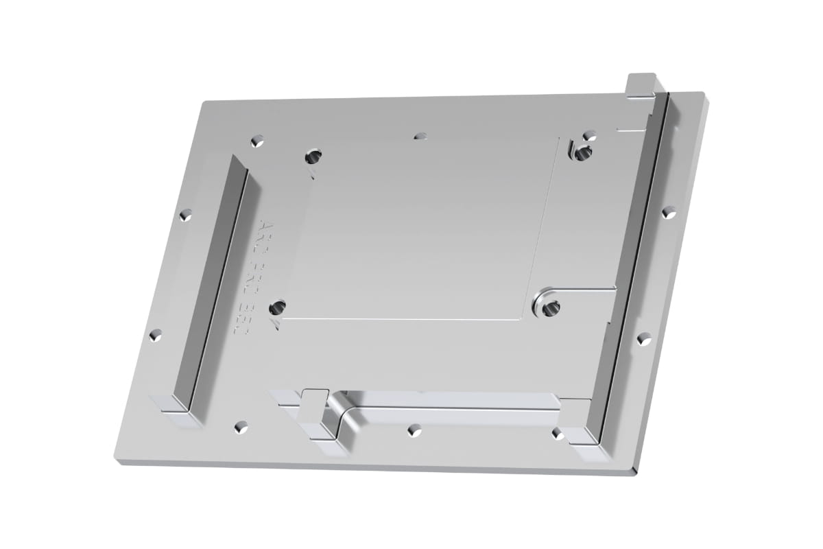

Chromed Copper
The block is made entirely of chromed copper. Compared to nickel plating, chrome offers a harder, more durable surface that is more resistant to scratches and chemical influences. Alphacool uses only copper for the cooling plate due to its nearly twice-as-high thermal conductivity compared to aluminum.

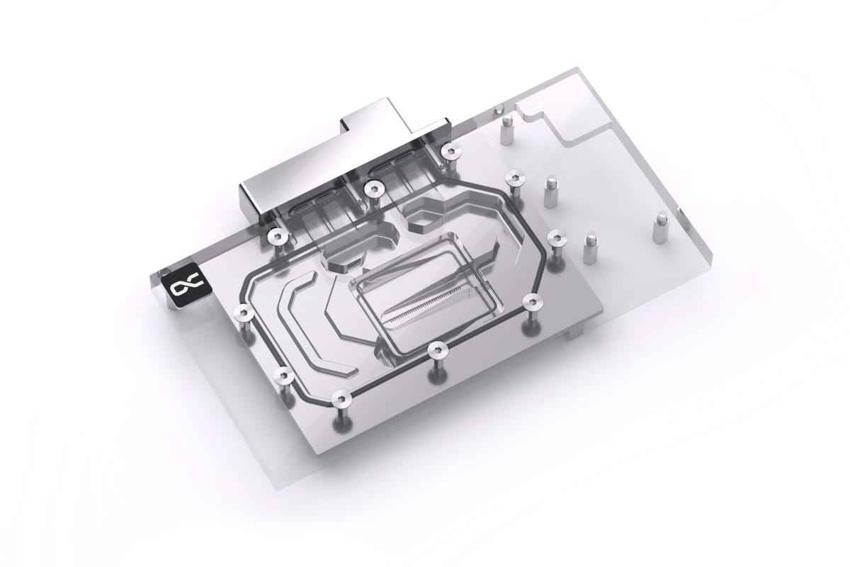

90° Terminal
The Alphacool Eisblock Arc Pro B60 Creator is equipped with a 90° terminal. Thanks to the practical arrangement of the inlets and outlets, the cooler can be installed particularly easily in server chassis and workstation PCs. The terminal is made of chrome-plated brass, providing high resistance to scratches and chemical influences.

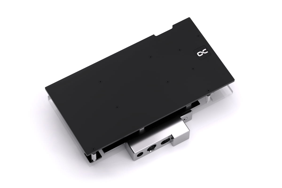

Technical data Backplate
Dimensions (L x W x H)185,76 x 96,15 x 3,00
MaterialAluminium (AlMg0,7Si)
ColorBlack
