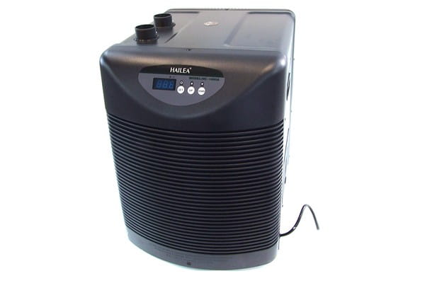

The cooling units from Hailea have been used in trusted waterchillers from other manufacturers... more
The cooling units from Hailea have been used in trusted waterchillers from other manufacturers for over 15 years. The new heat exchangers of the Ultra series are made from titanium. Therefore the chillers are perfect for watercooling systems. Another positive aspect about the Hailea units is the low noise emission. The pricing of the new series is also pleasantly affordable.
New revision:
  • New cool design
  • More robust materials for even longer lifespan
  • Lowered noise emissions
  • Suitable for continuous operation
Noise emissions:
The small chillers (like HC150) have a noise emission of  20dB(A) only and can be used near the computer / aquarium without disturbing.
Bigger models (like HC500) should be additionally decoupled to reduce the noise level if necessary
The models HC1000 und HC 2000 should be extra decoupled or maintained in a seperate room.
This waterchiller basically replaces the radiator as the coolant is chilled to the desired temperature by this unit. Temperatures down to 4°C are possible, please note that at low temperatures (high temperature difference) condensate may accumulate. Suitable insulation accessories are also available in our shop. Alternatively the coolant temperature can be set to just below room temperature to avoid this problem.
Thanks to the low temperatures incredible overclocking potential is available! The lifespan of the components is extended by multiples. This system is also great for no-noise applications as the chiller can be located in another room.
We recommend integration of the chiller into the cooling loop in combination with a radiator. This allows use of the chiller when required (overclocking, Benchmarks, summer etc..) and use of the radiator during normal operation.
To estimate the required cooling performance here some non-binding estimates. The exact thermal emissions can be requested from the manufacturer of the hardware.
CPU: 80W (standard) to 150W (overclocked)
GPU: 50W (small cards) to 250W (GTX 980)
MB: 20 to 40W per component
The added values of your system must not exceed the given cooling capability of the chiller.
What aquarium size can be cooled with my water chiller?
The manufacturer provides the following data:
Model / aquarium size in liters:
HC-130 / 50-100L
HC-150 / 50-200L
HC-250 / 100-300L
HC-300 / 100-400L
HC-500 / 200-800L
HC-1000 / 300-1000L
HC-2000 / 400-1500L
We at Aquatuning wish to advise you that the manufacturer’s data was obtained under optimal circumstances. The temperature response of the aquarium may greatly vary because of insulation, heat from lights respectively sunlight. Hence we recommend using the  larger model when reaching the upper limit of the aquarium size values.
Note regarding shipping:
This unit can only be shipped via a forwarding company. As the chipping charges differ by distance an online calculation is not possible. Please provide your full telephone number and E-Mail address when ordering, we will contact you after the order is complete. The shipping charge is approximately 50€ within Germany.
Technical specifications:
  • Power: 1 HP
  • Power consumption: 550W
  • Cooling capacity: 1650W (suitable for extreme OC and cooling)
  • Recommended coolant flow: 2000-4000 l/h
  • Weight: 31,5kg
  • Cooling agent: R134A
  • Dimensions: 400x500x440mm (LxWxH)
  • Connector outside diameter: 23-27mm
  • Heat exchanger material: Titanium
  • max. compressive load: 0,8bar
  • Temperature adjustments: Digital read-out (precision 0,1°C), temperature setting in 1°C steps
  • current demand: 3.2 A (50 Hz)
  • current drain: 736 W
Scope of Delivery:
  • 1x Waterchiller Hailea Ultra 2000
  • 2x 90° angle with rubber seal
  • 2x straight with rubber seal
  • 2x suitable hose clamps
Note for first-time users:
If you should have problems with your chiller please contact us before returning the chiller to us. In most cases there is no actual problem with the chiller, but the functionality of the unit is not fully understood by the user yet.
Please note the following: The compressor unit automatically switches itself on and off, if the temperature sensor is manipulated your warranty is void, the noise level or an allegedly not sufficient cooling performance are no reason for a reclamation. The chiller can only function properly if the cooling loop is equipped with a sufficiently powerful pump. If these facts are considered most reclamations can be avoided and you will greatly enjoy this product!
Note for aquarium-use:
The cooling performance is affected by the aquarium-lamp the reduced pump power due to filters and the thermal waste of the pump. We therefore recommend to order the ciller at least on power-lever higher that theoretically calculated
